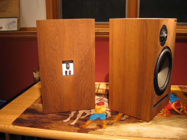

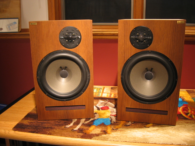

I had a pair of speaker cabinets made by an expert that builds cabinets for the University of Minnesota. These cabinets are MDF with teak veneer on both the outside and the inside. The veneer on both sides brings stability to MDF. The speaker pair (FYI) are Dynaco A25XLs made in mirror image, eliminating the lip on the outside of the cabinet, inverting the vent (to hide the ugly screen) and even veneering the back so they can sit out in the middle of a room if need be.
