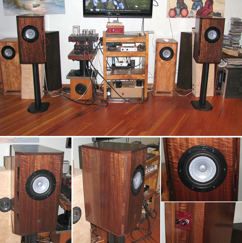

Smaller enclosures will be less likely to have issues.
But big is doable. The wood in these was the floor in Bernie’s house for 70 years,

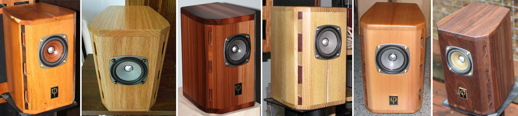

Some more examples:
These in the sme fir as the big ones with some dark maple as the bit that shrunk the driver cutout. Just the boxes on top.
Mahogany?
FHXL (and stand) in Mahogany:
Yellow Cedar (the smaller speakers in front):
But if you want to have pretty, really solid (probably better than any solid), and without the issue sof solid, stranded/fossilized bamboo plywood. These are a bit garish in Neopolitan, but there are other “flavours”
