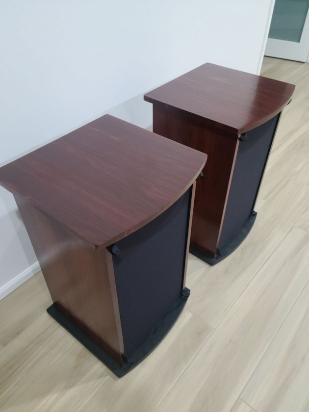

Thought I'd post my build of two dual OB subs in H frame forward configuration - single ended RCA.  I thought I'd also add some additional information to reflect the information I was looking for prior to and during my build.

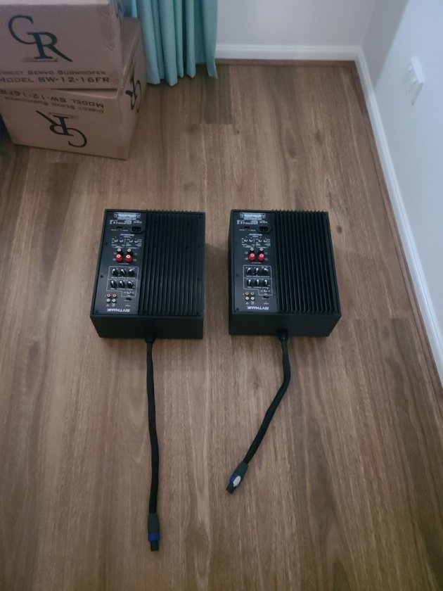

One item I had wanted to know more about was the plate amp box - so here's a photo:
Yes - it has a base
No - it doesn't have a hole for a cable entry

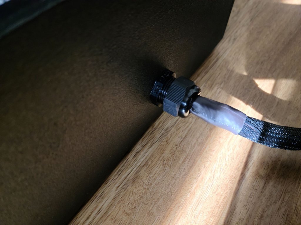

So, I'd read on the forums that the length of cable on the plate amp should not be extended.  I seem to recall Hobbs saying somewhere that he would usually just cut off of the supplied spade connectors on the plate amp wires and terminate into whatever connector you wanted to use.  In my case, I had ordered the Neutrik plugs with the kit.
I've seen photos on the forums of the female end being mounted on the plate amp box and also with it mounted on the subs themselves.  I decided to mount the female end on the subs and attached the male end to the plate amp wires.
Of course, this presents the problem of how to securely pass the wires through the side of the plate amp box, provide strain relief and make things look 'pretty'.
I separated the plate amp wires into BIG (driver) and SMALL (servo), twisted them around each other then twisted the two bundles together.  I then sleeved the cables in 20mm black heat shrink.  I then' over sleeved' them in braided mesh and fitted another short sleeve of heat shrink over the 'ragged' braided mesh.
Once I had the cable bundle size, I got hold of some black PVC cable glands which would provide a snug fit on the bundle (20mm in my case), drilled some holes of the right diameter in the plate amp box and put everything together.
Great .... except the wall thickness of the box is too thick for the interior thread width of the PVC gland.  I ended up gluing these in place with polyurethane glue, but I'd be interested in knowing what everyone else has done.  I don't seem to be able to readily get hold of thick wall PVC glands here in Australia - certainly, Bunnings don't carry them as stock.
Here's a photo of what I ended up with.  I think it looks great and provides a strong, secure grip on the cable to the sub.

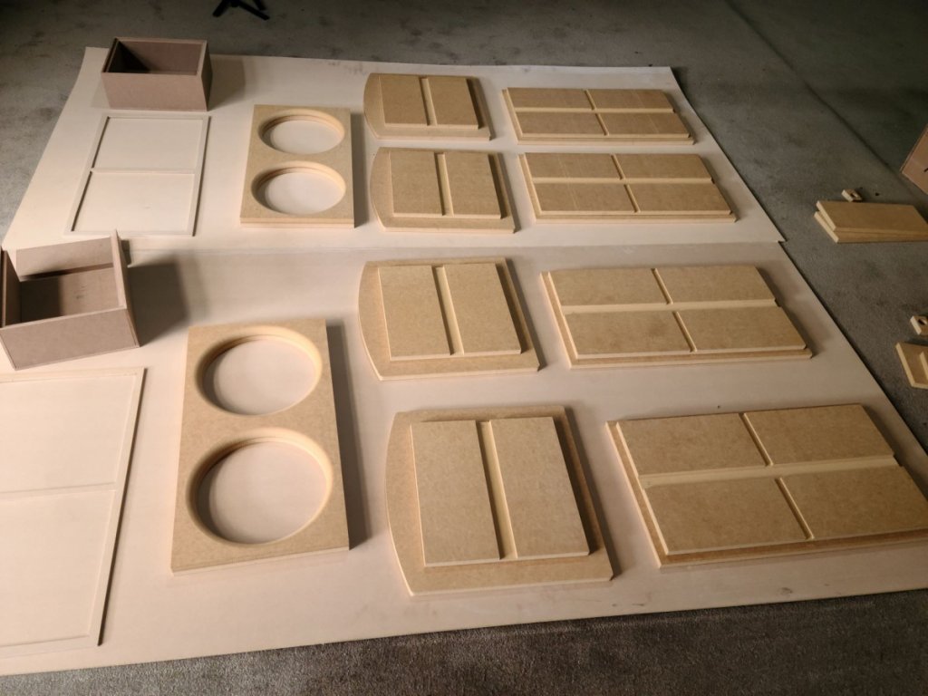

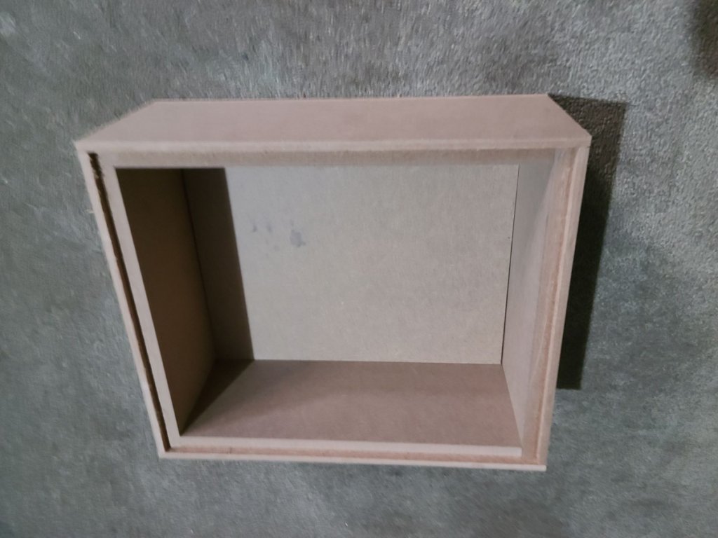

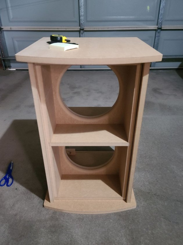

Dry fit of a sub frame - these are HEAVY and joints are TIGHT:

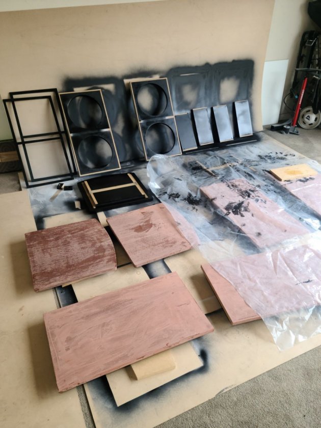

Parts laid out and rough sanded.  I had already glued up the 'sandwich' double thickness sections:

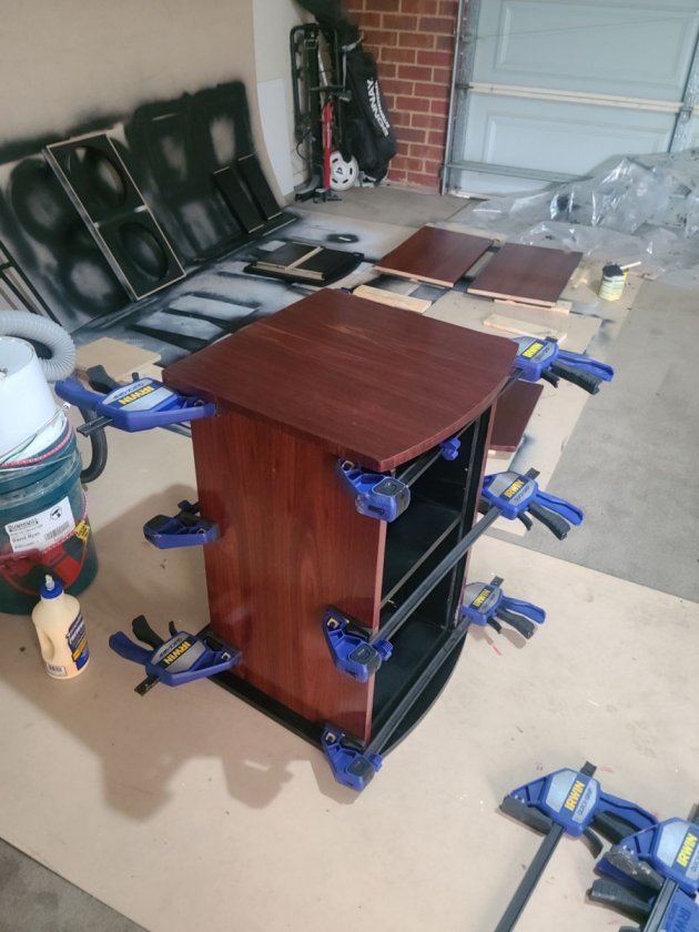

OK - so I undercoated the MDF parts (masking off the dado) but forgot to mask off the corresponding sections that fit into the dado - BIG mistake - as the paint meant the parts wouldn't go together without some judicious further sanding.  I had planned to veneer and undercoat all the relevant parts before assembly - whilst veneering made sense, I personally wouldn't waste time again on painting the remaining MDF until it was assembled and glued up.
My skills are not up to that task without a lot of double handling / duplication of work.  Next time, I'll veneer and finish, then assemble, mask off and paint.

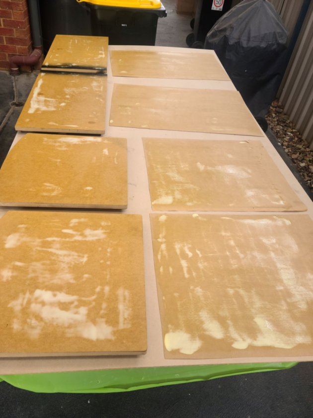

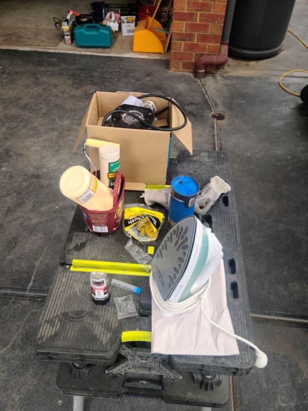

MDF parts and corresponding veneer coated with Titebond II and drying ready for the hot iron (Titebond II is available from most SydneyTools outlets here in Australia and it seems to work well for this job).
I used a Jarrah wood paper-backed veneer from Briggs Veneers here in Australia https://www.briggs.com.au/product-ranges/sustainable-natural-real-wood-veneers

Glue up:

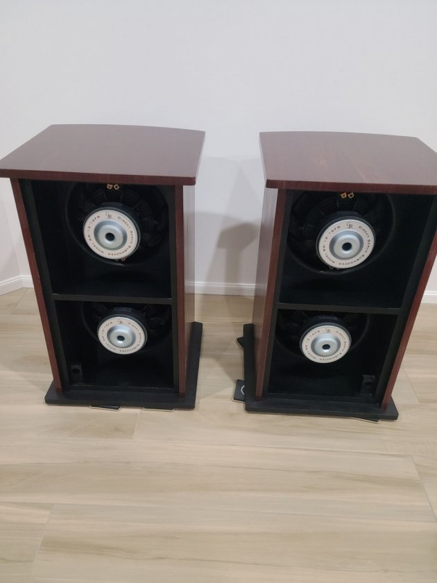

Finished frames waiting woofers and a polish:
With woofers fitted:

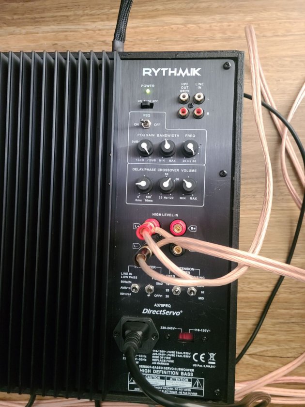

When in HT 'mode' I intended to use the pre-amp outputs which also feed the AUDIOLAB 6000A to connect to the LINE IN on the Rythmik plate amp.  After messing around with REW, I realised this wouldn't work as I was effectively bypassing the PEQ setting on the plate amp.  I NEED to feed the X-Statiks from the Rythmik plate amp in order to use the PEQ capabilities of the plate amp.  This may be self-evident now, but at the time it took some head-scratching.
I ended up routing the speaker outputs of the AUDIOLAB 6000A to the HIGH LEVEL input on the plate amp (frustrating, as I wanted to use the neater LINE IN connection) then looping out of the plate amp to the speakers:
The speaker wiring is double stacked in this image and PEQ seems to be working.

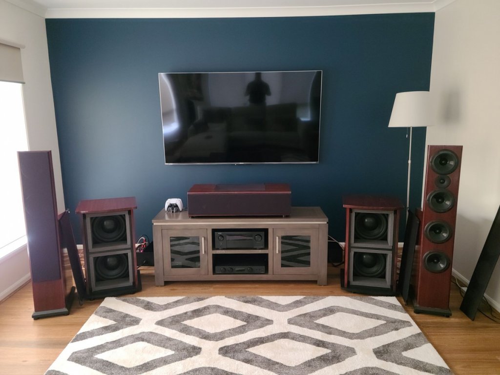

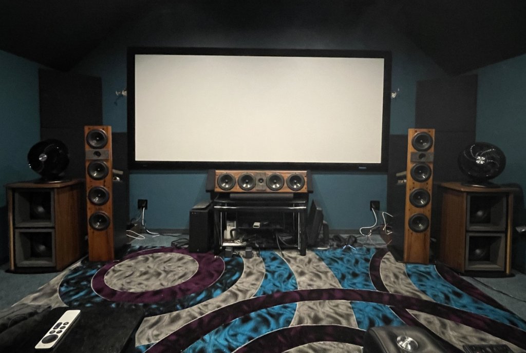

And final set-up in my music / HT room:
X-Statik are 5 feet off the back wall and OB subs are 4 feet off the back wall.

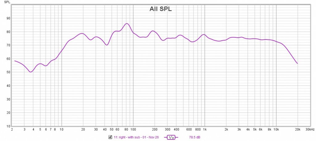

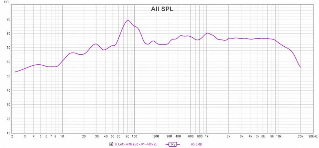

So, after 24 hours of running, I have the following curves out of REW:
LEFT
RIGHT
It looks like I have a peak at 80-100Hz in the room - this appears with both the X-Statik on their own AND with the OB subs in play.   There is NO treatment in the room, apart from sofa and rug.
The double roller blinds (privacy and black-out, respectively) across three large, floor to near ceiling picture windows (single-glazed in Australia  :o) seem to provide a measure of room control which has surprised me.
My plan is to give the subs a good 150+ hours of run in before remeasuring and then consider room treatment, although my ears don't notice any particular peaks or dips.  I have already noticed an improvement in the REW curve below around 30Hz, as the woofers break in.

Very nice!   That setup looks a bit familiar.    :green:
You can see some big corner bass traps in my setup similar to what Danny was mentioning.   They're 6" deep.   I never measured the response, though.   That's still on the "to do" list.   I already have the calibrated mic.   I just haven't gotten the time to mess with it.   I'm too busy enjoying the sound.    :thumb:
Oh, and I may also make the leap to the NX-Oticas at some point, although these X-Statics are doing exceptionally well.
