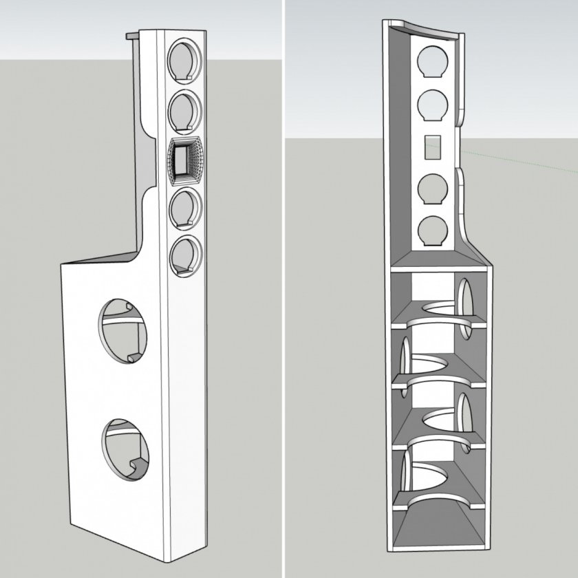

We did have the LGK "Wedgie" that used the Neo3, and 4 LGKs.
We haven't used the new 2.0s in an open-baffle configuration yet, but it should still work pretty well since yhey have a Qts of 0.7
I've also worked on a design that uses 4 M165 woofers down below.
Something like what you're describing should also work as well.

Now, that's almost exactly what I would like to build.  I've been dreaming about a set of Wedgies, but with a mid bass stack that might work without a sub, and would allow sub Integration at a relatively low frequency (50-80 Hz or so).  I had been thinking of something like NXOticas with the Wedgie as the upper element.  I hope that the new LGK drivers will work in the Wedgie.
Sortly after   we reddesigned the  Wedgie Cabs and  designed the Super Mini cabs,  Danny  had  us  design  a  matching  bass section  usning  4  M165 in  an OB  cabinet  that  matched to   wedgie/Super Mini speakers.  We sent    you  guys  a prototpe pair of these and as far as I know,  you    never  built them  out.  A second pair went  to a customer  who   as far as I know is   still using them  happily.
There is a  thread  on this  forum about   the    desing  of this cabinet
https://www.audiocircle.com/index.php?topic=164376.80     Post  # 90
There was another  design that used  3 M165's  front  mounted,   used only  3 to keep  height of cab   at  reasonable level.
I believe thaterre are pics of the actual  cabs later in that thread....

We still have the prototype M165 bases, we'll be assembling at least one of them with a prototype of the upper section that fits the new 2.0 drivers and verify that the design works out.

Is there any intrest in making these "LGK" Wedges using the new 2.0 drivers to be tested and sold as a kit? This speaker design is beautiful! I prefer it visually over the NX-Otica. I imagine that it could sound incredible too!

It depends on how soon we can get a sample cabinet from the guy who cuts out flat pack.
