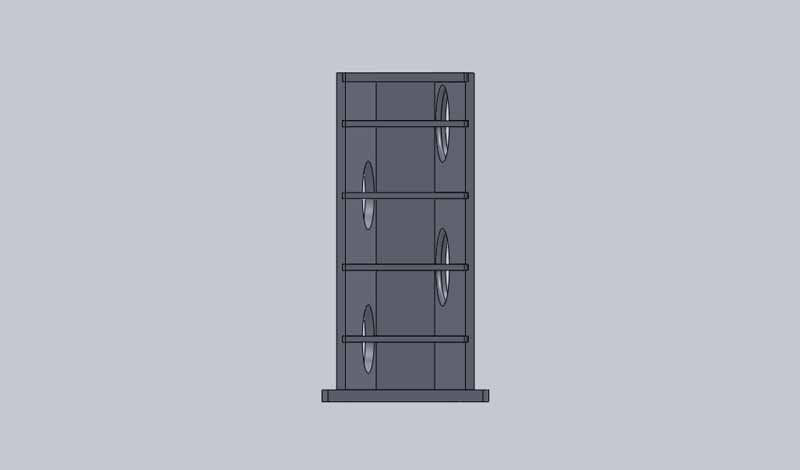

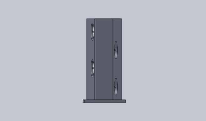

Anyway, here's what  we've been working on  for non-servo  lower section.
Ben able to keep  the cabinet identical to the Super Mini  so the Super Mini  can just  sit right on top... maybe with a  think layer of Sorbathane  betwen  them .
fully braced cabinet with an overall height ( no super Mini on top)  is 27.5"  with  a  1"  base.
Front
Rear
Transparent from   side
As with our other   cabinets,   all bracing located via  dado's in  wings and baffle.  dowels/screws   in base  for   easy alignment and glue up.
Haven't  cut  any of these yet, playing catch up with  other   stuff but they are on the list.
And yes,   you want them out inthe room.  I've heard of  some  people  not  quite  making   the   suggested  3' min but idally, you  want that.  Maybe  havem on  some sliders  so when you're critical listening, you can  pull them out ?   Have heard of people   doing  that  as well.

very cool looking and functional speaker base for the Mini's and other satellite speakers. I am going to assume these have openings for 8 inch drivers.

or I may be wrong probably 6.5 drivers. Will they come as a flat pack.

No,    4  M165's per  cabinet  (6.5"  woofers).    I loved them in  my  Otica's  !
jay Then , ideally, you'd pass them off to a  pair of   servo  sub  towers or   an existing  sub system  if you  have   one.
Flat packs  are   the paln.  Assembled cabs are  always  an option as well

 :D  can you just cut and build this a one piece with the smaller drivers non servo bottoms ?
          This seems feasible,, or not ??   :D

 :D the passive 4 driver per side has the same shape and size as top section,,,,, seamless ??   :D :popcorn:
