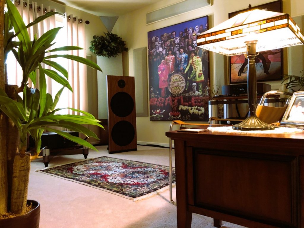

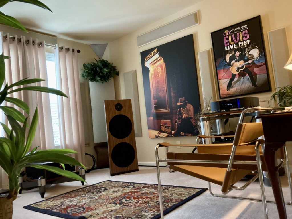

Pics as the room sits now - waiting for the 242s and the ABB1s. As mentioned I'll likley add more ASC planks later as well. But that will about do it - maybe plants in the front corners instead of bass traps. Oh and of course the large box will be removed when it is picked up.
Speakers are about 4' from the front wall, 4' from the side walls, 7'4" apart and my chair is 10'6" from the speakers which is about 7' from the back wall. They look more toed in than they are because of the pano shot. They are pointed to just outside of my ear on each side. I've moved the speakers and the chair around a lot (but more fine tuning can be done of course) and this is where everything sounds the best except the bass along the back wall I'm missing where the chair is. There is some, but not as much.
