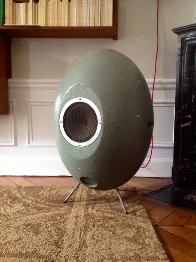

Seems to me that a spherical or ball like baffle might have the least negative propagating diffractions & an egg shaped inside of a box the least internal "boxy" reflections. There have been a few curved speaker cabinets and a few spherical. I once had Tannoy's with the side walls not parallel, and still heard a presence of the internal walls, also some early KEF pre LS50 that were curved on all sides except the front baffle and here again heard something of the speaker box shape. I've tried open baffles and then hear the back wall shape and nearness. Even with lots of stuffing inside a box, I've always heard the shape of the box.
Correct, the sphere is the best enclosure shape, second is the cylinder or tube.

Here's a couple of active 2-way designs that clicks many of my boxes from a few years back (please read the reviews):
https://www.soundonsound.com/reviews/se-electronics-munro-egg-150
https://www.soundonsound.com/reviews/munro-sonic-egg-150
https://www.soundonsound.com/reviews/munro-sonic-egg-100

Those look cool.  Fully active plus an egg shaped cabinet should make those a cut above a lot of other speakers.
I ran active for a while, back when I was doing some speaker design for my home setup.  The only problem I found was that it's hard to upgrade the amps if they are part of a fully integrated system like this one.  Not sure how important future upgradeability is to you, though.

I have a pair of the Munro Sonic 150s.  Danny Ritchie built me a set of passive networks for them so I can also experiment with other amplification.  Great little speakers. Again, these cabinets with little or no cabinet diffraction just vanish.

Those are interesting. Any idea what's become of the designs? From the reviews I gather they were molded which would have taken considerable time and $$ just for molds to be made. If I had to guess I'd say it wasn't viable financially, which is kinda sad but that's what drives a commercial venture after all. If it can't earn its keep, it will eventually fade into oblivion.
I could get close in looks with stacked lamination, but would be a boat load of work to finish like photos. Easier if a stepped exterior/interior was employed but even that would be huge gob of hand work.
 I wonder if the molds could be purchased?
