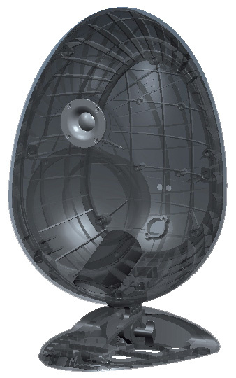

Those are interesting. Any idea what's become of the designs? From the reviews I gather they were molded which would have taken considerable time and $$ just for molds to be made. If I had to guess I'd say it wasn't viable financially, which is kinda sad but that's what drives a commercial venture after all. If it can't earn its keep, it will eventually fade into oblivion.
I could get close in looks with stacked lamination, but would be a boat load of work to finish like photos. Easier if a stepped exterior/interior was employed but even that would be huge gob of hand work.
 I wonder if the molds could be purchased?
 Making the plug would be the tough part. Molds made of fiberglass are easy and reasonable cost.
Judging from image of interior ribs and reinforcement this was likely injection molded. Article says it's three pieces. I thought of f-glass or even carbon fiber, but I think rigidity would be a concern at reasonable thickness so would need some bracing which I assume ribs were addressing.
Possibly could be done in half shells front and rear and then joined, but still considerable work, not to mention development, some of which is beyond me. And I'd have to work fiberglass, which makes me itch thinking about it!

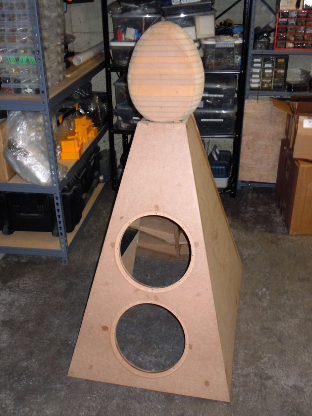

...I could get close in looks with stacked lamination, but would be a boat load of work to finish like photos. Easier if a stepped exterior/interior was employed but even that would be huge gob of hand work...
That's how my friend did the Egg part of his Waveform clones mentioned earlier.

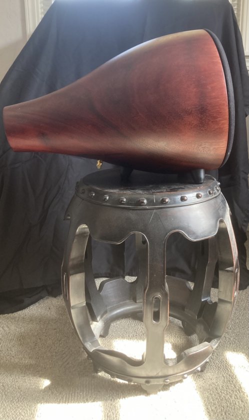

Here is an enclosure design that has very little to no resistance on the driver. It’s a full range single driver rear loaded horn based on the Tractrix theory. Take great drivers out of the “box”, place them in a superior design, and let the magic happen!
That's certainly a great design and very likely sounds fantastic but man, is that ugly!  :o 8)
I disagree, they look very cool to me.  More like art pieces than speakers.
Agreed, I like the black/maple combination.  I appreciate the additional detail incorporated for the aesthetic.  Very nice.
 Beauty is in the eye…I agree with Tyson!  The first time I saw them up close I was thinking the same thing. A work of art that will
emotionally engage you in the music.
That tie engraved wood is an ornament that does not need to be used, I suppose it only available to Lowthers  :scratch:
Please clarify your statement dunno what your commenting on?
The horns are solid wood Baltic birch plywood! No MDF or compressed cardboard! The chamber holding the Voxativ AF 2.6 is a series of Maple rings and the Maple face supports the driver chamber and is decorative. All cut on a C&C machine.
This design, like many adapted to extended range drivers requires lots of math and a bigger cabinet, while most DIYer's would rather make lots of sawdust from multiple simple sealed/ported boxes.  The egg shaped cabinets I referenced above is an alternative.  It uses a deadened molded material in a superior shape.
There is a restriction coming out of the air cavity that provides signicant resistance above a certain cutoff frequency.
