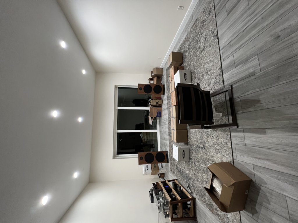

LOL for the Ikea chair. That is what you see pictured below. I have this on order and althogh it is leather, it is soft leather: https://www.potterybarn.com/products/raylan-leather-armchair/?catalogId=84&sku=3313847&cm_ven=PLA&cm_cat=Google&cm_pla=Furniture%20%3E%20Chairs&region_id=751260&cm_ite=3313847_14546951700&gclid=EAIaIQobChMIqL2diLKj-QIVC_nICh3lmwqIEAQYAiABEgIiNfD_BwE
I like the diffusors, thanks, will consider.
The shades used as a diffusor is a great idea. Will also consider but probably won't be wife approved - maybe.
Below is a pic from a few days ago. Rug will be here on Friday and curtains are here and just need to be hung - may add shades if wife approves. Since it is the LR wife approval is part of this and proving even more difficult than I thought.
I'm still working on "approval"  :roll: for the following but here is what I'm thinking:
-ASC 16"  tube traps in the two front corners
-??? behind the speakers and in front of the curtains which are in front of the glass. Maybe the diffusors mentioned above, maybe somehing from Gik or other but has to look really nice, as do everything.
-GIK 242 custom image panels on the walls for 1st reflections
-back wall - this is tricky because about 40% of it is open although there is drywall behind the seating position which is about 6' from my chair. Also tricky is that whatever I put on the wall cannot be more than 2" thick. maaaybe 3". May just do another GIK 242 w/ custom graphics or a canvas print.
Btw, room is approx 19' wide x 22' long x 12' ceiling height. She already told me no "cloud".
On that note I went ahead and ordered Focal headphones last night, which will probably get more use than the M3s unfortunately. The house is very open so M3s will only get listened to when she is out of the house - although I am thinking about sound proofing (as much as posible) the MBR door so I can listen to at lower levels at night.

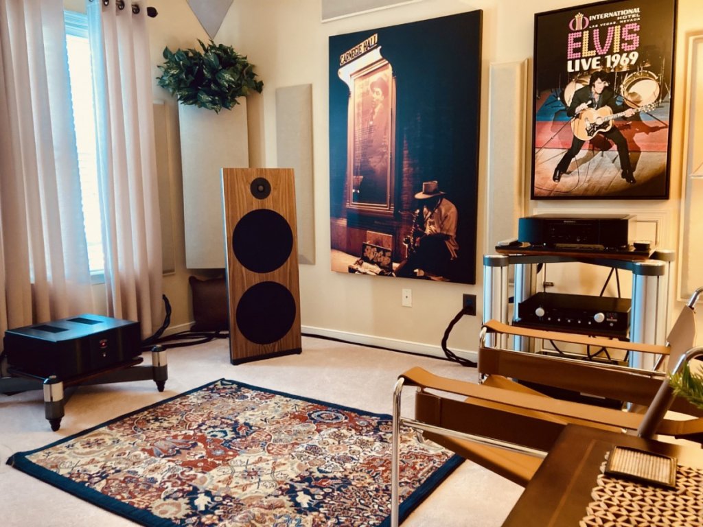

I've been told by one mfr to place center of wall treatments at seated ear height. So I did this for my OBs:

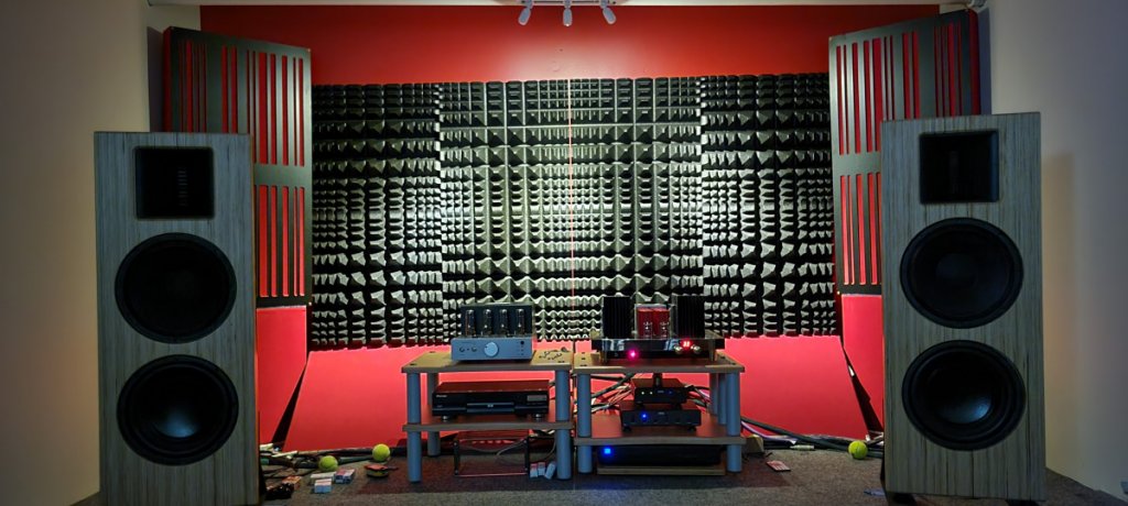

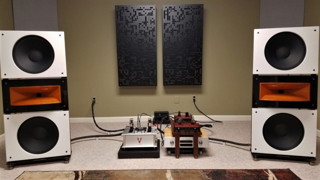

The photo is deceiving but I have my X5's toed in and the back wave mid and tweeters are hitting the GIK alpha panels squarely.  I also have bass traps on the floor which are the height of the woofers in which the alpha panels are resting on.  I placed the diffusion panels in the middle of the front wall that Aniwolfe mentioned in an earlier post which covers most of the front wall as I have a narrow dedicated room in the basement.  I found this sounds best in my room.

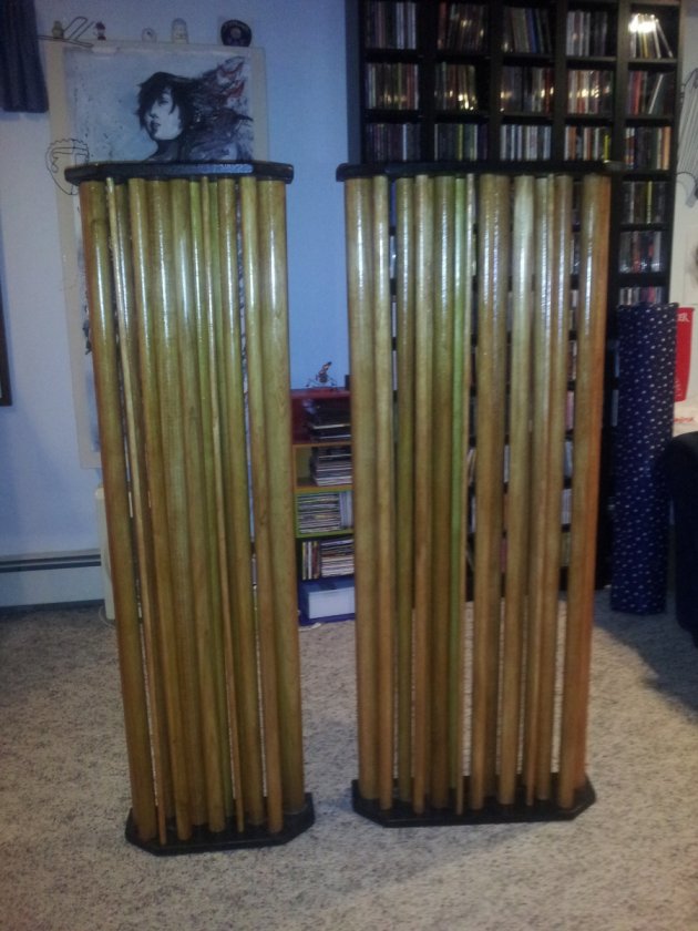

I built these after seeing the (very expensive) buddist monk version at a show. It's just a bunch of dowels, stained and varnished and held in place by a board top and bottom. Varying diameters and a random pattern of placement. I have one on the front wall behind each speaker and they work wonderfully and look a bit better than many other options.
forky
Re: Acoustic Treatment Behind Open Baffle
« Reply #12 on: 2 Nov 2022, 08:07 pm »
Wow, have never seen anything like that before but look great. My racks are maple w/ walnut and the M3s are walnut. Gets me thinking....but we'll see how the ABB1s do first once I figure out mounting and height.
