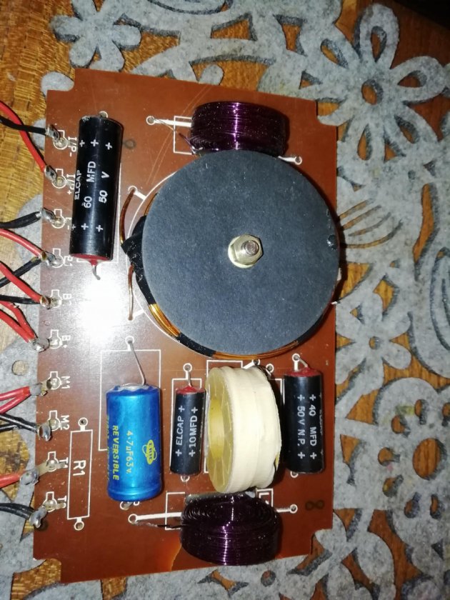

Regarding the crossover, which looks pretty basic: any advise which caps might be a good replacement / improvement?
(picture is borrowed from the internet - but mine looks the same...)

« Reply #5 on: 28 Jun 2022, 03:18 pm »
Glad you found a tweeter.
The black caps are film caps so they dont wear out.
The blue cap is bipolar electrolytic. It requires liquid electrolyte to function correctly. Over decades they dry out and misbehave.  You can replace it with a film cap of same cap value (4.7 uF) and equal or greater voltage rating (>50V).
Normally the electrolytics are used on bass range because they typically aren't as refined on treble frequencies. But this electro is the smallest cap value so it might be your tweeter cap, in which case it could be dried out and causing the scratchy tweeter. If you can inspect xo board to verify that it is the tweeter filter cap then I would bet it's the problem.  I'm thinking it was selected for treble because it sounded better than EL CAPS.  I would replace the blue electrolytic cap with a decent film cap like Jantzen Superior-Z. You might want to also experiment with upgrading the EL-CAPs for SQ but they dont need to be changed for function. They might have been a cost cutting option since they chose something different for the more critical treble range. But I'm just guessing.
The inductors are all air-core so no benefit to change those.
There are no resistors, which is a sign of a very talented and/or lucky speaker designer.
Get the tweeter and everything else fixed before consider SQ upgrades to avoid rabbit hole.  :lol:

Please post a picture of the reverse side of the crossover board so we can see what that blue cap does. Thanks!

You were guessing right - it goes to the tweeter…

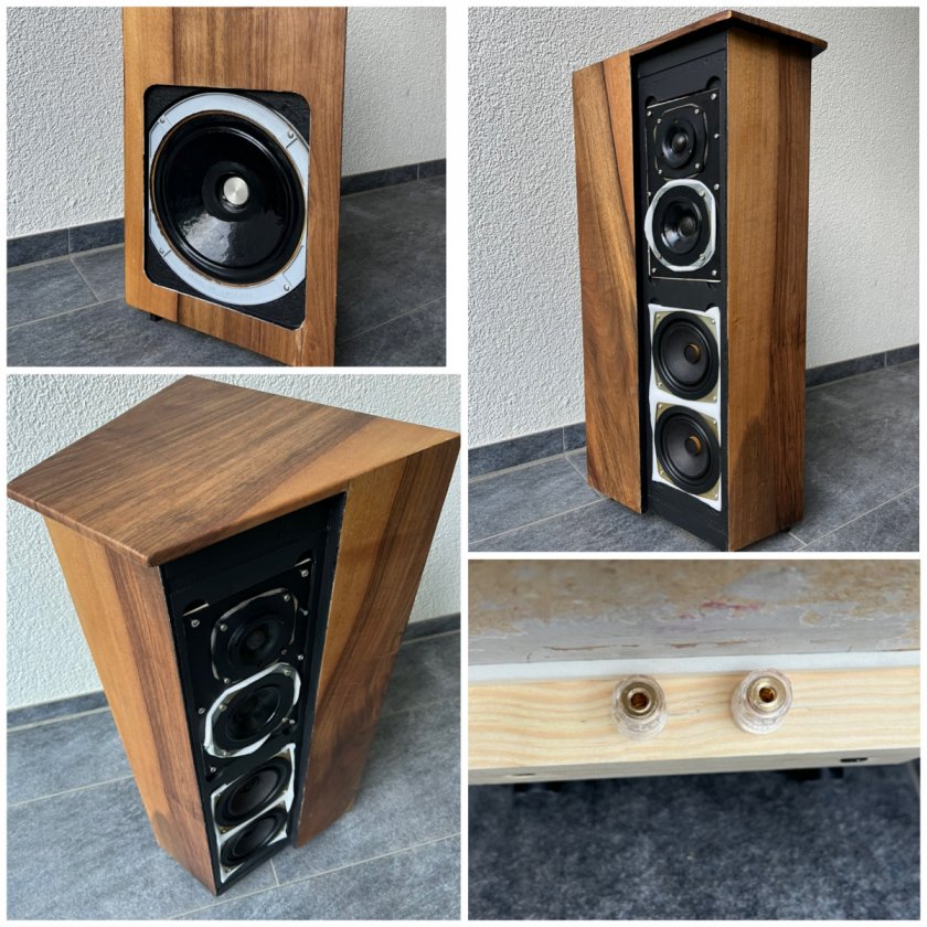

Let the cabinet work begin…

Made some good progress on the cabinets and the caps arrived today…

Finished the first, the 2nd will be ready tomorrow. Improvised a bit with the connectors. So far I‘m pretty happy with the result.
