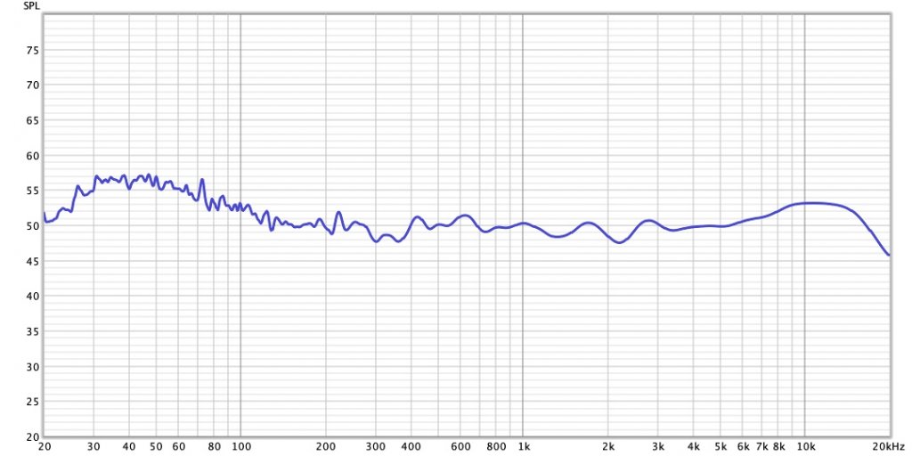

How can I get a flat frequency response within +/-1 db between 60hz and 10khz
You can waste a lot of time and money trying to achieve that, only to discover you don't like it.  Especially at low volumes.  For me, the following response chart is very pleasing. Hardly +/- 1db.  YMMV.
@ James, your chart looks incredibly flat.  Just curious, how do you define the "Listening Window"? Is it on axis, or an average over +/- xx degrees?
EDIT: @ James, please discard.  I found a definition of the term.  Simply put, an average of 5 measurements taken - on axis, and 15 degrees left, right, above and below axis.
BTW, my measurement is using the 'moving mic' method at my listening chair.

whydontumarryit
  • Posts: 218
Re: Flat FR
« Reply #4 on: 29 Mar 2022, 10:04 pm »
That is a fine looking in-room response you have there Groovecontrol.
Close enough to within 2db to suit anyone. Although, obviously not possible unless REW or the like is used to flatten the low end.
As you can see from the photos of James' listening rooms it appears that nothing more than front wall treatments are used to tame the room and he has made it clear his views about EQ.
The problem is while still being the best speakers I have ever heard, reading the glowing reviews from people hearing James' systems (even the Mini A!) makes me think something is missing and that he would be able to shed some light on this by describing his methods of speaker location, room setup, etc. unless the information (link?) has already been discussed.
I asked if he had personal in-room measurements not marketing copy. Much like you were kind enough to provide. For what speakers btw?

Hi Why
I just ran now a FFT response of my set-up at the listening location for you.
james

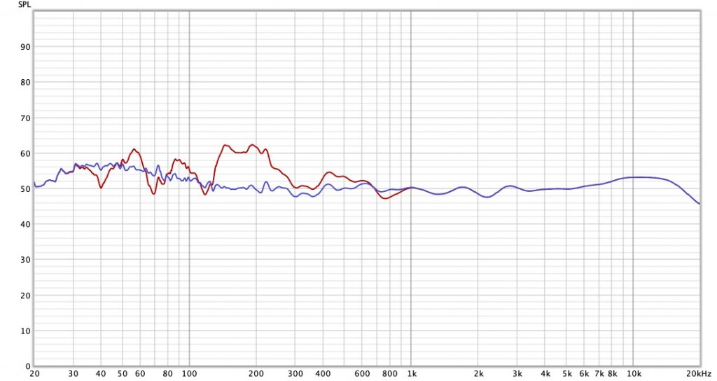

GrooveControl
  • Posts: 239
Re: Flat FR
« Reply #6 on: 29 Mar 2022, 11:03 pm »
You are correct, I'm using REW/miniDSP to equalize below 1Khz.  Here is chart showing the unequalized response in red.  Somewhat nasty.  Not sure if it's the room, the aftermarket recone kits, or most likely a combination of the two. Either way, the EQ helps a lot more than it hurts.  The speakers are JBL 4430.

Hi Why
james
James, I wonder how few people realize not only how near to perfect that curve is, from the perspective of music listening in the real world, but how VERY difficult to achieve with actual speakers in real, non-anechoic, rooms, without EQ above, say, 100Hz. Without EQ. Most speakers (i don't care what technology or cost) never come anywhere close in actual listening rooms. And I've heard many and sometimes even measured a few.
Having said the above, there are other equally important considerations in speaker setup relative to a given room. I find very small differences in toe-in, listener seating distance, space between the speakers relative to the principal listening location, distance of the speakers and listener from room boundaries, all to impact soundstaging, perceived sound response, perceived dynamic shadings, and overall musicality.
Cheers

whydontumarryit
  • Posts: 218
Re: Flat FR
« Reply #16 on: 4 Apr 2022, 07:35 pm »
I now wonder what is the relationship between that text book in room response and the ability to move from the preferred listening location while maintaining a stable image, aka a large sweet spot. That is, does a flat response tend to stay that way at different listening positions and does a 3db variation turn into a 6db variation at some point vs listening position, making a flat response the primary goal.
The choices made (intentional or not) to reproduce an Olive-Weilti type, experienced listener preferred in room response (as indicated in the graph) would be one reason for visitors to be impressed.
Also, if the graph is showing an unequalized LF response, the boost at 25hz is a full octave below what is typically seen in your average listening room. What's going on? Is it the room dimensions responsible for the LF room modes or is it possibly parasitic vibrations from the 'live' walls in an average room. It would be interesting to see a comparison of high SPL LF thd measurements between each type of room. I suspect that the 3-10% thd usually seen below 100hz will mostly disappear in this correctly optimized room. I have never understood why the increased distortion is there in the first place and why nobody ever questions where it's actually coming from.
The original question about whether I should abandon this non-sensical purist attitude toward using EQ to get a flat response in my room was answered by the advantages claimed using active crossovers. If a linear phase, FIR, DSP device can be used for that purpose then it can be used to do what I want without concern. Used either way it's EQ, plain and simple.
Since the LW and DI of the middle-t are correctly optimized to take advantage of EQ without a problem, why not. There is also the uniform opinion that any changes made below the Schroeder frequency have no detrimental effects. So, it looks like a mini dsp is in my future.
All I need now is that BAX-1 config. file for the middle-t from Bryston to load into the mini dsp. Fat chance, eh.  :)
jcn3
  • Posts: 70
Re: Flat FR
« Reply #17 on: 6 Apr 2022, 07:21 pm »
Cheers
Brian
I agree -- my mouth was hanging open looking at that!

Hi All,  I'm trying to understand why you consider a response that falls 10db from 1khz to 10khz, and then another 10db by 20khz to be near perfect?  Is this simply an alignment with your preference? A power response?  or what?  Not challenging anything here, just trying to understand it.  The chart is 10db per division.
Thanks
EDIT: Okay,  I think Blueshound and jcn3 are referring to the first chart in this thread, and not the green one I'm including below.  Makes sense now.
