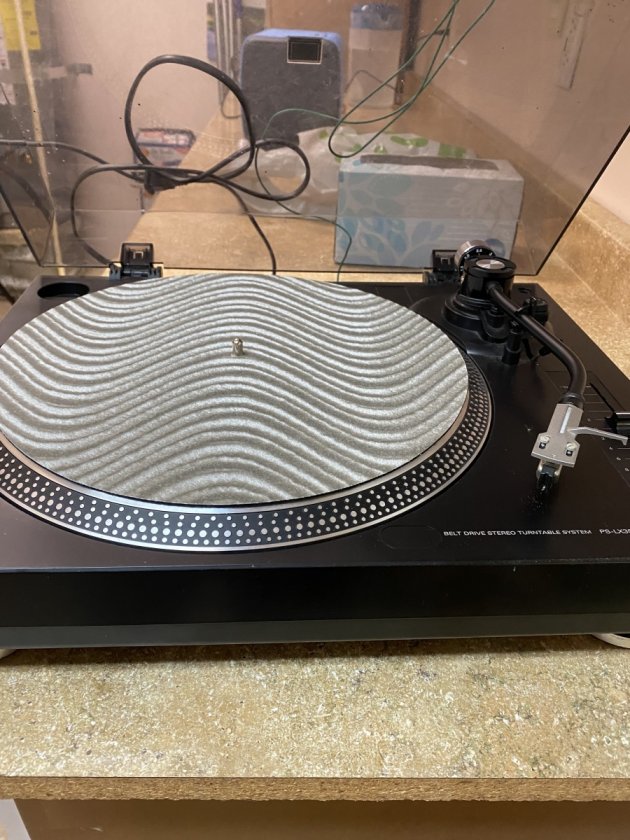

Several years ago, I bought the above TT on Craigs List for next to nothing. At the time, I had a preamp for it, but that is long gone. The TT has been sitting in my garage taking up space. I have a grand total of 35(?) LPs sitting in a closet, so I don't need to spend huge amounts of money on this.

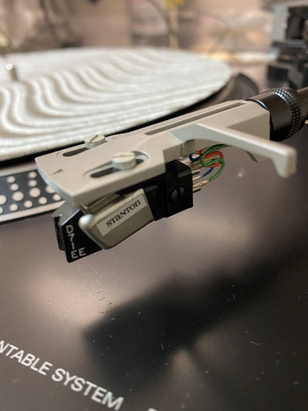

My need for instant gratification drove my choice of phono pre. The iFi Zen will arrive in a couple days. The Schiit Mani won't ship for a few weeks. I haven't decided on which cartridge to buy. I'll snap a photo of the existing one and post it here.

Is this a P-mount cartridge?

Yes,  with a Pmount adapter to fit in the standard head shell. You might just want to get a stylus for the Stanton instead of a cart.  If your albums are pop/rock, the Stanton will work nicely.
Interesting! I'll double check, but I think my LPs are mostly Jazz.

Yep, looks like a P mount adaptor.  And I agree that there's nothing wrong with that cartridge.  I'll look at options for stylus upgrades.
Looks like an extra $40 buys a slightly better stylus than the original.  https://www.lpgear.com/product/STAD0071EE.html
If you can set up a cartridge, you can do better, but with a new stylus, that Stanton will do a decent job and play your records reasonably accurately.

Take a look at Lpgear and Turntableneedles, they have the stylus.  I think that way you won't have to mess with aligning a new cart.  That can be frustrating for someone not familiar with the ritual.  Assuming the current cart has been setup by someone with experience.
