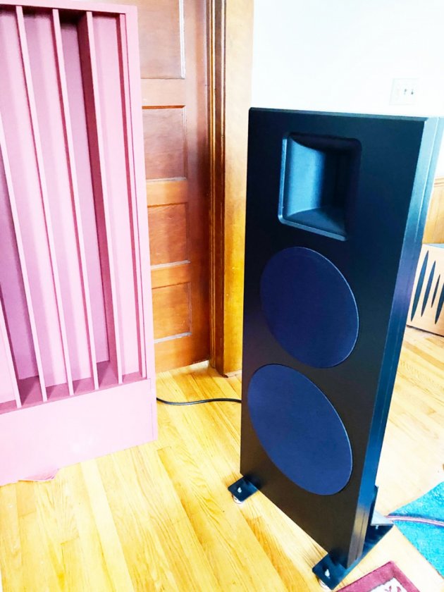

Last weekend I delivered the Dunlavys to their new owner and on the way back picked up a set of X3s.
I'd heard Spatial Audio briefly at CAF2019 and was quite impressed with their sound, given the obvious constraints of a small hotel room. I've owned dipoles in various forms over the years including Quads, Apogee, Magnepans, and Carver Amazing Plats, so it's a style of presentation that I generally like. But the X3s were an unknown entity and some would say the wrong choice of speaker for a modest 16x18x8.5 dedicated music room.
Getting them into the system was pretty straightforward, I dropped them in the vacant spot previously occupied by the Dunlavy SC-IIIs, 76" off the front wall and around 29" from the side walls. I have my room treatments optimized for this position (catching first reflection points etc), however, they're currently set up primarily for a sealed box design, with minimal treatments on the front wall (behind the speaker) and a bank of QRD panels on the opposite wall behind the chair.
Most speakers have worked well in this position, requiring adjustments of only a few inches to get them dialled in. Not so with the X3s. They didn't sound right. The first thing to strike me was the unwanted localization of instruments seemingly attached to the speakers. They did not 'disappear' as I'm used to. Toe-in helped a little, but not much. Also, there was a thickness in the mid-bass. Geddy Lee's Rickenbacker didn't sound sharp and defined and lost some of its usual tone and timbre.
So I moved the speakers back closer to the front wall starting at 48" and over the course of the week moved them forward incrementally until I found a good spot, which happens to be at the 60" mark, 16" or so closer to the wall than my SC-IIIs had sat. In this position, the speakers disappear well and create a good soundstage, high, wide, fairly deep but not as deep as the SC-IIIs. Sitting an additional 16" or so away from the speakers also helps with the top end, which sounded a little too energetic when sitting closer.

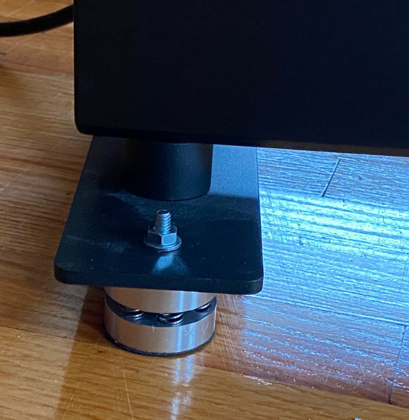

The mid-bass issue persisted so I set about replacing the stock feet to see if things would tighten up.
I know people are having success with IsoAcoustic Gaia feet, and I'll probably order a set of those at some point, but I've had excellent results with other speakers using a modified spring system, which is both cheap and very effective. Picture below.
They don't look great but as I said I'll probably change them out at some point to the Gaia II. They do work extremely well. The sound has changed for the better across the board. Tighter images, more depth and definition, more air around instruments and performers. But still that slight thickness and veiling in the mid-bass.

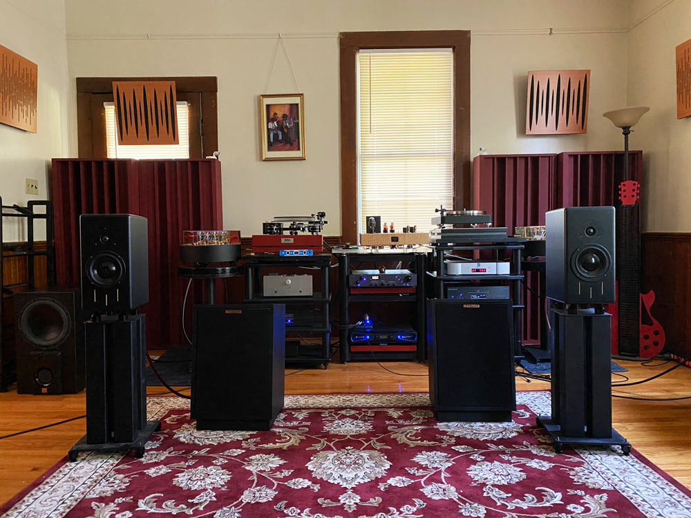

At this point, I haven't introduced my swarm configured subs into the equation. I'd rather remove the mid-bass issue first, before activating the subs.
I think part of the issue might be the way I have my room treatments configured. I probably need to move the QRD panels from the back wall to the front, to diffuse the back-wave. Unfortunately, that's easier said than done. There are four panels and they weigh a couple hundred pounds apiece, plus....they block access to the front door!
You can see where I had them previously below. This is where they need to be, I think:

    Not yet, I've always sat tight against the back wall in this room due to it only being 18' long. I've heavily treated the back wall with QRD panels and also an absorptive panel behind my noggin. You can see it here - excuse the mess
    The tall panel to the right of the photo is a bass trap and I move it a foot to the right of where it is when I'm using the system.
