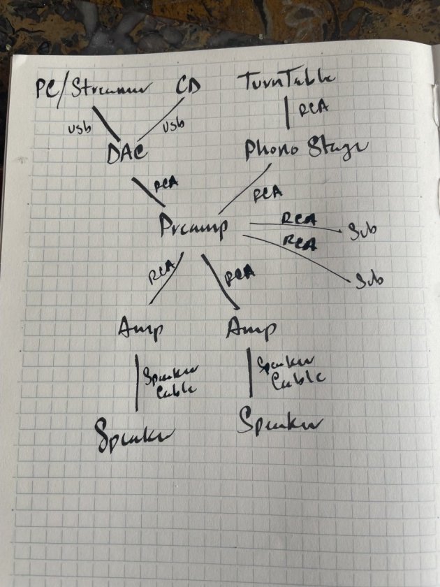

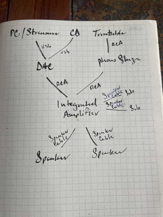

So this is how I'm mapping it out:
This question will expose me for the newb I am:
If I want to eventually have a set of NX Oticas and dual servo subs for each speaker cabinet like New Record Day has in https://www.youtube.com/watch?v=ldrL3EdnLvA&t=618s, then I need a total of 4 channels but only two channels per Amp, right? Two channels per amp, 1 channel for the speaker cabinet and 1 channel for the sub, right? Or am I way off?
Obviously, knowing how many channels I need will inform what gear I buy and I want to make sure I don't screw up on buying my first pieces of gear.

The subs have their own amplifiers so it does not change anything for your other amps. Basically, if your DAC has volume control, you can run a copy of the signal that goes to the amp out to the subs and you are done. There is one other config that can work but I will leave it out to keep it simple.
Note that if you are looking to build up a system, buying a single 2 channel amp and driving both speakers from that is a good start. If that amp can be 'bridged', that means you can then buy another amp of the same make later and use them as monoblock for each channel separately.
You really don't have to do that though. There are a lot of good 2 channel amplifiers.

If the DAC you choose has a volume control then you can probably get away without a preamp for a simple 2 channel system.
But if you want to add subs you will likely need one.  Sure, technically you could split the output of the dac 4 ways (yes, 2 per channel).  But most dacs have a fixed output voltage and are not really designed for driving multiple amplifiers.
It may seem redundant but a preamp does a lot more than just provide source selection and volume control.  It adds an amplification (or gain) stage between the source and amplifier.   It can more easily drive multiple amplifiers with long cable runs if necessary.  Ideally you want a preamp with 2 pairs of outputs.  Or one with a regular output and another output for the subs.
It’s about controlling the signal and maintaining signal integrity.

As some before has said, the only way to do your setup you have sketched is to get a DAC with a volume control. The one that's on the top of my list (and Tyson's) the MP-D2 has a built in one... and it sounds awesome! - I don't have much experience with the other new DACs, but I can say... this one is great!
As far as preamp and amplifier vs integrated, I would go the preamp and amplifier/s. You can certainly do a stereo amp with the preamp (stereo=amp that drives both channels, usually one power supply for both channels. Mono/monoblocks= one amp per speaker) This does allow that extra flexibility for whatever you want to do down the line, in addition to (again) a separate power supply for that section.
I've sketched up a couple more configurations for you that your system could evolve into:
Please note, that the RCA can be swapped for balanced cables... I'm not going to get into that right now, but there's a TON of info out there between RCA and Balanced cables. I run RCA, more universal, and every piece of equipment will have RCA's (98% of the time). Also looking at it, I don't think you'd run a USB from a CD transport. BUT, those basically have already gone to the wayside. If you're already running a PC, I would rip all your CDs with a program like dBpoweramp, to uncompressed FLAC files. Then use a program like Foobar2000 (or Roon if you want to spend the money, foobar is free) to play all the CDs. There's no loss in quality.. and it's MUCH more convenient than changing each CD... that's for the birds!... or vinyl :lol:
