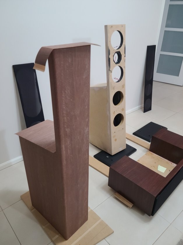

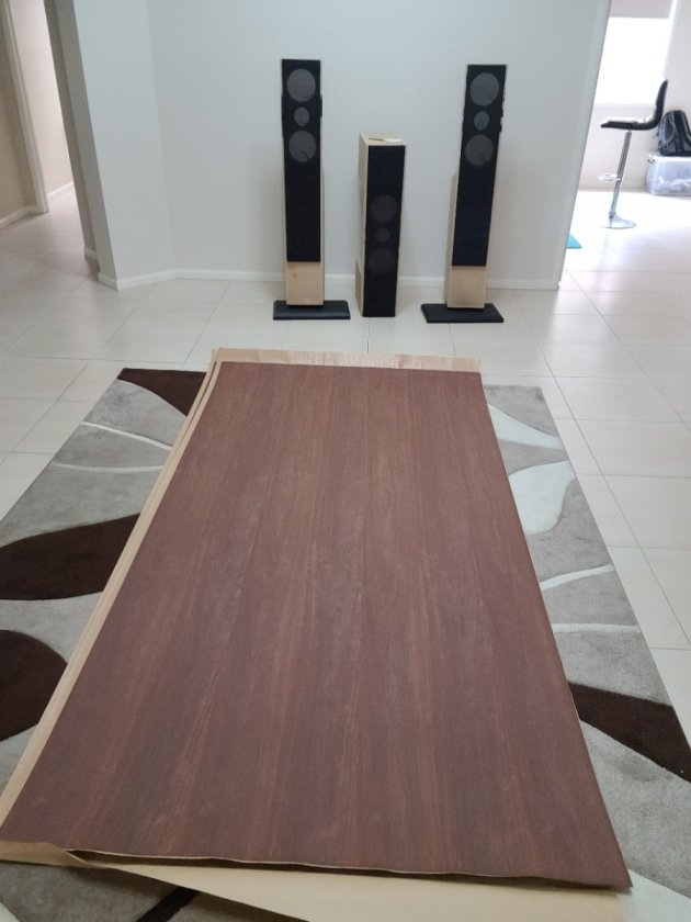

a bit of an update ... veneer finally turned up.... now to learn all about veneering .....  :roll:
This is paper-backed Jarrah wood - a native wood from Australia.
Thank goodness for youtube and Peter's detailed speaker build videos.
I'm going to test finish a few pieces before moving onto the 'main event'.  I'll post some pics when I get that far.
D
D
Are you going to stain that veneer?  Cool looking veneer for sure.

There are two sheets there, so plenty to go around.
In terms of finish, I’m planning  to iron / glue the veneer using Titebond 2 (Heat Lock is silly expensive to ship here) - apparently it will work quite well and has up to 12 hour reactivation window, so all good.
I’m going to do a sample board to help work out what to do and either do multiple coats of polyurethane with bouts of fine sanding or clear danish oil then multiple coats of poly.  I want to enhance the natural colour and grain of the wood whilst protecting it from daily knocks.  I’d also like to get a high gloss finish.
Jarrah, if exposed to UV, like most woods will mellow and eventually turn a sliver gray (which I quite like), but in this case I’m hoping to keep the rich red colour, with uv protection from the poly.
I’m a total wood working noob, so there will be lots of trial and error before I’ll commit.
It’s all great fun, keeps me quiet (as her indoors says) and hopefully gives me something i’ll be proud of in the end.
Still weeks away from firing up the drivers … I reckon that’s going to be a great Christmas present for myself!
Once these are done, roll on the next step….
D

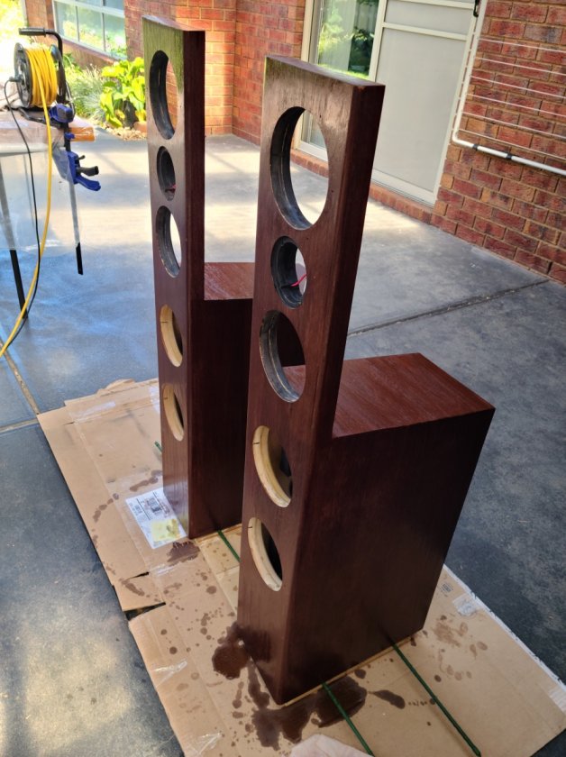

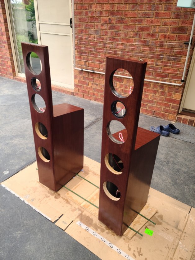

Some further updates and progress (albeit slow):

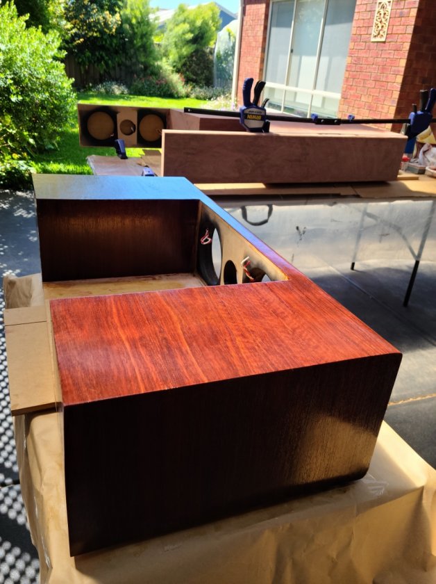

Veneering in progress ... Titebond II seems to have worked well.
Danish oil going on:

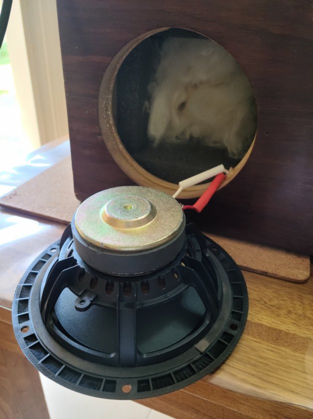

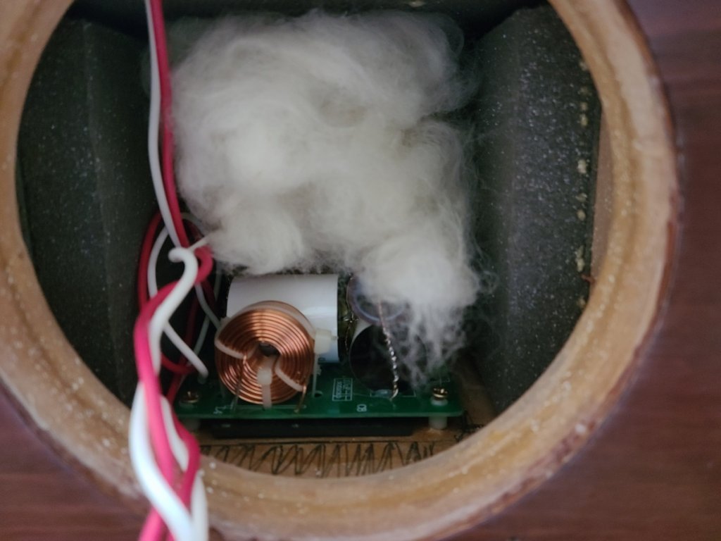

X-Voce speaker wiring - I went with carded lambs wool for the fill.

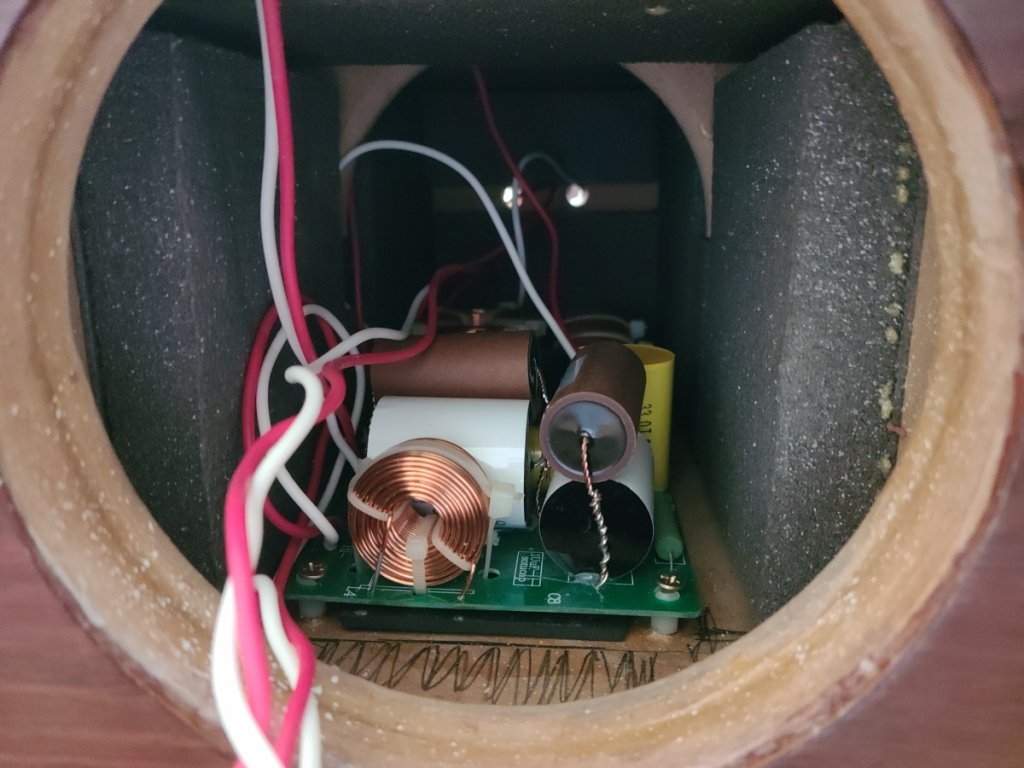

X-Voce cross-over in place - this was the most fiddly bit - not a lot of room to get the screws in to hold the cross-over in place.....

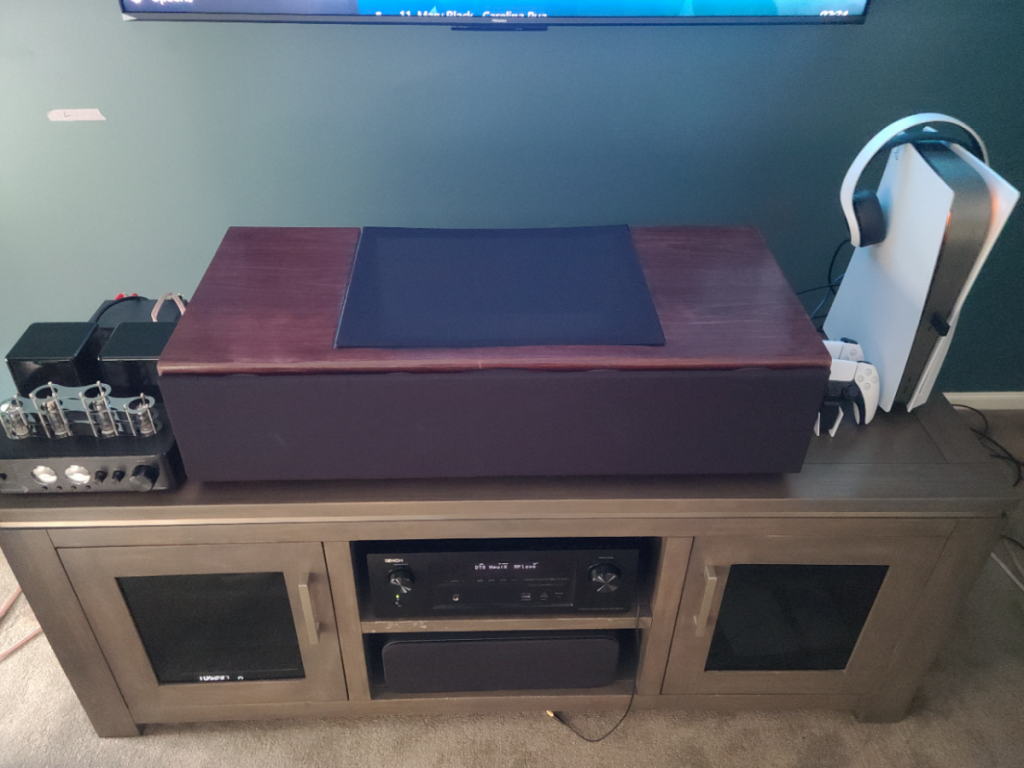

X-Voce up and running.  A BIG step up from the Q-Acoustics centre I had previously....  I need a new media centre.  The Dayton Audio HTA100BT amp is my first 'tube' amp. I'm impressed when it feeds my existing speakers.  I'm really excited to hear how well it sounds feeding my X-Statiks.
 My wife wanted a cover over the OB section, so I knocked up a quick 'dust' cover.  It's just resting on the No Rez in the OB section, but seems to do the job.  I'm still going through 'burn-in' - about 40hours on the clock so far using the 'fry baby' file at night and music / movies during the day.  So far - I'm very impressed.
5th coat of polyurethane over the Danish oil on the X-statik.  I'm waiting for it to fully 'cure' before polishing and buffing.

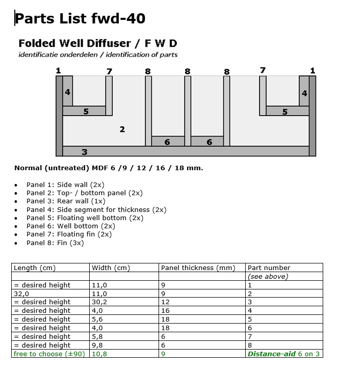

I can't wait to hear how it all comes's together.  I'm also planning to build some folded well diffusers for behind the speakers.
