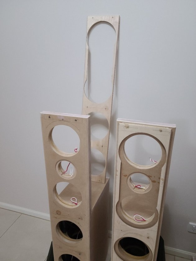

How did you go about the grills?
I’m looking to make some for my Statik and Voce. Was thinking of using like 2 1/8 MDF, or 1/4 and 1/8. I was thinking to seal off the back side to hide the cloth. Using magnets for the attachment (which are coming)
You happen to have any photos of how you did them!? Great work many! Real wood looking sharp!!

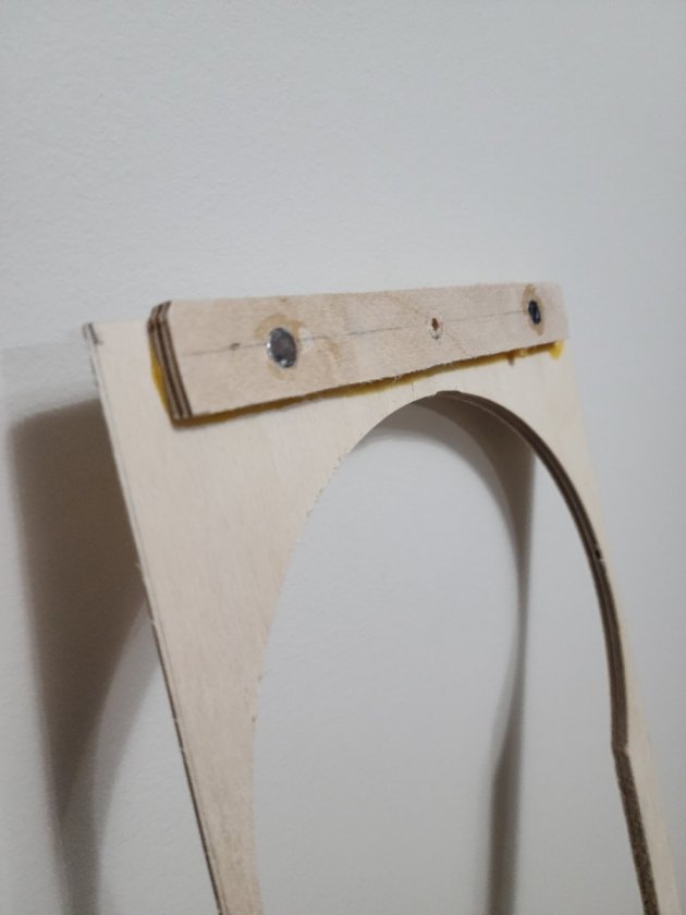

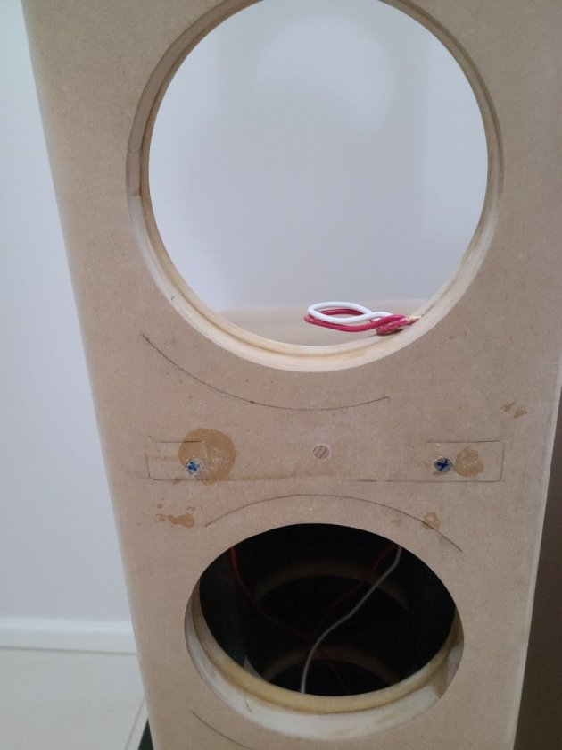

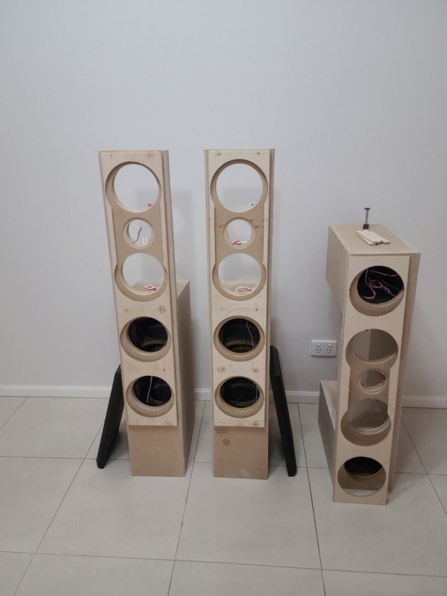

Hi and thank you.
I cut up some 6mm birch plywood and paired magnets with some buried in the MDF before veneering the cabinets.  I painted the grill frames in duratex, I then hot glued some hook and loop tape onto the frames and wrapped the finished item in speaker cloth.
Here's some photos at various stages:
Hope the helps somewhat?
