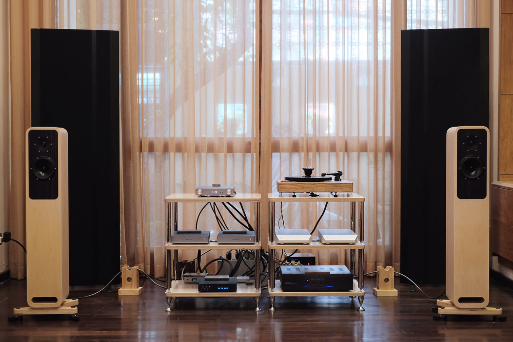

AMG STA or ST-10 driving Magnepan MG 3.7
This came from a dealer showroom in Vietnam.
