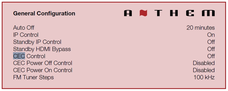

CEC - Anthem Manual
"When Consumer Electronics Control is enabled it allows controlling one HDMIconnected component using another’s remote control, as long as CEC is also enabled in the other components.
Note that when component brands are mixed this control system may not be reliable.
"CEC Control must also be On for Audio Return Channel, described in an earlier section, to function.
"With CEC, turning on one component in the system can turn on the rest of the system, same with turning one component off. You may or may not want this which is why separate options are provided for Power Off and Power On control. When either is disabled, the corresponding power commands sent by other HDMI-connected components are ignored. This is also useful if you would like to use Audio Return Channel but not one-touch power."
