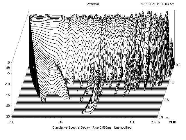

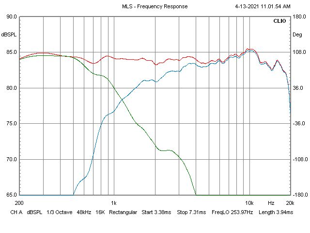

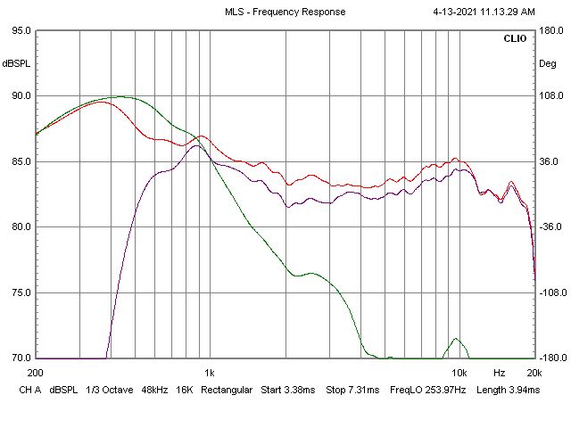

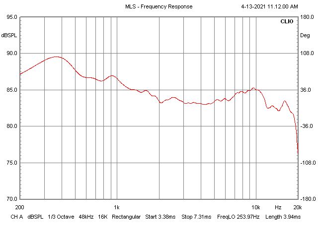

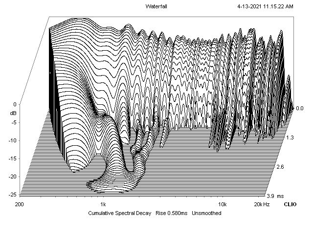

Okay i've got the before/after for the LRS Kit.
Stock crossover:
Updated crossover response:

« Reply #5 on: 30 Jun 2021, 02:58 pm »
Dang, those things were really mid bass heavy to start with
  • Posts: 11647
Re: Anyone familiar with the GR Research LRS Upgrade Kit
« Reply #6 on: 30 Jun 2021, 04:10 pm »
Wow, that's a pretty intense lower midrange hump in the stock speakers.  Looking really good after the upgrade though.  And looking at the Spectral Decay plot, the nastiness at 1kh also got cleaned up a fair bit.  After the upgrade, these speakers should sound MUCH cleaner and more detailed.
