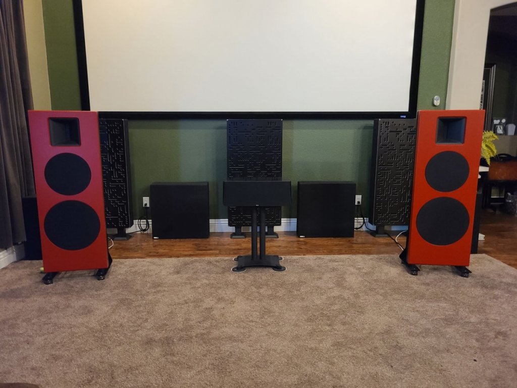

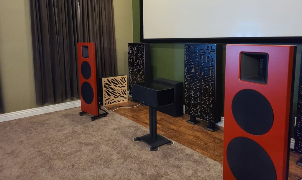

Thanks Al.  I thought I would post a couple photos.  The old center channel speaker is disconnected.  I am only playing stereo (2.0) versions of my music.
View from the MLP.  10 feet to speakers.  15 feet to front wall.  I added the GIK bass traps because they were not being used elsewhere.
Side view.  I had a couple extra GIK diffusors so I put them to the sides.

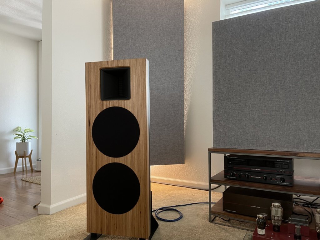

The right side of my room with X5's is completely open to an entry/hallway/kitchen. I do have quite a few room treatments, but haven't really found the asymmetry to be a problem for the Spatials.
