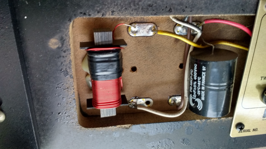

Hi forum members,
I would like to open my LRS's to replace the ferrite-core coil by a Mundorf air-coil, like I did with my MMG's with positive audible result.
The first step is to remove the wood-like strips on the side of the panel. How do I do that? Just gently pry a blunt screwdriver between cloth and strip or...? I don't want to break the strip obviously...

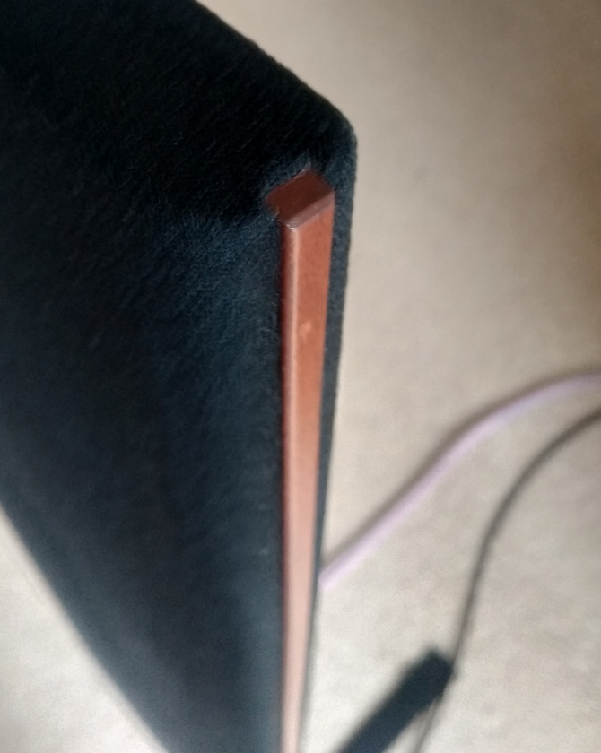

It’s suppose to be Dark Cherry, but it looks black in normal lighting
I ordered the Dark Cherry trims and it appears to look pretty close to the top photo in regular daylight. I have a cherry wood dining table and the colors match quite well.
Did you perhaps receive the Black Solid Oak trim by accident?
Paul

« Reply #8 on: 22 Dec 2020, 11:41 pm »
Paul
I guess they fixed the issue with the dark cherry being too dark.  I contacted Magnepan when I first received them because I initially thought, like you suggested, they used black oak instead.  I was told they had a number of complaints of the cherry trim being too dark and they were working with their supplier to fix it (no offer was made to fix mine).
When viewed in direct bright sunlight, I can see the trim on mine is indeed dark cherry (REALLY DARK!) and not black oak.
When I reached out to Magnepan again asking about the possibility I could replace the trim, I was given an email address for the manufacture dept to contact.  My emails to the manufacture dept went unanswered, so I gave up on it.
Btw, here’s mine in bright daylight.  In normal room lighting, it looks black, or at least near black, to me.
Sorry, I can’t figure out how to rotate the pic!  :dunno:

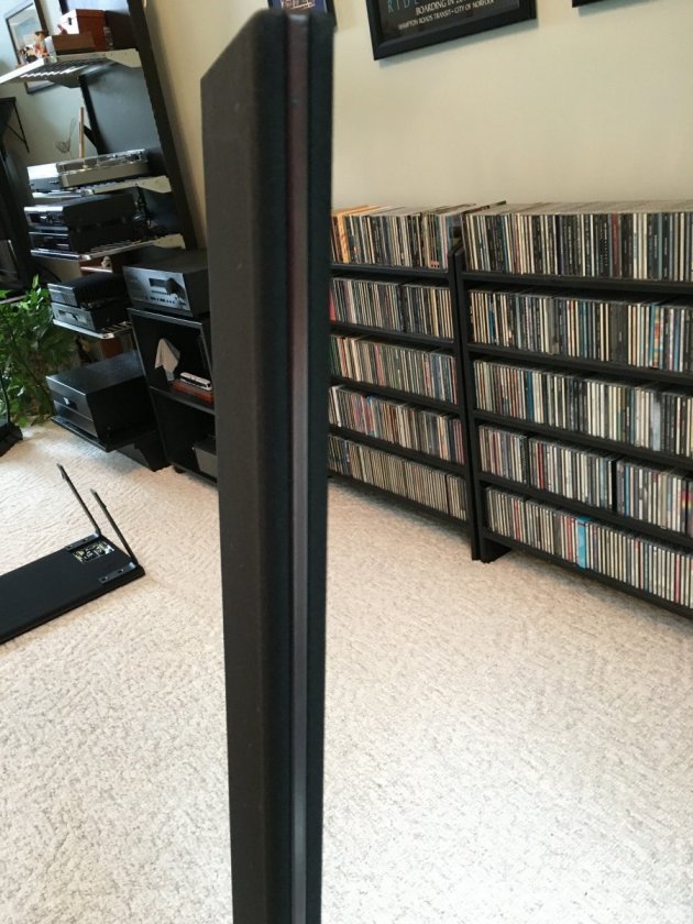

In case you're wondering what happened to the soundstage your left hand speaker could use some adjustment.
Saturn94
  • Posts: 1783
Re: Magnepan LRS, how to disassemble?
« Reply #10 on: 23 Dec 2020, 11:24 pm »
So that’s what was wrong!  :slap: :rotflmao:
It’s been corrected.  :thumb:

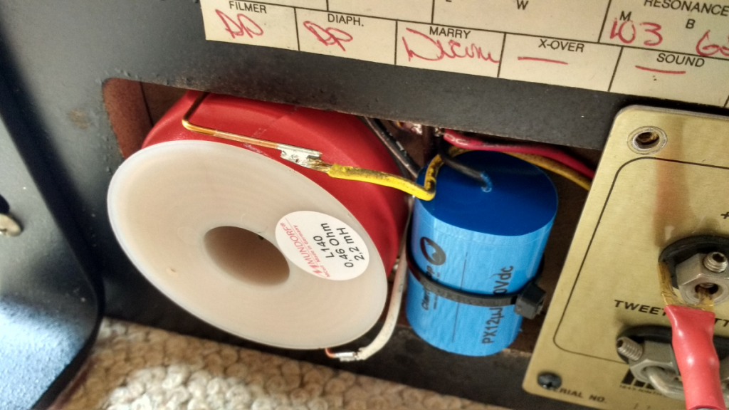

To the OP, while replacing the inductors, I'd also replace the ClarityCap PX caps, used on the tweeters.  I like ClarityCaps, and have used them for my own speakers, but they are a bit dark, for tweeter use.  For me, very reticent in the upper mids, lower treble.  Personally, I usually use Mundorf for the highs.
