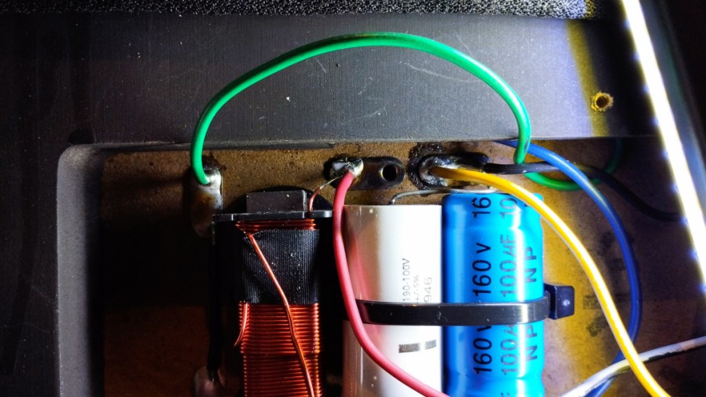

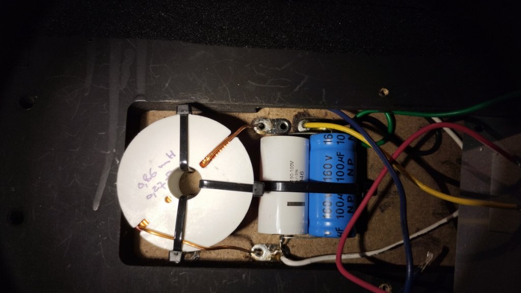

Teaser! Before...
After...
Just did the first speaker. Today/tomorrow the other one.
Paul

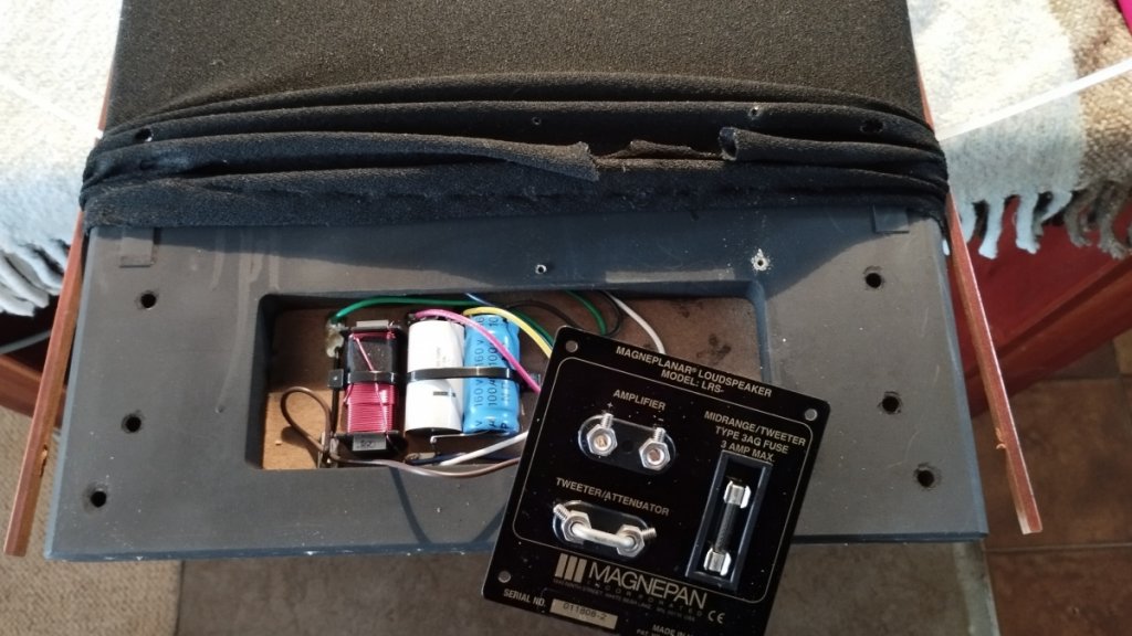

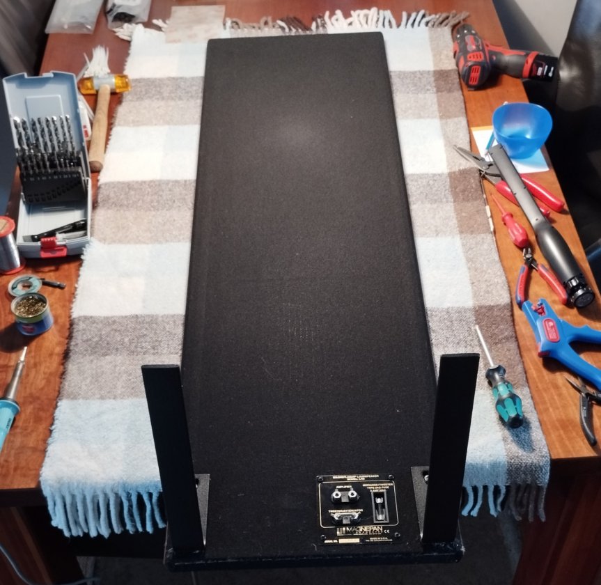

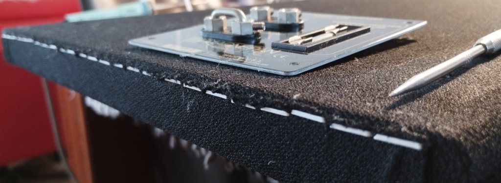

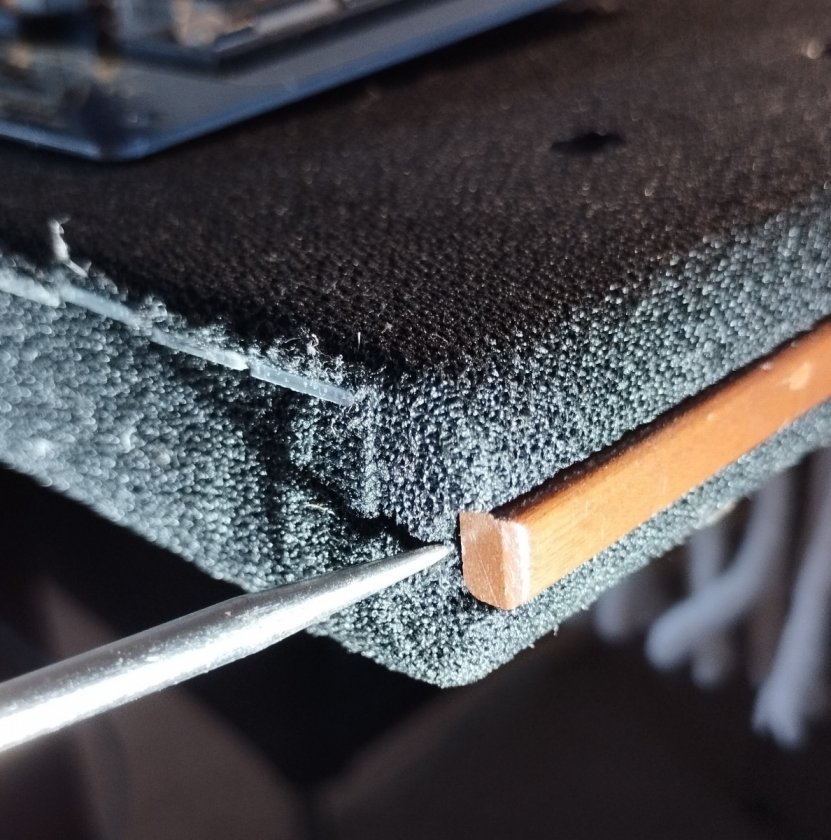

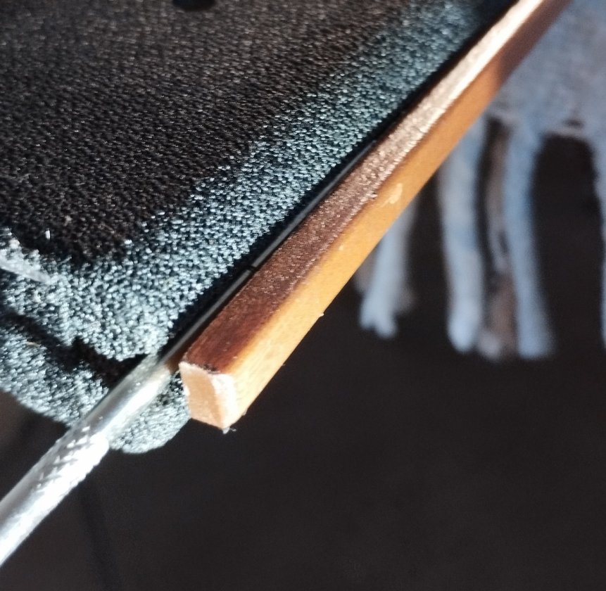

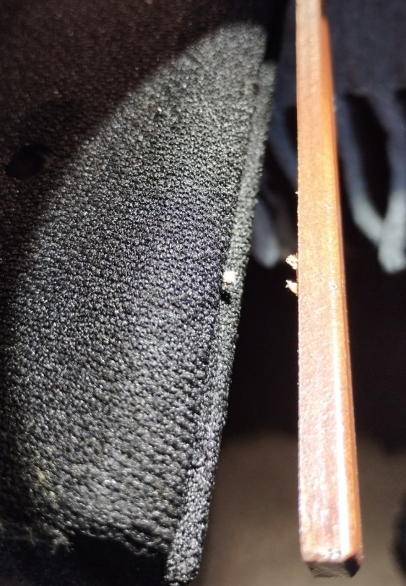

The disassembly starts:

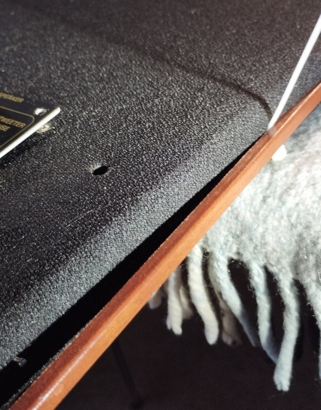

Remove the stands and screws. Remove the screws of the entry plate:

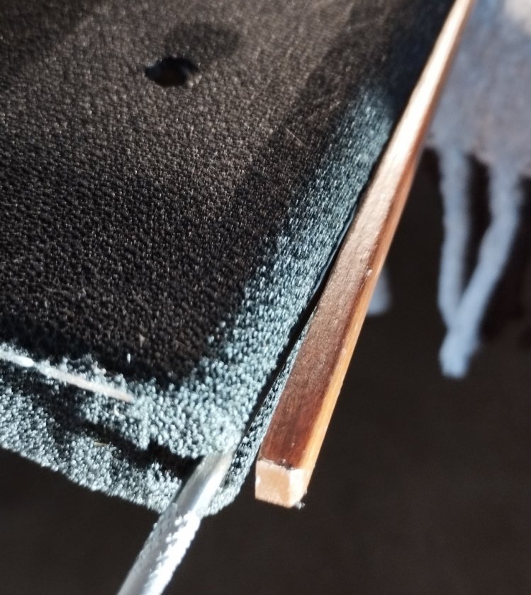

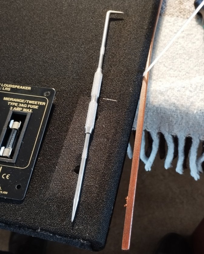

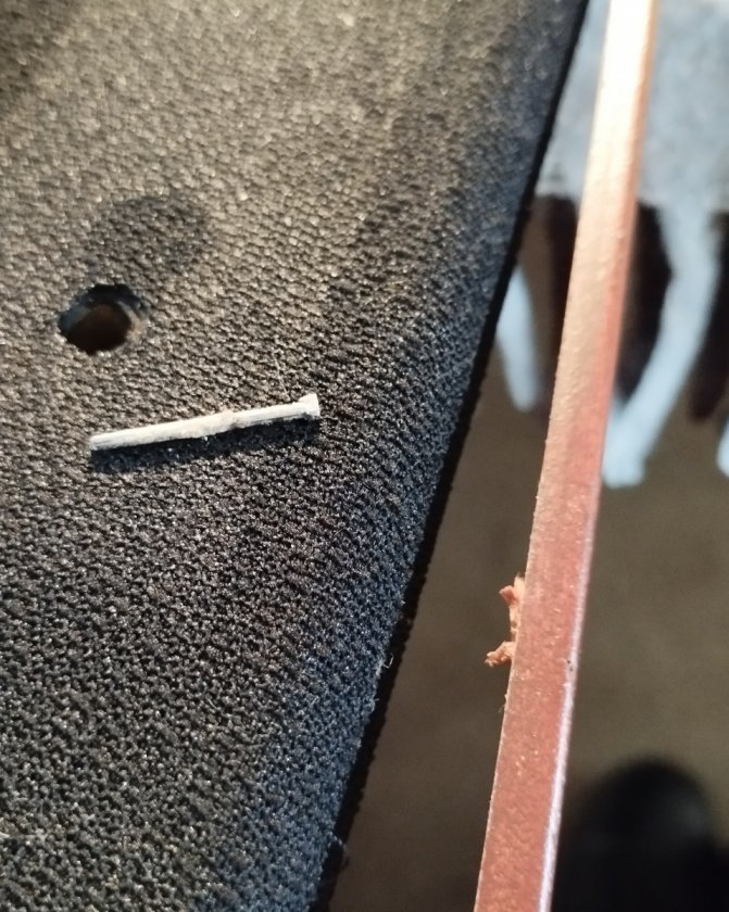

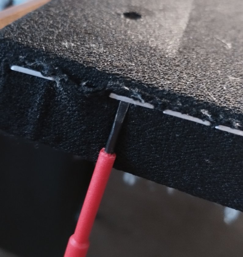

Use a scriber and carefully insert it between wooden strip and cloth until the strip comes loose. The strip is held in place with headless nails. When the strip comes loose you will see the nail stick in the cabinet. Pull the nail out with pliers. Then I used a tie-wrap to keep the strip bent out.

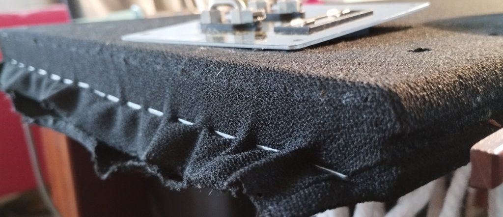

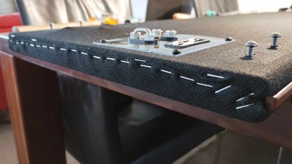

Now remove 2 rows of staples:

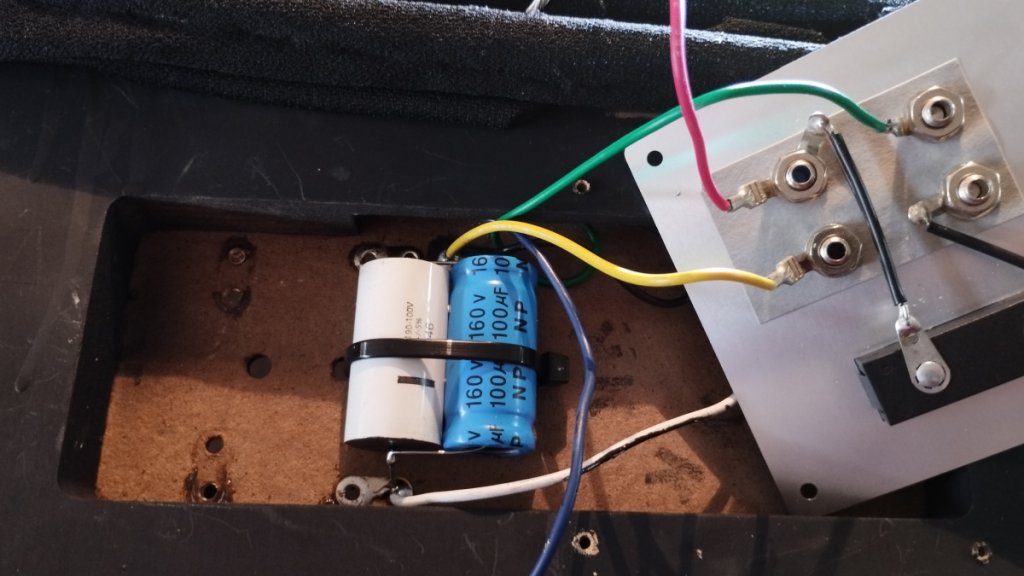

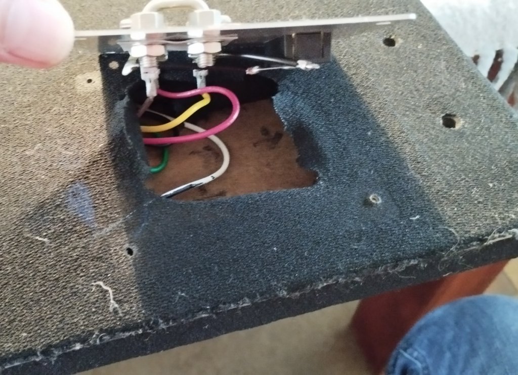

Shove the cloth up so that it exposes the crossover parts:

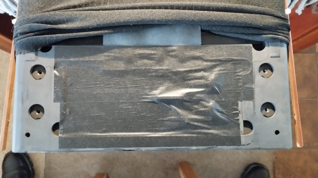

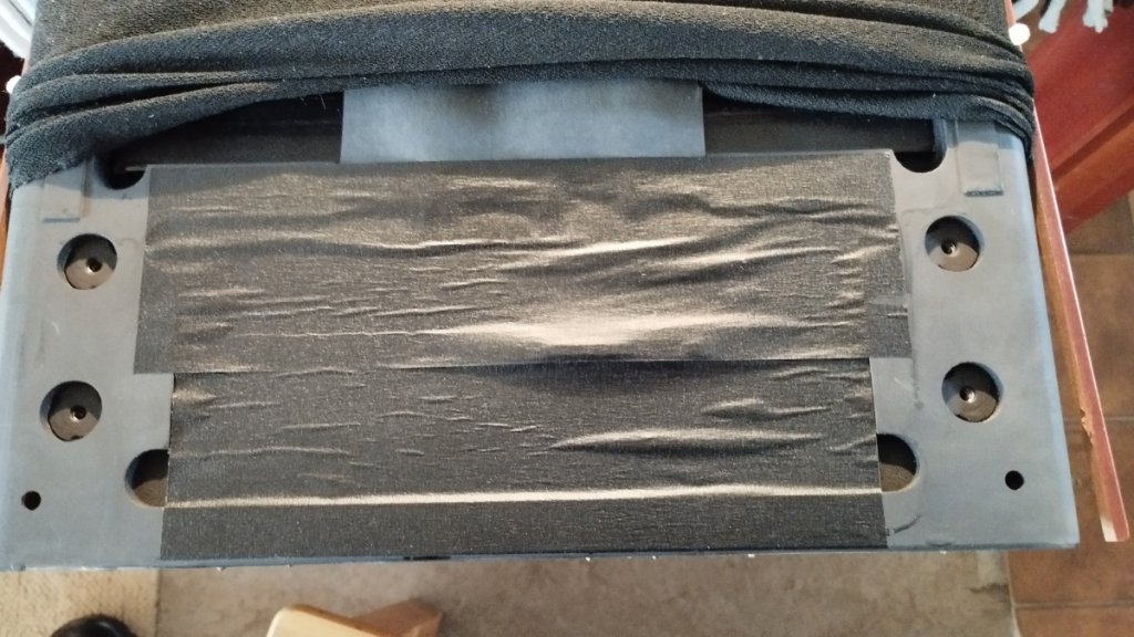

Turn over the LRS so you see this:

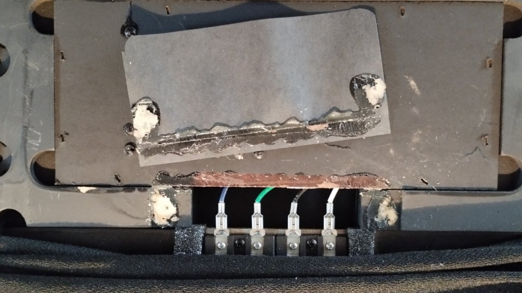

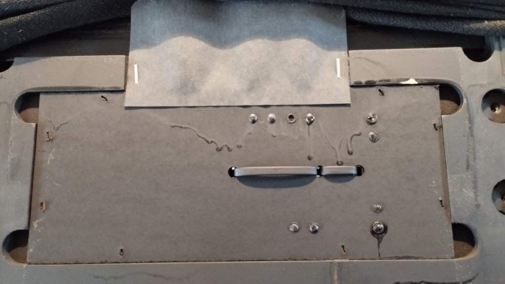

Remove the tape and cardboard piece carefully so that you can reuse them afterwards:

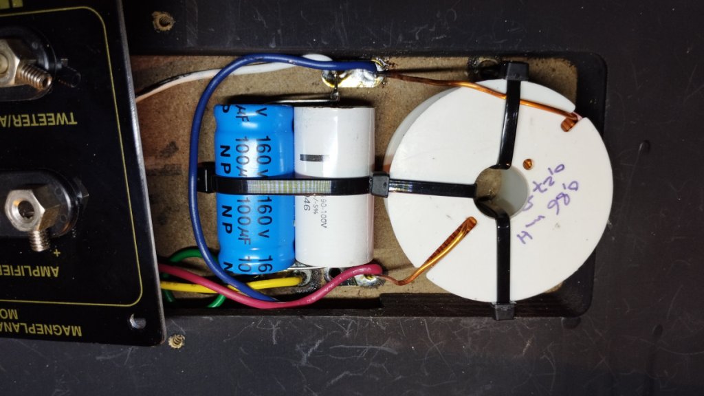

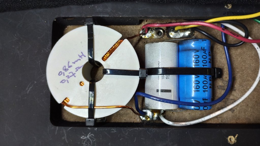

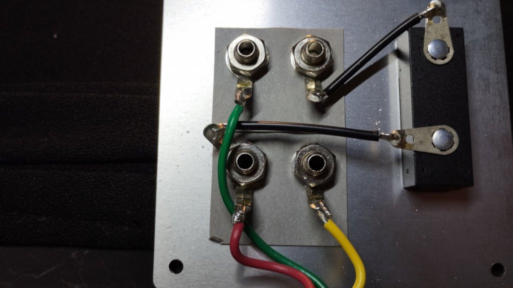

Turn the LRS over again so that you can access the crossover. Desolder the coil and wires and clean up the solder lugs. I also removed the brown wire and soldered the green wire directly to the connector plate. Place the coil and use tie-wraps to mount it. Resolder all the wires and coils. Notice that I got rid of the faston connectors and soldered the wires directly to the connector.
Now it's time to reassemble. Place tape and card board and start stapling. Mount connector plate and feet.
The wooden strips can be tapped back in their groove and stay put without using nails.
Done! Enjoy listening your LRS's.

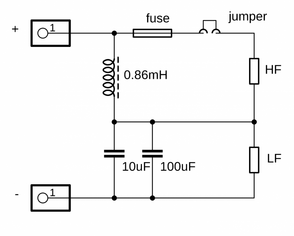

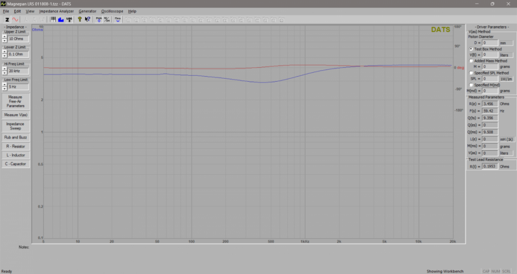

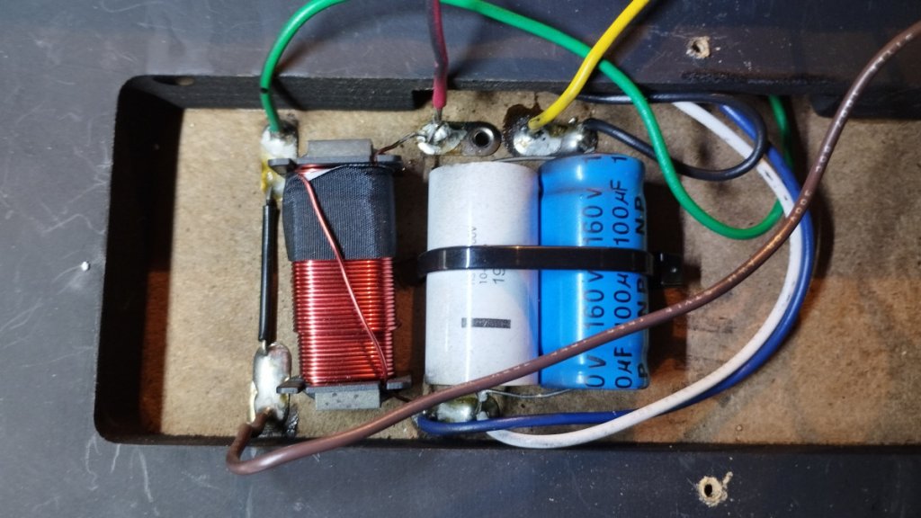

This is the Magnepan LRS crossover:

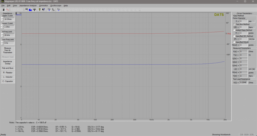

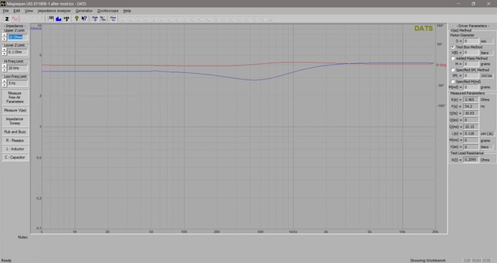

Below are 2 impedance/phase plots [stock and after the coil mod]:
Identical as you can see.

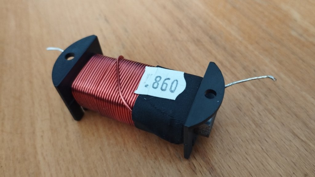

With respect to the new coils: I purchased 2pcs https://www.mundorf.com/audio/en/shop/coils/air_coils/mcoil_l/MCoil-L140-AirCore/?card=5106. These have a value of 1.0mH. So, using the DATS V3 tool, I unwinded about 14-15 turns of each coil such that I ended up with 0.86mH /0.27 ohm coils.
The original stock coils measured to be 0.88mH / 0.26 ohm.
Here is a picture of the original coil:

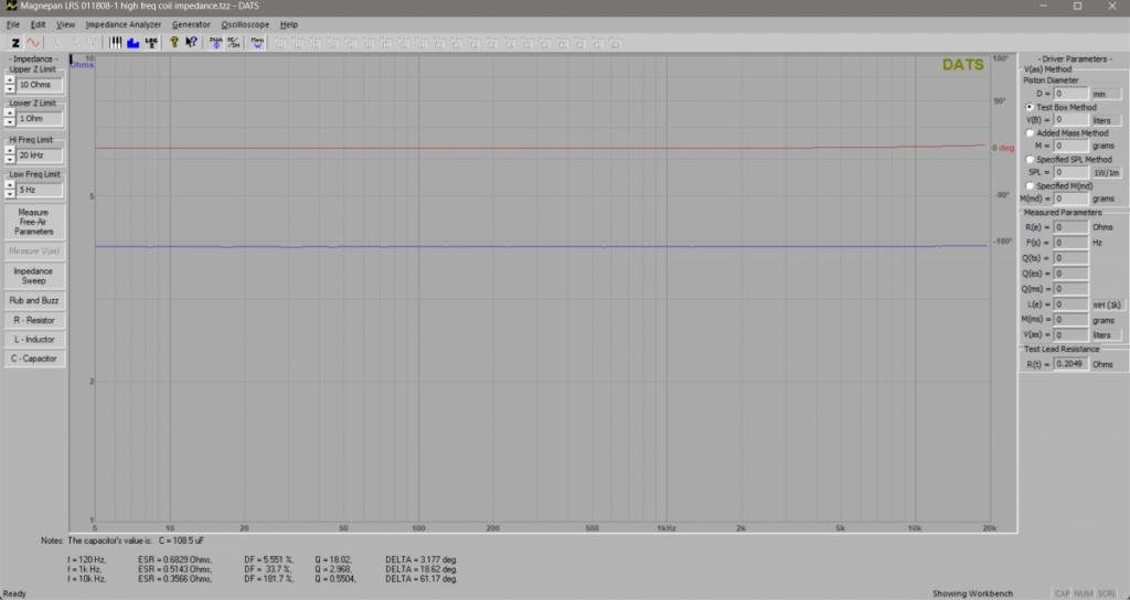

In case you're interested, here are the impedance/phase plots of the individual LRS drivers.
Low frequency driver:
High frequency driver:
Paul
