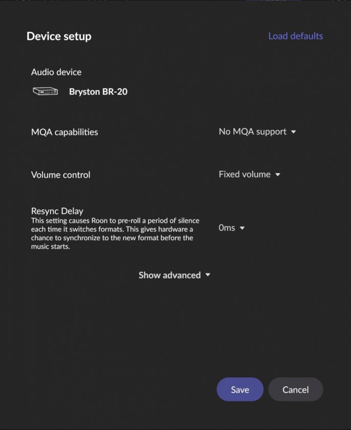

« Reply #597 on: 4 Feb 2023, 06:26 pm »
I am still having problems with volume when using the BR-20 with Roon.  I thought the last software update fixed the problem, but that is not the case.
Yesterday I had a situation where I could not control the volume with either Room Remote or using the volume knob on the BR-20.  The volume just kept increasing.  This is a dangerous situation for both ones ears and speakers.   I have the volume limited in Roon because of this.
This is a serious bug.  I hope Bryston is working on it.
James Tanner
  • Posts: 21007
  • The Demo is Everything!
    • http://www.bryston.com
Re: Announcing The Bryston BR-20 Preamp/DAC/Streamer
« Reply #598 on: 4 Feb 2023, 06:44 pm »
Make sure in ROON you have FIXED VOLUME selected and NOT Device Volume.
You want fixed volume because when you use the device volume you are loosing BITs as you reduce the volume.
Always use the BR20 remote volume control unit to adjust level never the sliding device control.

« Reply #599 on: 11 Feb 2023, 11:22 am »
Thanks for that James.
I have been running my BDA 3.14 that way with fixed volume for that very reason since I got it. However, when it came to my BR-20 I just stuck with the defaults and assumed that the volume control was done in the Preamp portion rather than the DAC simply as the volume knob and display went up and down at the same time.
Regards
