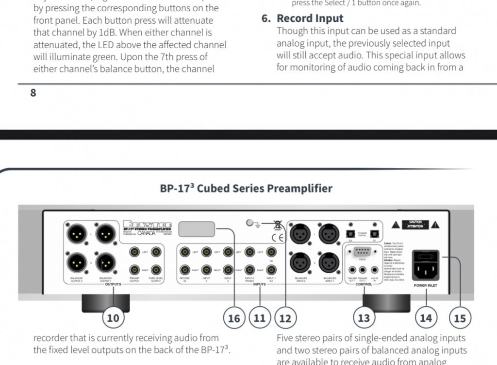

Re: Announcing The Bryston BR-20 Preamp/DAC/Streamer
« Reply #119 on: 13 Feb 2021, 12:59 pm »
The BP-17 cubed has:
Record Input
Though this input can be used as a standard analog input, the previously selected input will still accept audio. This special input allows for monitoring of audio coming back in from a recorder that is currently receiving audio from the fixed level outputs on the back of the BP-173.
That is where I currently connect my reel.
