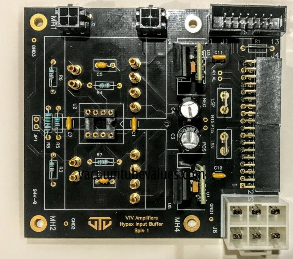

I was poking around his website the other day and looked at the input buffer boards.
https://vacuumtubevalues.com/product/vtv-amplifier-custom-input-buffer-hypex-nc500-nc1200-nc2k/
Take a close look at the photograph of the buffer board.  The soldering workmanship is absolutely horrible.  Problems waiting to happen on every connection.
What is the deal with this guy and his assembly practices?
Dave.

Davey
  • Posts: 1481
Re: VTV Amplifier - Hypex and Purifi Amps
« Reply #5 on: 24 Aug 2020, 02:57 am »
The photo I attached is smaller, but if you go to his website and hover of the photograph with your mouse you can see the full image.
This is horrid workmanship.  Maybe it's a prototype and not representative of the final product, but if I were him I would take that photo down regardless.
At this point, I'm starting to agree with the fella on ASR that had the bad experience.  :)
I would certainly not purchase anything from VTV myself.
Dave.

Dave,
Thanks for posting the link. I think I had seen that pic before but didn't realize that hovering my cursor over the picture would give me a blown up view.
It is indeed poor soldering on this board that accepts input buffer modules. I agree that VTV should be contacted to alert them of this. In any case, there are competitors to this including Neurochrome/Tom Christiansen's excellent custom input buffer module. Not only is that thing soldered in a 13 zone SMD oven, but each one is tested extensively and there are measurements to prove that it will never be an impediment to either the NC500 or Purifi1ET400A. That's what I like and want. That's what should be demanded by the public. Extreme sonic quality and extreme reliability guaranteed.

Thank you for the comments on the VTV buffer.  A few things:
--all soldered connections are on the backside of the board (obverse of photo)
--each board is tested thoroughly
--the board has a track record of many sold both in new amplifier builds as an option and as a standalone board for enthusiasts looking to upgrade the stock buffer.  It is very reliable and I stand behind everything I sell.
--most customers report a significant improvement over the stock buffer.  This holds for every opamp selection.
--I have added a two pin header and jumper so that user can adjust the gain without solder.
--I am in Lakewood OH, a suburb of Cleveland and am accessible by email or phone if you prefer.
Thanks!

Davey
  • Posts: 1481
« Reply #13 on: 24 Aug 2020, 04:34 pm »
Obviously.
The solder connections are still poor.  Good plated-through holes should show good wetting on both sides with a proper soldering technique.  Some of the holes/connections are clearly contaminated and possibly cold.
I suspect one issue is you're using "audiophile" solder vice proper SN63 with decent RMA flux to make these connections.
Dave.

Obviously.
Dave.
I would strongly recommend the use of flux for all the through holes, a temperature controlled soldering iron, adequate temperature (you should know the melting point of your chosen solder) and finally a thorough cleaning of said board. I agree with Dave, there are several cold soldering joints that I can see on that board and both sides of the board need to be addressed.
Sorry to sound obtuse! Not trying to be mean!
Best,
Anand.
vtv
  • Posts: 3
« Reply #15 on: 24 Aug 2020, 05:28 pm »
Appreciate the comments, that board is soldered with Mundorf lead free, rosin core.  It has a very dull look to it.  I have since switched to Indium and use flux and thoroughly wash the boards.  They appear much better.
CurtisIIX
« Reply #16 on: 24 Aug 2020, 09:00 pm »
NASA wants 100% PTH fill. Other industries will consider less than 75% fill a defect only for Class 2 and Class 3 assembly.
I don't think you can properly evaluate the PTH fill from the posted image. AOI, in-circuit test, and/or X-ray will tell you if a defect exists.
