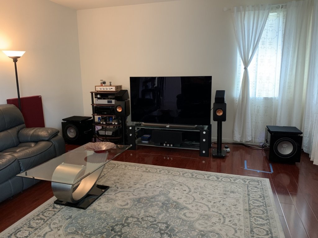

Bought a “Refurb” Denon 4500h from A4L a while back. Use the pre outs to either Odyssey or a Custom Folsom Chip amp. Not as good of a sound as when I use my ModWright LS100 for critical listening, but a whole heck of a lot more convenient 99%+ of the time. DirecTV, ModWright OPPO 205 (HDMI & Analog), Roku, Chromestick, Firestick, and iPad/Computer (WiFI) all connected to the Denon. Between the DirecTV remote and the iPad, I can control virtually every function and source.
Wife can just use DirecTV Remote for ease.
I have a “problematic” room that is the limiting factor for true max performance (even with extensive Room Treatment). Convinced I can‘t get much more out of this system until/unless I move. So I can minimize a few room issues with Audyssey at the cost of less performance on the Pre amp side. It’s a trade-off that I will put up with for the sake of convenience and Family harmony.
