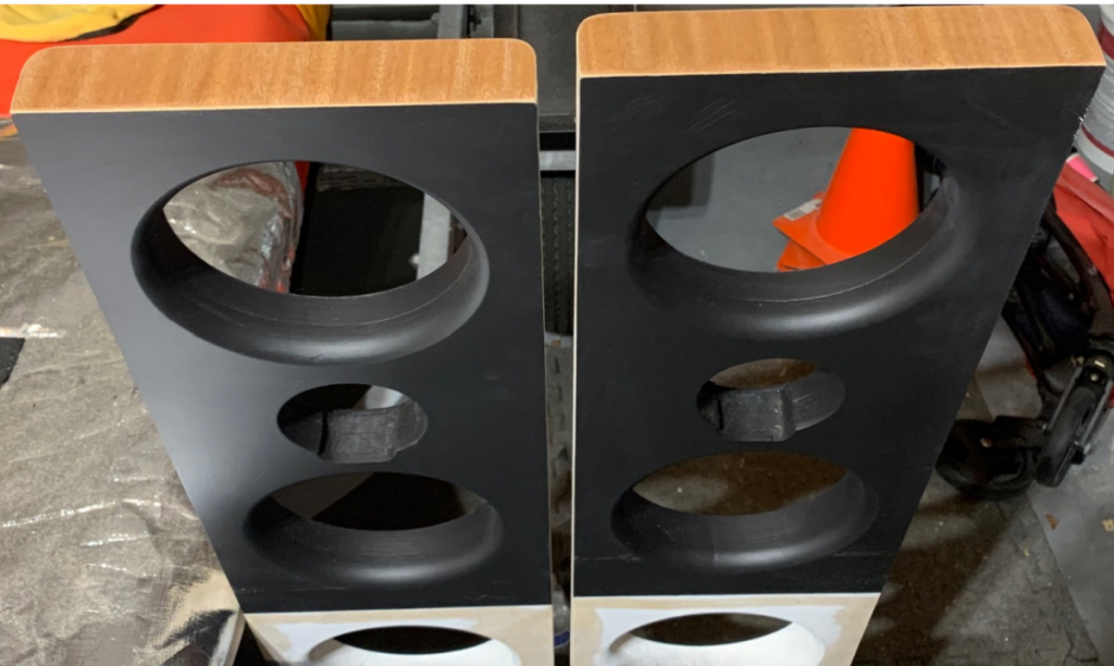

Mike - apologies, I must sound like an idiot, but is it possible to explain or show a picture of what you mean by roundover here? I've never built these and I can see on the plan that the backside of the woofer hole needs at least 3/8 radius or round over.
Maybe it'll make sense once I have the woofer and can look at it.
For reference, this is the back side of my X-Static baffles.
mlundy57
  • Posts: 3643
Re: Mike Lundy's X-LS Encore build
« Reply #11 on: 7 Jul 2020, 06:43 pm »
While the plans don’t call for a roundover on the outside of the front baffle, sharp corners can cause reflection issues so I usually put at least a 3/8” roundover on the vertical edges of the front baffle.
My earlier description wasn’t really clear on this. You pretty much want the size of the roundover to match the thickness of the hardwood. What you are trying to accomplish is have the roundover end at the seam betweenthe front baffle and the side. This makes a nice clean transition.
If the overall width of the finished baffle is more than what the plans call for, it will affect the baffle step loss. The roundovers mitigate this by reducing the effective width of the baffles. If the width is a little bit off you should be OK.
As you can see, using this technique requires some up front planning and attention to detail on how you need to modify the plans and/or edge profile to end up with proper dimensions both internally and externally.

Thanks for the comprehensive information Mike - things are starting to make a bit more sense for a beginner like me. Part of what I didn't realise is the plans is that the radius is the radius of the round-over, so I'll make sure that it gets done an the back of the woofer.
Is my understanding correct that you are talking about the outside facing vertical of the front-baffle? I would never have imagined that this could affect the sound - I would have assumed that the enclosed parts affect it more so just want to make sure.
