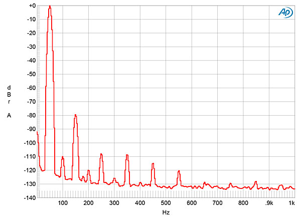

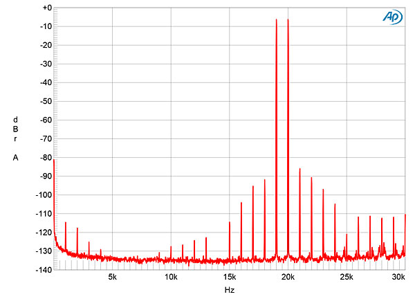

I have commented this several times already. I am still waiting for a reply to the email I sent to PS Audio.
They screwed up the IcePower 700ASC class D module's specs with its own buffer. From having no harmonics to being dominant H3.
Forget PS Audio M700.
https://www.stereophile.com/content/ps-audio-stellar-m700-monoblock-power-amplifier-measurements

They did it intentionally to "flavor" the sound, maty. They've openly said this was the point of the buffer. This is probably why they never responded to you. They're not hiding anything. With the addition of the buffer, their amps will sound unique in comparison to amplifiers using just the off-the-shelf ICE modules. Also, we all know that measurements do not tell the whole story regarding how any amplifier will sound. One has to listen and judge if the measured distortions are good or bad to their ears. If you don't like what PS Audio has done, just go buy one of the many other options on the market that simply use the off-the-shelf parts. I'm not sure what your point is.
maty
Re: AVA Vision SET 400 vs PS Audio M700 mono-blocks?
« Reply #9 on: 12 Jun 2020, 03:08 pm »
You can "flavour" the amp with dominant H2, the question is how much H2, -73 dB? Never intentionally dominant H3.
That's true. Odd order harmonics are usually not pleasing to our ears. What's important is the magnitude of H2 or H3 relative to THD and at what frequencies is it prevalent, right? Our ears are more sensitive to some frequencies than others. Reviewers have commented that the M700's have a very clean, neutral, and smooth sound with a hint of warmth. This would suggest that the H3 present in the measurements doesn't tell the whole story regarding the amp's subjective performance. Always 2 sides to every coin.
