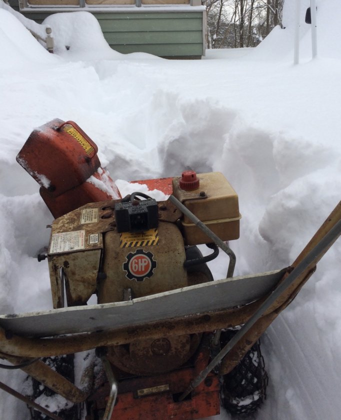

My 47+ year old snowblower doing the job :green:

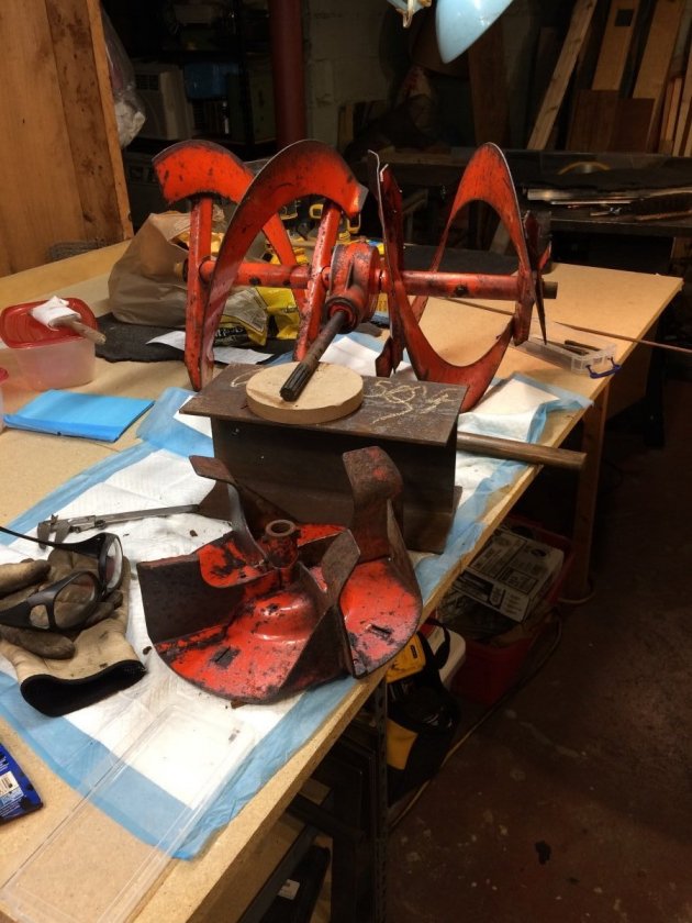

But snow removal efforts on the third driveway I was helping with left me with having to do an emergency repair of the snowblower.  The triage pushed the speaker work off to the side while repairs were being made.
The tension pins that attach the impeller to its driveshaft have broken before because of wear and looseness of parts at this stage of its life.  You would think I would have spares...  Not that I could find, so a day lost while I waited for stores to reopen.  These pins are common hardware store parts so they are readily available, when the city hasn’t been shut down by a major snow storm... :roll:
Snow is now gone, as quickly as it came with the help of a heavy rain.

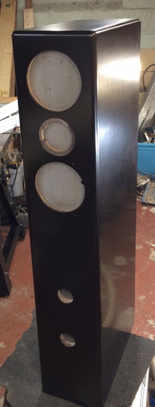

I went to work on the cabinet finish after cleaning up from the snow storm.

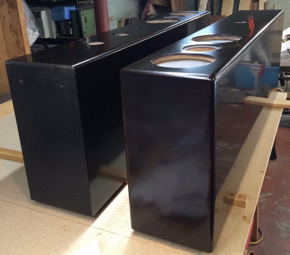

I am in awe of those who managed to put a piano finish on their builds as I found that I am far from being able to do that.
Doing the varnish finish on my cabinets turned out to be thee frustrating part of the whole build and I wasn’t even trying for a piano finish.
I used Minwax semi-gloss polyethylene varnish, which has done well by me before.  I even followed their recommendation to use a natural bristle brush and bought a new one.
Well, it didn’t do well by me this time.  Did they recently change their formulation?  This isn’t the first thing I have finished, and I don’t recall ever having the issues I had this time.  And this was a fresh/new can of varnish.  I am sure everyone has their favorite varnish, and I bet there are much better products than this.  Feel free to post your recommendations as I will need something better for the next speakers I build...
The first thing I ran into was literally that... Runs.  And sags on the vertical sides.  I thought I was putting it on thin enough, but no.   Also, some of this happened after the varnish started to set up so there was no fixing it without leaving brush marks. The next issue was with sanding.  They recommended 220 grit.  I knew that wasn’t right and used some 320.  It leveled out the drips and sags, but it also left scratch marks over the whole thing that OO steel wool would not remove.  320 grit was still not fine enough.
Then there was blending.  I had the cabinets laying on their backs with the fronts up.  On the fronts (horizontal) the varnish laid on nicely and leveled nicely.  I brought the fresh coat down the rounded corners so when I did the sides there would be some wet varnish to run into.  Oops... This little bit of wet varnish would setup on one side while I was applying varnish to the other side.  By the time I got to the second side I was leaving brush marks in that setup wet coat...
While the varnish on the front leveled well, bubbles that the brush left behind would not pop.  There was to much surface tension to the varnish for that to happen....  Ugh!
Lighting also played into this.  I found there is never enough light and it has to come from all angles.  But when it comes from all angles, it winds up shining in one’s eyes.  There is almost no winning with this one.  But over all, more light is better.  Several of the coats of varnish I put on had to be redone because of missed spots that I couldn’t see when I was applying the varnish.  More light, please!
After 5 coats of varnish, and :banghead:  -  I am done...  Good enough!
4 more, well placed, 3’ strips of LED work lights helped a lot.  This was in addition to the 2 I had and the 6 clamp-on lights I was using.  About 300W of LED lights in total.   :o  I worked most of the bubbles out by lightly dragging the brush through the coat.  I spent more time to spread the varnish thinner on the sides, but this wasn’t 100% successful.  I found a nice 400 grit sand paper and holder that worked well, along with the OO steel wool.  I worked with a wet brush to blend the side coat into the coat from the front that was setting up.  This all basically worked. The little bit of remaining brush marks, drips and runs will be unnoticeable where they speakers will be located.  I will just think of them as adding a bit of “character” to the cabinets; an artificial rendition of a wood grain finish.   :green:

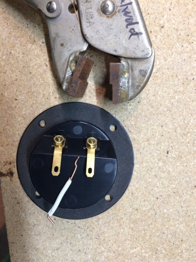

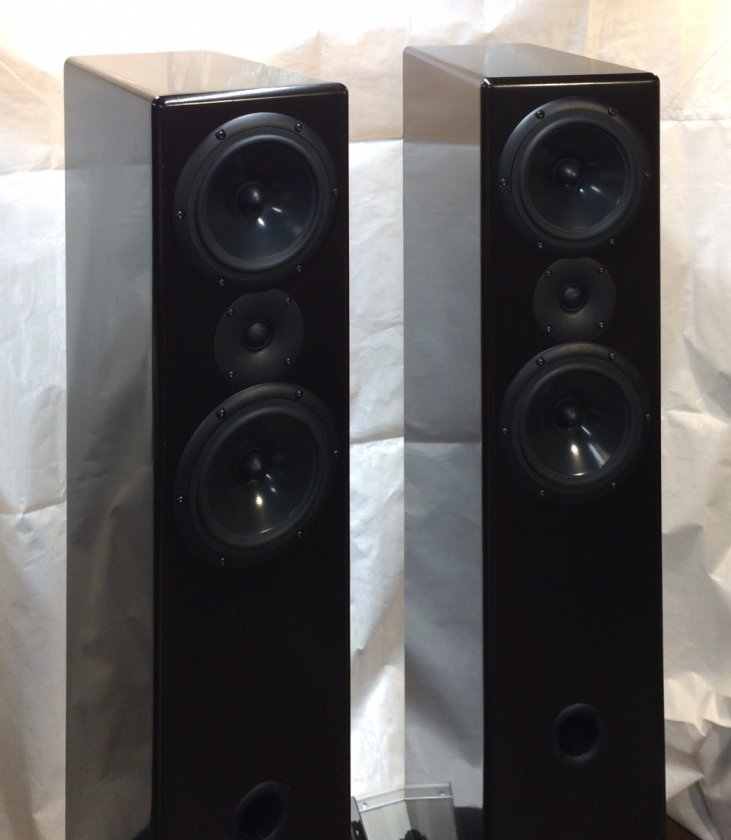

Wiring is done and the drivers are installed.  The only thing I did differently from what Danny recommends is I did pass the wire through the hole in the binding post tabl
I have a set of crimpers for sheet metal that I was able to use to put a kink in the wire so it would lay flat on the binding post tab for soldering.  I had to do this as my hands are no longer steady enough to hold the wire in place the way Danny shows, and, at the same time, hold the binding post and soldering iron.  I had the cabinets upright while wiring up the binding posts as I didn’t want to lay them down on the fronts that I had just spent so much time finishing and take a chance of damaging it.
For the drivers, I laid the cabinets down on their backs and had the driver resting on the fronts that were protected with a rubber sheet.  These were soldered just as Danny shows in his video, with the wire laid flat on the tab and not through the hole.
The hardest part of all of this was remembering to put the heat shrink tubing over the wire first..  :duh:  not that I forgot to do this at least twice... :shake:

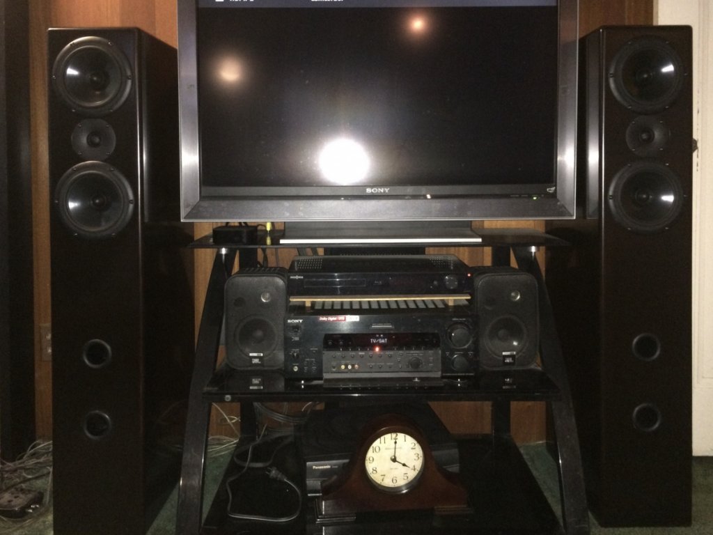

Finished
COMPLETED AND HOOKED UP
And how did they sound?
 :drums:
OMG!
AMAZING
I know that my ears are bad and I thought that was the cause for me not understanding words being spoke in TV show and in movies.  Well not any more.  Words are clear and distinct.
I got lost in listening to the 1995 recording of Cream at the Royal Albert Hall.  Jack Bruce’s and Eric Clapton’s voices are now clear not mumbling as I had thought.  Bass is solid and deep; much deeper than I expected.
In a mini concert by Nora Jones, that is done from a room in her home, I could hear the room coloring her voice.
There is a clarity and transparency to these speaker that is almost unnatural.
The base is solid and they play lower than I expected. Yes, I know what they are rated at, but I don’t know what that means when listening to them.   I would say, a subwoofer would be nice but not necessary.
These are what everyone said they would be...  :thumb:
