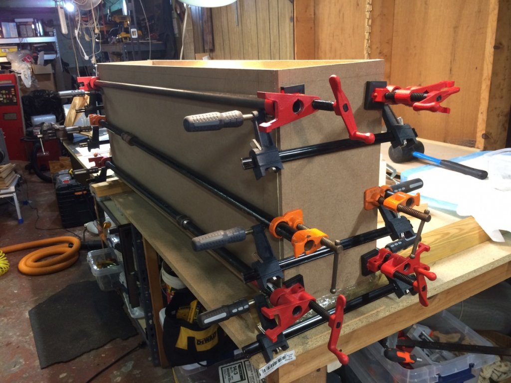

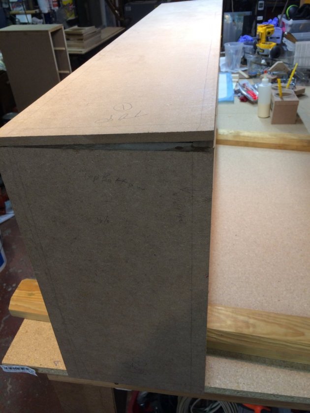

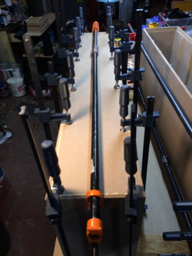

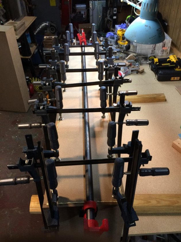

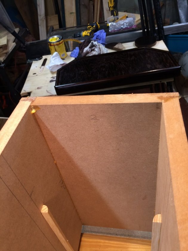

Gluing has started in earnest!   :dance:
And before I say anything more - A big thanks to Peter for the discussion about the glues.  The Titebond Original is the best for this.  The end “grain” of the MDF suck up moisture like crazy and I could see that the quicker drying glues being really difficult to work with for this part of the project.  The Original gave me the time I needed to spread the glue and to get things into place, without rushing.

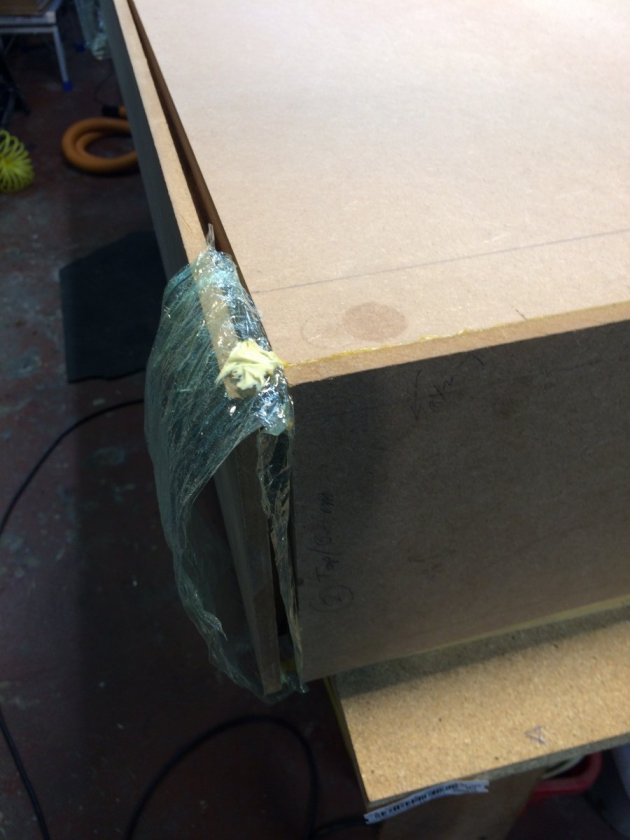

As I noted, I am gluing the cabinet in steps; the first being the top and bottom panels to the sides.   To ensure the fit up to the the front panel, I used the front panel as the “form” for gluing the sides, top and bottom.  I loosely wrapped the ends of the front panel with binding film and used an extra piece of wood to ensure it was loose enough to form around the rabbit cut.  I also made sure the film was not pinched between panels.  I did this after the panels were dry fit by lifting the panels at the end to be glued, as unit, and away from the front panel and the film.  Then set it all back in place. There are 2 layers of film and the material is stretchy enough to form nicely around the rabbit without taking up space.
In the dry fit up I traced the bottom and top panel outline onto the side panels so I would know how far to spread the glue on the side panels.
This is the side panel with glue on the ends and on the interior where it meets with the bottom/top panel.
I did the same tracing of the outline of the side panels onto the top/bottom panels where the rabbit cut is.  The top/bottom panels also had glue applied to the surfaces that will meet up with the side panels.  While this seems like a lot of glue, a lot gets sucked up by the MDF while getting the glue applied every it is needed.
I only glued one end at a time.  The other end was dry clamped to hold things together.  As noted prior, I modified clamps to act as rests for the long clamps.  These are used on the dry end so they are ready for clamping the glued ends.
With the side panels splayed outward a little, the end panel with glue on it slid easily into place.  I then put on the small clamps, lightly tightened.  Then came the long end clamps.
A mistake I made at this point was to not make sure the end panel was fully aligned with the side panels.  As a result one corner of the end panel was slightly higher than the corresponding corner of the side panel.  The pieces are off only slightly, but it could have been easily corrected if I had remembered to check it before fully tightening the clamps.  I had seen this in the dry fitups and just forgot to check.  Once the clamps where tightened, it was game over for realigning things.
I also didn’t like the amount I needed to tighten the clamps and concluded I needed another level of clamps.  Here I am gluing the other end of the cabinet with 3 sets of clamps.
Is there such a thing as too many clamps...  :lol:

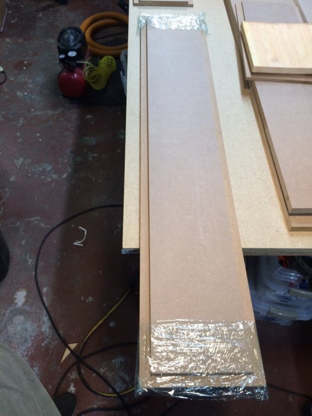

It seems that the MDF is flexible enough that it works well to have the clamps only 6 to 8 inches apart.  Not sure if others found this, but for me it took a lot less tightening of the clamps to get the glued pieces in place.
The binding film worked well and the front was easily removed once the glue had set over night.
And this is the end showing where the glue drizzled down on the binding film.
I did try to clean up the wet glue, but I was unable to clean if off adequately.  On the outside, the clamps are in the way and on the inside it doesn’t matter.  Where it shows up in the rabbited area, the dried glue is easily removed with a chisel.

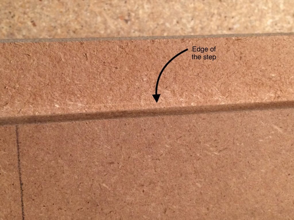

Another thing I found was a slight step in the rabbited area.  It is barely visible at the end of the arrow.
This occurred because the saw height was slightly low when I did the trim cut.  I had first routed the panel and then did a trim cut on the table saw.  I didn’t realize when I first noticed it, way back when, that it would interfere with assembly.  It did.  Easy to clean up with the chisel...

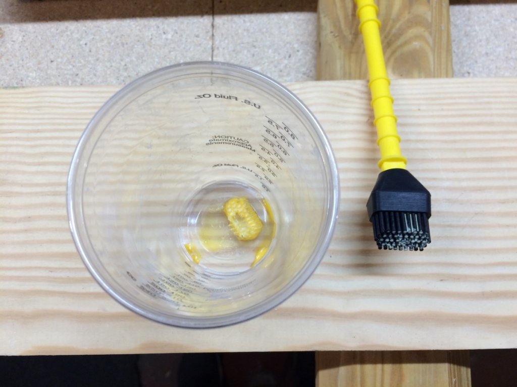

I am a big fan of these silicon rubber gluing brushes.  This was the result of not cleaning the brush and cup while the glue was still wet, and leaving it to setup over night..  :duh:
They cleaned up easily, anyway...   :P
As it is, they work really well for me for spreading the glue.

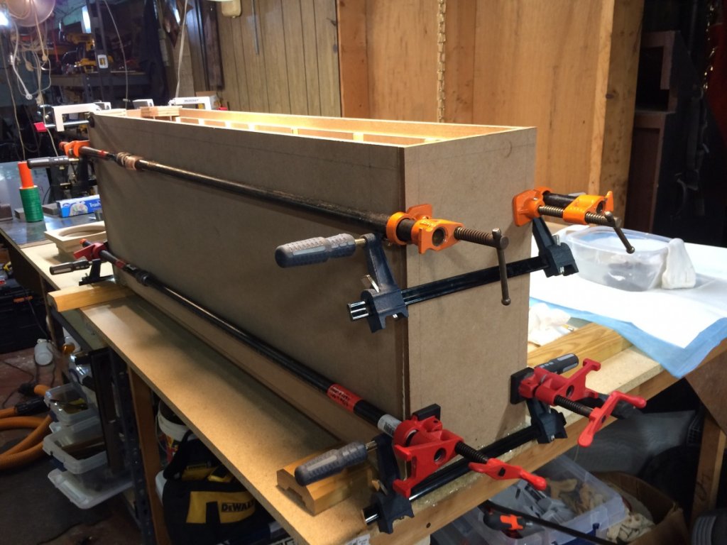

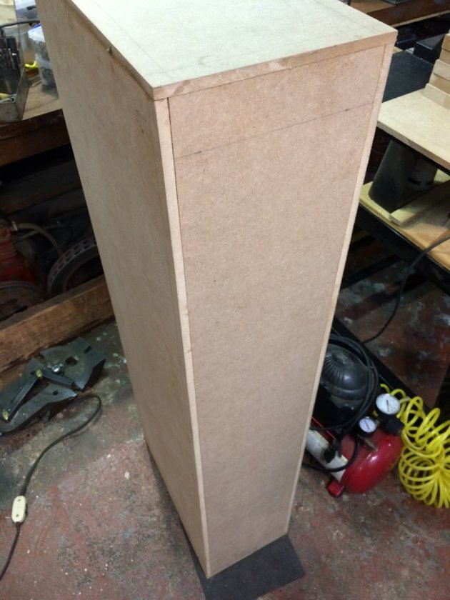

With the sides, tops and bottoms glued together on both cabinets, and having removed the fronts, I test fit the back panels.  On cabinet 2 the back fit into place with little effort and the resulting gluing proved to be as square as the back.  The back is a simple rectangle and cut as square as possible with the tools I have.  It fit with no flex of the sides, top or bottom.
I had similar results with refitting the front on cabinet 2 as well.
Unfortunately, the cabinet 1 came together a bit smaller and the back, front and internal braces would need slight trimming.  When I say slight, I could detect no significant different in their size.  But, clearly cabinet 1 was a hair smaller then 2.  It took only mils of trimming the other pieces to make them fit.
With glue applied to both the rabbited area on the sides, top and bottom and to the edges of the back...
Gluing of the back to the sides, top and bottom was simple enough, with the back slipping into place.  However, I forgot the side clamps on cabinet 2..  :duh:
After trimming the back for cabinet 1, the back fit easily into place and I remembered the clamps
Once again the Titebond Original proved to be the right choice here, given the time it took to spread the glue.

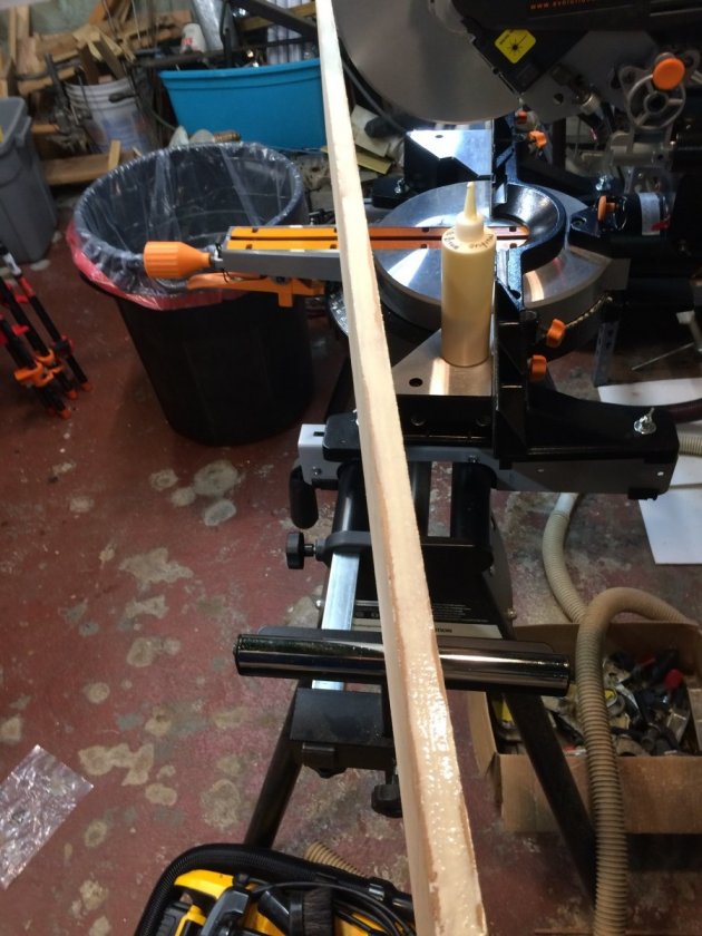

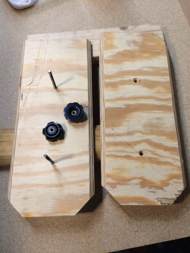

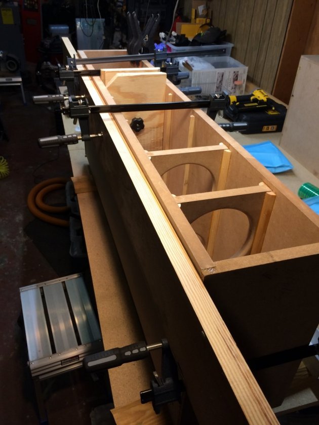

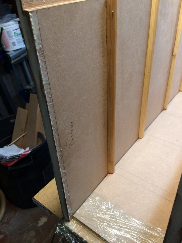

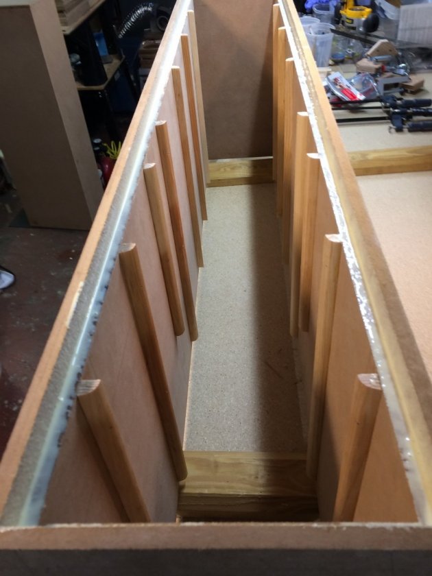

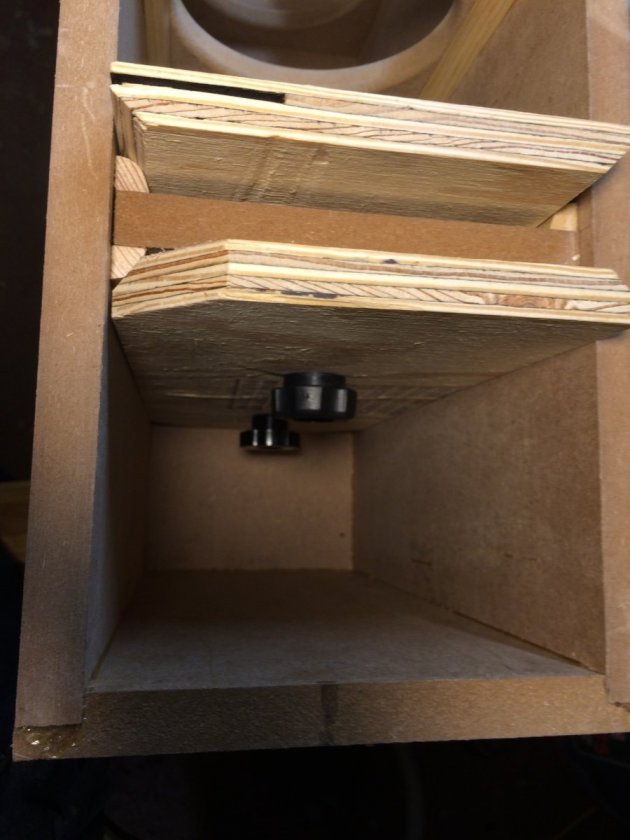

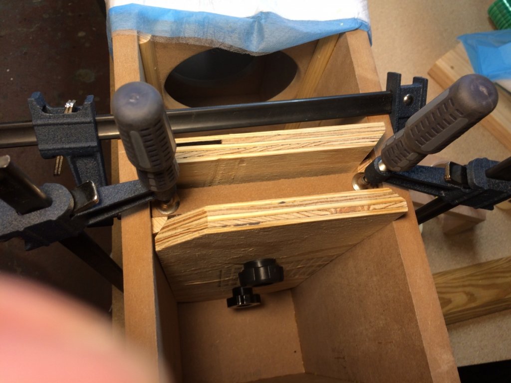

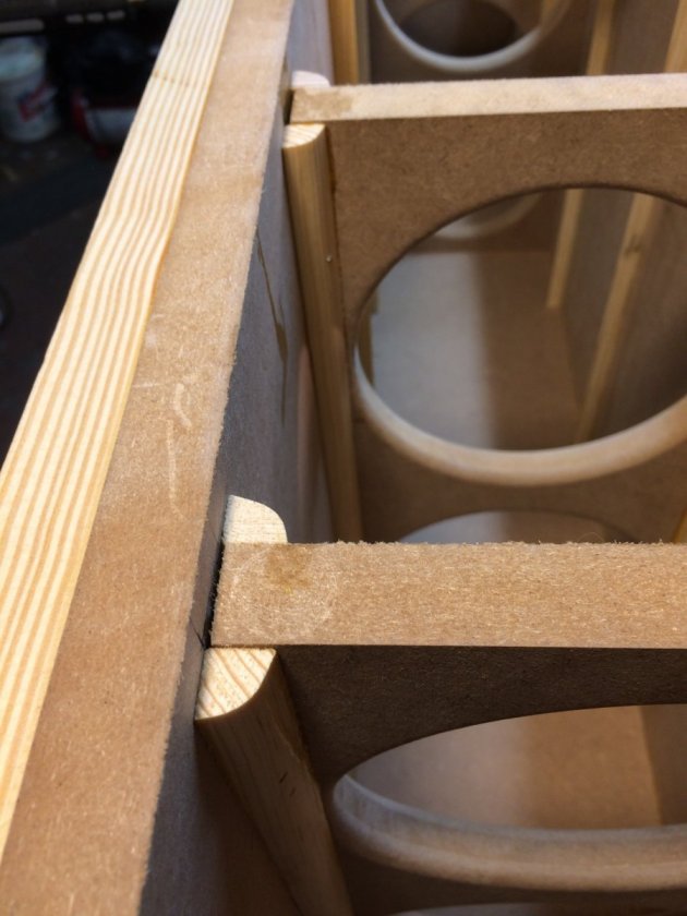

Braces have gone into both cabinets.  I whipped up a clamp to hold them in place while the glue setup.
A couple of pieces of 3/4” plywood cut with bevels on the long edges to push into the quarter round pieces, which, in turn, pushes the brace up against the already installed quarter round.

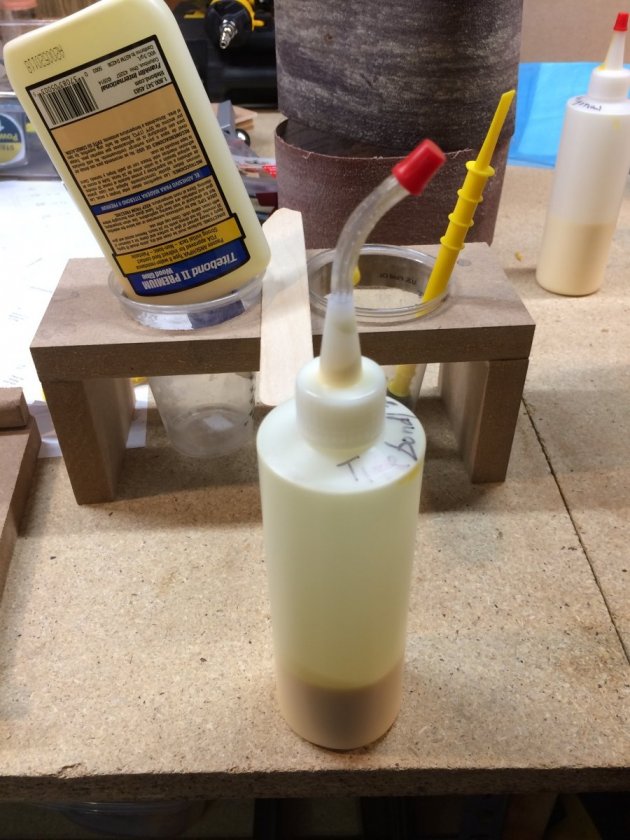

A slight modification of a glue bottle was made to facilitate spreading the glue...
I once again found the Titebond II worked for this as there was done with the sides vertical and the Titebond II was thick enough to not run much.  However, it does set quickly when the pieces are pressed together.  This made clamping a bit difficult.
This was my first attempt, but I found that the side clamp didn’t work well when it was put on after the brace clamp was tightened.  The brace clamp being tightened was enough to keep the brace or the sides from moving at all with the clamps.  This meant that the clamps couldn’t push pieces into place.   A different order to the sequence of assembly steps was needed.
With a little experimentation I found that if I slid the brace in place and pushed down on it and pressed it into the already installed quarter round pieces, that it would stay in place nicely while glue was spread for the second set of quarter round pieces and they were then pressed into place.  After that, the side clamp needed to be installed to draw in the sides and hold them for the installation of the brace clamp.
I am not sure of the brace clamp pushed the sides out or if the sides warped a bit with time (if think the former), but I found that the sides were bowed slightly.  Unfortunately I found this after the glue had setup on the 1st two braces I installed...  :duh:   :nono:
Either way, I found that it was important to clamp the sides and draw them inward prior to installing the braces clamp.
None the less, the first cabinet has sight bow to the side.  I was able to mitigate it to some extent on that cabinet by installing a series of camps along the side, with a 5/4 board on the straight side, before I glued in the remaining braces.
The results are good enough on that cabinet that the front still fits and there is still excess to trim off.  No planned rework.
For the second cabinet, I took greater care with the gluing process to mitigate bowing of the sides and to correct any warping that may have occurred.  This was done simply by snugging up a side to side clamp just after the brace was pushed into place in the glue.
Overall, I am pleased with the easy with which the braces went in.  The quarter rounds went in easily and served their function well.  I don’t very often have a block of time to spend doing a group of steps all at once on this.  With this way of doing the assembly I was able to take some time doing it and, if I wanted or needed to, I could do just one brace at a time and leave it.  This was my hope when I first thought of doing the assembly this way.  Thanks to Peter R for his helpful suggestion as to some of the assembly steps I used.
I did not expect or anticipated the bowing of the sides.  This occurred on both cabinets, although to a much lesser extent on the second because of the care I took to clamp each brace.  This may have been a result of the brace clamp I made and the bevel that pushed the quarter round into the sides.
So, I give this part of the assemble a 7 out of 10 rating.  It was successful for what I wanted, but it came with a bit of an issue.  Since starting this process I have come access a thread of a build of these speakers and that person used a different assembly process for the braces that involves using just butt joints (https://www.audiocircle.com/index.php?topic=164591.0).  I have seen butt joints used elsewhere, early on, but at the time thought they would not work for me.  However, with the experience I have gained and having seen this other build I think I can make them work for me.  In particular, what I saw would allow me to do one at a time, if I need to, and it would still simplify the build for me.  Something for my next project.  :D

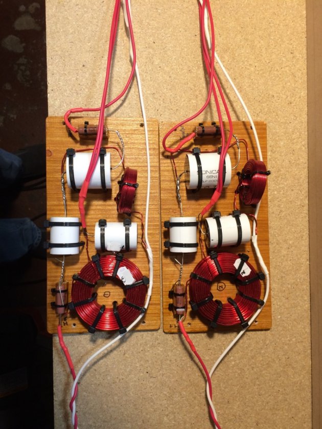

Danny has made a video about assembling the crossover.

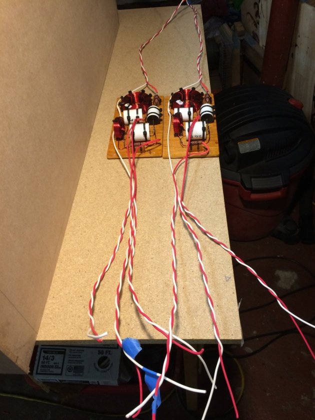

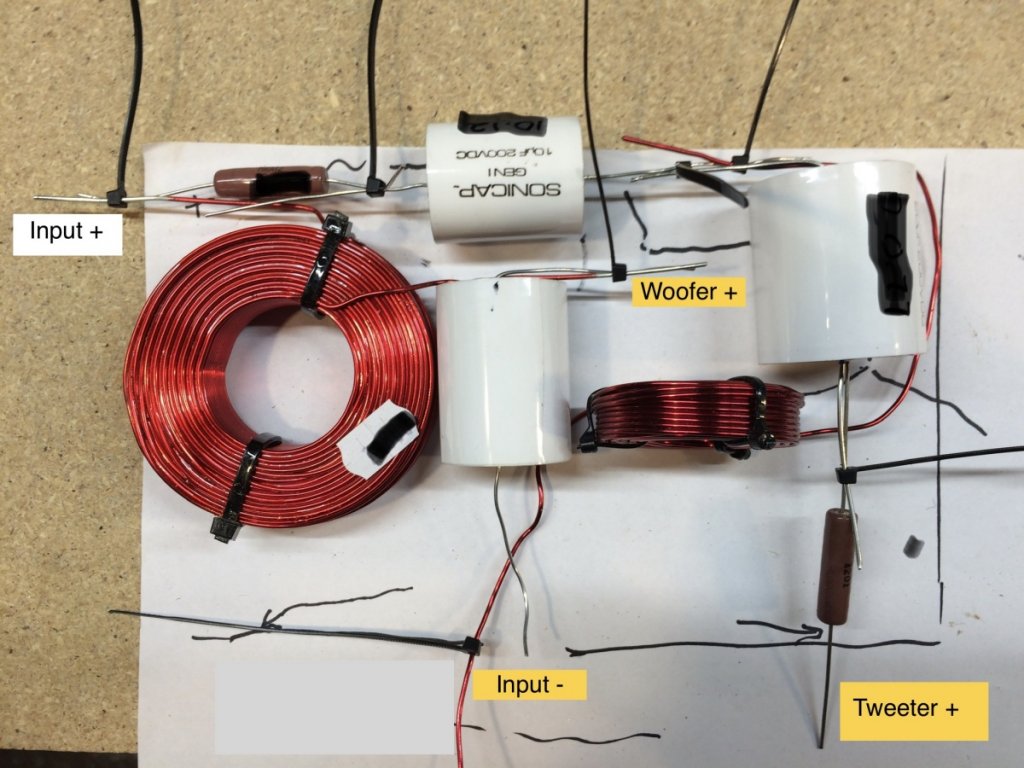

With that said, I have laid out the crossover for these speakers.
The black lines in the lower right of the picture, on the paper, are the boundaries of the board that will will fit into the cabinet.  For info, I fed the wires through the slot of small zip ties to hold a pair of wires together without have to resort to bending the wires.  This allow me to move things around easily while I figured out where to place everything.  Copper work hardens with bending and I didn’t want to risk breaking a wire with repeated bending.  And, yes, the one coil needs to be angled more towards the center of the other coil.  I emailed a copy of this picture to Danny and he very quickly responded that it was OK.  Thanks...

I probably should have posted this picture before the one above with the crossover laid out...
The unboxing of the components...  :dance:
A dilemma I have is what to do with the spikes.  My current plan is to have a separate board attached to the bottom that is wider than the bottom to give the speaker some stability.  Then comes the question of how best to attach that board to the bottom.  I could glue it.  Or I could put in tee nuts into the bottom of the cabinet.  I am leaning towards the tee nuts.
While I am pondering that question, I am off assembling the crossovers.  With the way this speaker is, I will need to to the internal assembly with the front removed.  That means the No-Rez, crossover and wiring will need to be installed.  Then the front will be glued on, followed by installing the drivers.

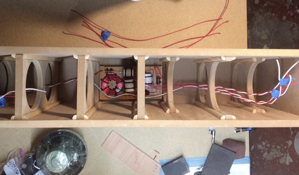

The crossovers are done on pieces of 3/16” plywood that fit the space indicated on Danny’s sketches and I used as much available space possible to make the component layout the easiest.  I added a couple of raised pads for the resistors, just to make the assembly easier and to make their wires readily available.  The holes for the tie downs are all made and each piece received a coat of shellac (amber, because that is what I have).  The wood pieces above the boards will be spacers to locate the crossovers above the No-Rez.  I would rather screw into the soft pine than the MDF and risk chipping it and these can be easily glued into the cabinet.
A mistake I just realized that I made was to not factor in the thickness of the No-Rez into available width of the cabinet for the size of the piece for the crossover.  The No-Rez is 1” thick which will bring the available width down to 5”.  While the boards I cut are 5” wide and the No-Rez is a bit compressible and everything should fit OK, I should have factored that in and I would have cut the pieces to be 4.75” wide.   :duh:

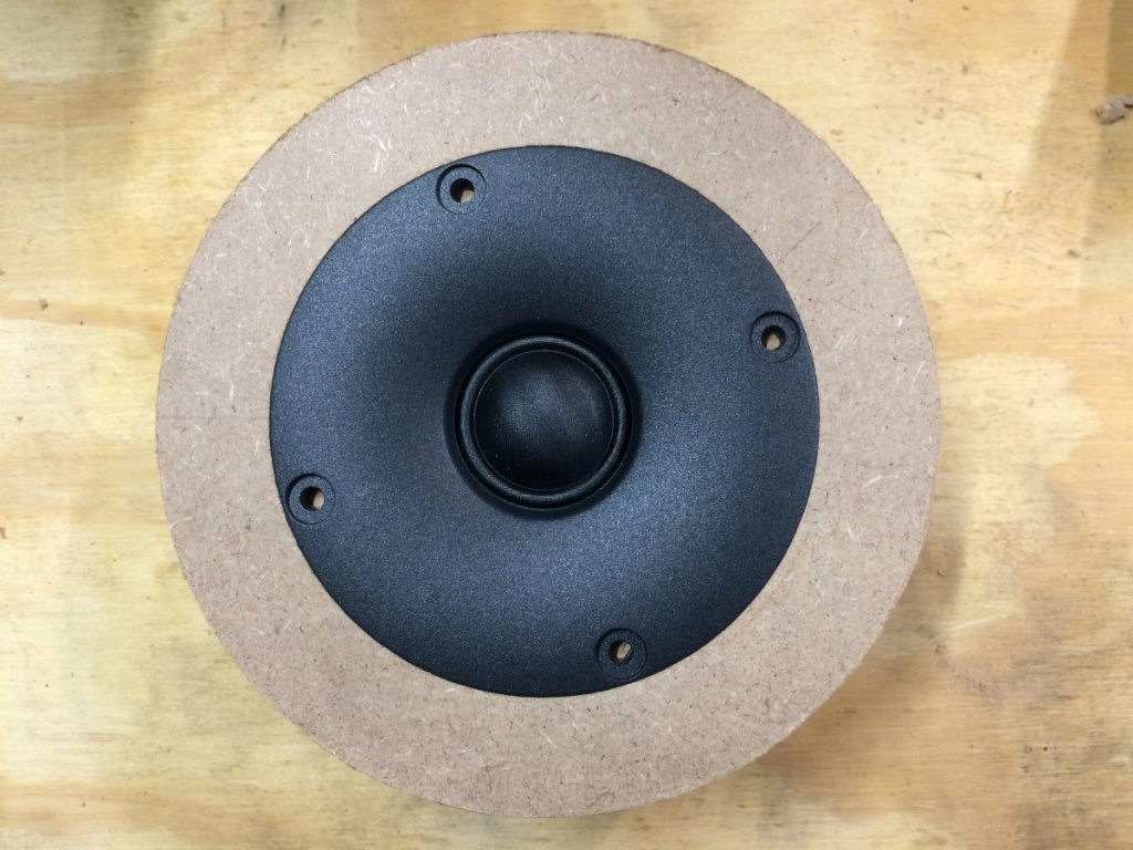

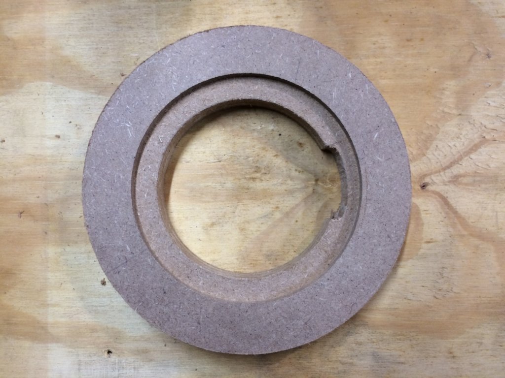

I have also done some practice with making the recess and hole for the tweeter, using some scrap MDF.
The tweeter fits in snuggly.
I have done the same for the same for the woofer drivers.  I found that the hole size recommended by the plans left the drivers slightly loose, so I made a second practice cut with a 1/6th smaller diameter.  This gave those a nice snug fit with those too.

Crossovers are done.
Twisting the wires together for soldering the way Danny shows in his video wasn’t too bad, although I which he had left that part in as it was left up to ones imagination as to how this is done.  One of the things I found that helped when twisting more than 2 wires together was to first twist together the thinnest of wires as a pair, where that is possible.  Where there was more than 2 wires at a junction in both the positive driver side direction and to the negative side, I also followed Danny’s diagram and first twisted the wires together of the components that were in a straight line between the input and the driver.  Then I twisted in the wire of the component that went to the negative.
A hard part was attaching the red wires that go to the base drivers.  I decided to run 2 wires, of equal length from the crossover to the drivers.  That connection becomes large in doing this, with the coil and capacitor wires coming together as a pig tail and then weaving in the 2 driver wires.  I found I could easily twist in one driver wire at a time by following the twist of the wires already twisted in.  I could start the driver wire by twisting it in by hand, then resorted to pliers once there was enough of a bunch of wire to grasp.  Hope that makes sense.
The red wire base circuit connection, with that bundle of wires, was also the hardest to solder.  My soldering iron just want not up for the task.  So, I thought it would be good to add a little extra heat from my torch setup:
 :rotflmao:
No, I didn’t do that...
But I do have a small butane torch that was perfect for the task.  Done in no time.  I covered everything on the board with heat proof welding cloth and had the wires above the components on the board to keep heat from traveling to unwanted places.
For the negative connections I ran a single wire from the binding posts up to the tweeter.  I then stripped that wire in 2 places.  One place was close to the drivers.  I cut 2 other pieces that were of the same length as the distance to that stripped area and twisted and solder them in place.  The second stripped place was at the crossover board where the coil and capacitor shunts (? Hope I got that right) go to the negative side, and were also twisted and soldered into place.
Heat shrink tubing was fitted over each of the connections to the copper speaker wires and the red and white pairs were each twisted together.
And in the cabinet...
It turns out that Danny packs just enough wire to do the job, with a little bit of excess.  Not a lot of excess, so take care with laying it out prior to cutting the wire.  If a cutting mistake were to be made it would be easy to solder it back together, but I would guess that would be undesirable.
Also, I found I need to do a better job of labeling the wires when I cut them.  Most were obvious as to where they go, but I did need to retrace and label one after getting things done.
Patients.   This took me a while to do, between twisting the wires of the components together and doing the soldering.  I also found I need a stool to sit on for this kind of work.
I tinned all of the bare copper wires before twisting them into place.  This aided with soldering.
They are coming along...  With that I am working on the side on a finish for these; something other than paint.  I know, simple has turned into complex.  I have seen too many builds with really nice finishes to let mine go with just paint...  We shall see
