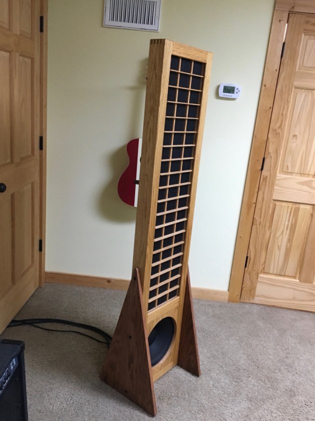

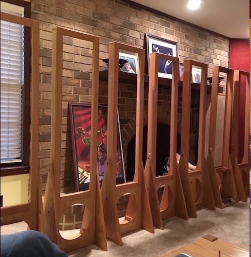

Since October of last year I've been working on my biggest-ever speaker project, and in the coming weeks I will be posting some photos, as the project nears completion.
Several of my Carver-Fest buddies have been bending my ear for years to build them some speakers, but until now I've declined because my designs are tedious and exhausting builds, I'm not young anymore (66) and I still work full time.  For better or worse; I finally agreed to do it.
I'm about 85% through building four (4) pairs of a hybrid design with a 12" woofer in an open baffle (modified H-baffle). The frames are red oak and ESL panels use symmetrically segmented wire stators supported on an oak lattice.  The video below shows a similar speaker that I built in 2018, and also shows me building one of the wire stators for the new speaker project.
More to come, but for now; enjoy the video!

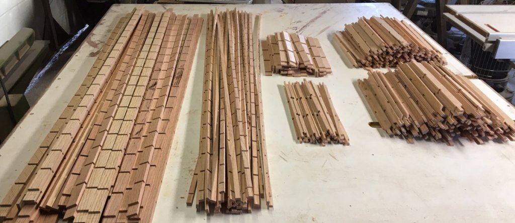

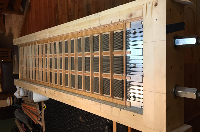

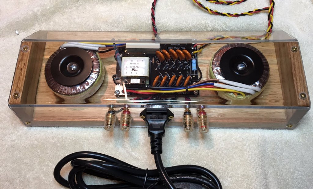

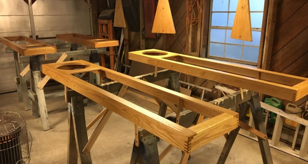

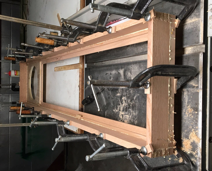

More build pics:
Below:  Lattice support details for (16) stators
Below: Speaker frame glue-up
Below: Staining & satin clear coating the frames
Below: Amplifier/panel interface (bias power supply & step up transformers)

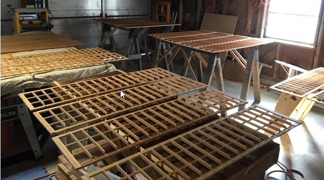

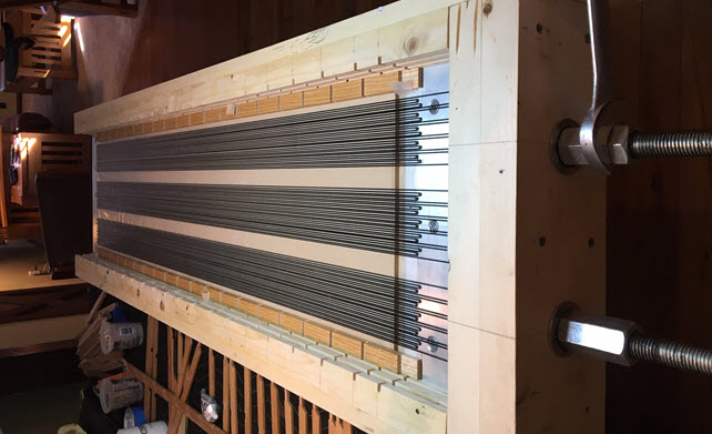

More pics:
Stator lattices temporarily assembled for spray stain & clear coat:

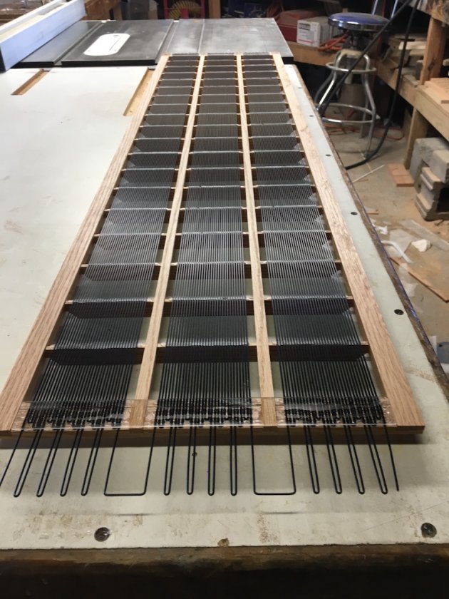

Stator wires being stretched to plastic deformation to render them straight:
Stator support lattice assembled over the wires, in the stretching jig:

One of 16 stators:

Wow. How are you bending the stator wire so precisely?
Rocket Ronny
Jazzman53
  • Posts: 774
  • Jazzman's DIY Electrostatic Loudspeaker Page
    • Jazzman's Electrostatic Loudspeaker Page
Re: Another DIY speaker project
« Reply #12 on: 24 Feb 2020, 09:10 pm »
Rocket Ronny
The bends in the wire loops result from the wires being stretched around the pins in the stretching jig.  The wires were strung up into my jig and stretched to 1% elongation to render them perfectly straight; as shown in this video: https://youtu.be/814iWnmz6_4
I'll be posting another video soon showing the remaining steps of assembling the electrostatic panels.

Here's another video; showing the diaphragms being installed and the panels assembled:
https://youtu.be/ECM3gfrJPxQ

As an intermediate woodworker of smaller projects, I'd love to know how you cut the fingerjoints on the vertical frame pieces. I've only ever seen fingerjoint or dovetail cuts done when the workpiece is vertical, either business end up (via hand saw or router jig) or down (via router table or table saw), but those pieces appear way too long for those methods.
Jazzman53
  • Posts: 774
« Reply #17 on: 4 Mar 2020, 01:27 pm »
I cut those finger joints on my table saw, with the frame rails upright, using a simple jig cobbled together from scrap wood.  But I did have to relocate the saw so that the frame rails would clear the ceiling rafters in my garage.  This project (eight speakers) has been a huge amount of labor.
