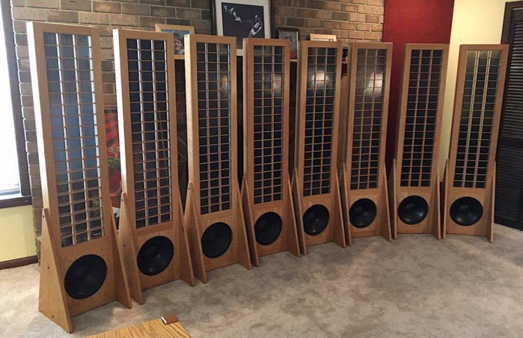

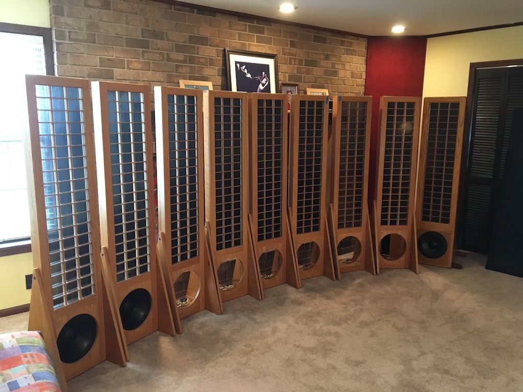

Update Saturday March 14, 2020:
The panels and segmentation resistor networks are installed in all eight speakers.  Today I installed Peerless SLS 12 woofers in one pair and they're playing tonight.  I delayed ordering woofers for the remaining speakers until I've had a chance to audition these.  My first impression is the SLS 12's will be fine.
I still have to build the grills but it feels good to be wrapping this project up after 5 months of toil.
The photo and video below were made today.. enjoy!

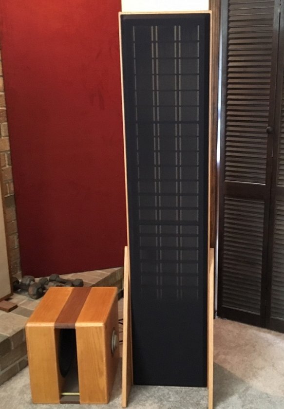

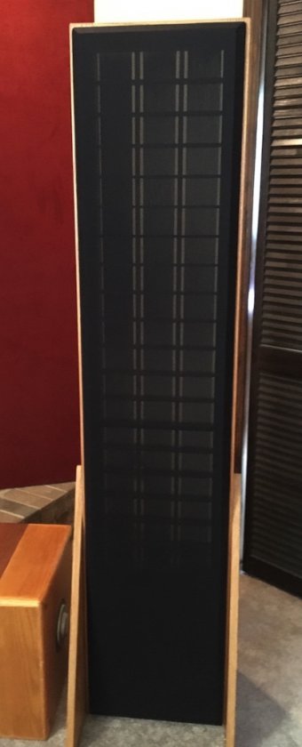

Update 3/23/20:
All four pairs of speakers are fully completed except for the magnetically attached grills, which I started building today.
I spent the weekend sound testing every pair, and they all play to ridiculous volume with no apparent issues. For a $77 woofer; I'm pretty impressed with the Peerless SLS-- I was concerned it wouldn't be up to the task so I only ordered one pair initially. I should point out that so far I've only sound tested them chopped off at 60Hz and crossing into a pair of Ripol subs with a 24db filter slope. Thus unloaded on the bottom end; the Peerless woofers rock pretty well without bottoming out at X-max.
Parts Express had the black grill cloth but not the burgundy I want for my pair-- so I was happy to finally locate some 66" x 36" sections on Ebay. That order arrived today and it's only 54" x 36".  With the Corona virus lurking and me old as dirt, I'd rather lose the refund than risk the post office to return a package.
Just one more delay in wrapping this project up...
In the meantime-- here's some more porn for all you planar pervs:

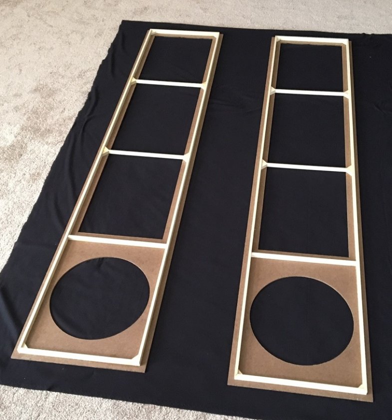

Update 3/26/20:
Having a lot of problems with the grill frames.  They looked great the day I built them but they bowed after a couple of days and I'm having to redo them.  The first time I used white pine stiffeners on the hardboard frames, the second time I used poplar.  Both bowed but the poplar bowed a bit less.  So I'm cutting the stiffeners off and bonding new stiffeners on with the frames purposely bowed in the opposite direction, hoping they will bow back to near straight condition.  I may end up giving them a week or so to stabilize, then cross cutting slots in the vertical stiffeners to relived the bow, and then gluing on some strips to re-stabilize.  They will look nice if I can resolve the bowing issue:
