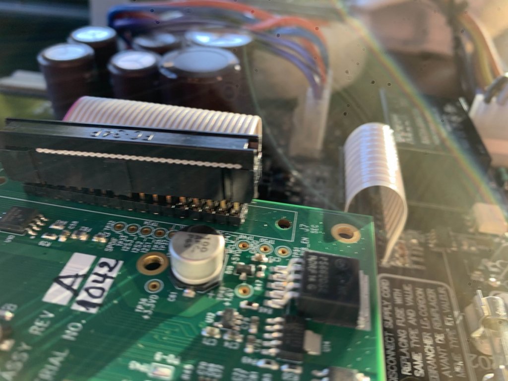

Finally had an afternoon off work so I took the BDA-3 out of the rack and was going to take the top off until I saw that the screws are Torx.  LOL!  I'll have to take a trip into town and see if I can find a set of Torx screwdrivers.
While I'm waiting, I was hoping you could take a look at the attached photo of the back panel.  I'm probably just making stuff up now but the USB port looks like it's missing a plastic cap?  I looked at the manual and it shows both without the black plastic center cap but I haven't seen a USB port without out the cap.  What do I know!

How cool is it that the VP of the company answers your question, on a weekend no less, and then says... Go ahead and open up your new BDA-3 and see what you can see... "Opening it will not void the warranty and just see if a cable has come loose".  Common sense and stellar customer service.
I was a fan of Bryston when I first heard my "new to me" Bryston 9B ST and then a bigger fan after hearing my BDA-3.  After this, I'm a Bryston fan and more importantly a Bryston customer for life.
Can't thank you enough James.  As seen in the attached photo, the ribbon cable on the HDMI card was not seated properly.  HDMI is working like a charm now.
Kind Regards,
Chris Peabody
Hampton, NB
Ps... Any opinions on the USB port pictures.  Cap missing?
