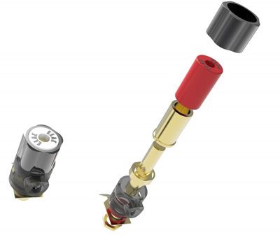

[German] https://www.lowbeats.de/test-elac-uni-fi-bs-u5-koax-fuer-700-euro/
to English: https://translate.google.com/translate?hl=&sl=de&tl=en&u=https%3A%2F%2Fwww.lowbeats.de%2Ftest-elac-uni-fi-bs-u5-koax-fuer-700-euro%2F
The coax mid-high-range speaker sits in its own chamber, which is completely lined with a felt acoustic wool. The baffle, like the entire housing, is made of 18 millimeter thick MDF. Both drivers are - not so nice - only anchored in the baffle with wood screws. But you can't see that: The screws and the baskets of bass and coax are covered by a plastic cover.
[German] https://www.hifi-regler.de/shop/elac/elac_uni-fi_bs_u5-schwarz_matt-100007523-sw-mt.php
https://www.audiophonics.fr/en/binding-posts/dynavox-insulated-terminals-gold-plated-19mm-pair-p-7945.html
https://www.audiophonics.fr/en/binding-posts/jantzen-audio-gold-plated-binding-posts-25mm-pair-p-9734.html
