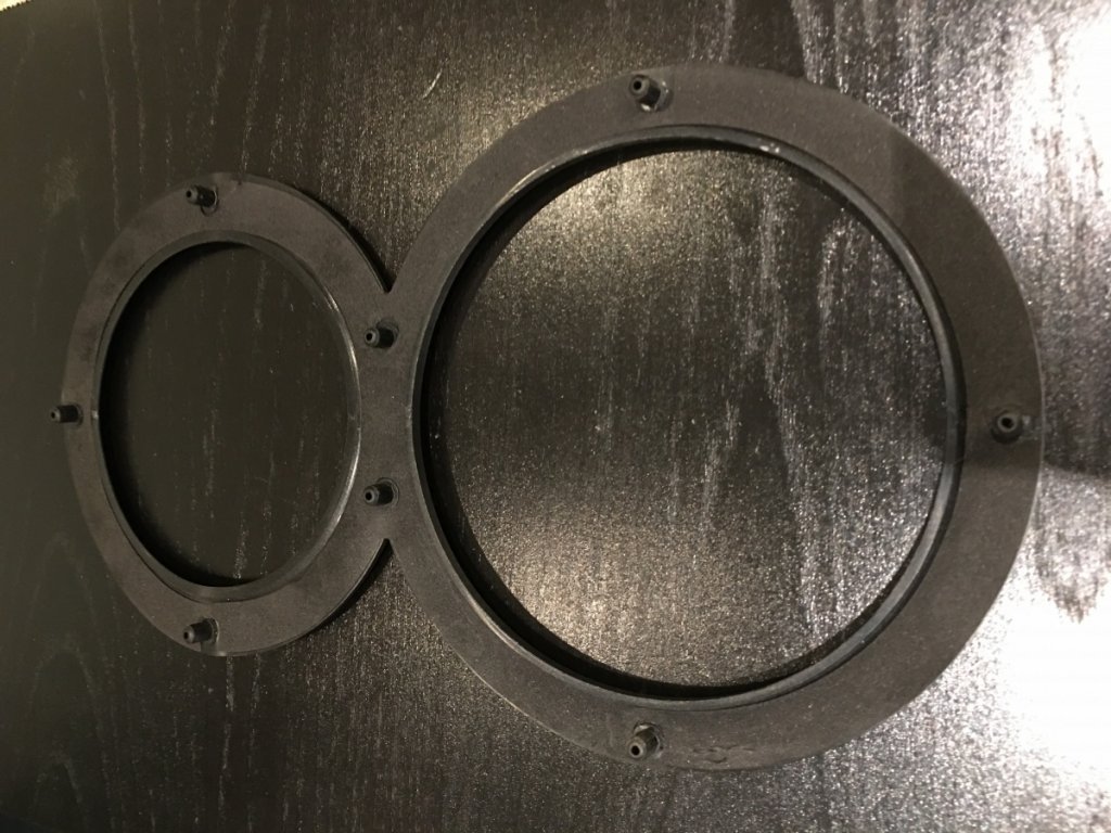

Hi all, I've decided to upgrade the crossover components in my UB5. I realize that it is not a mod-friendly speaker as I am taking it apart. Below is what I've done so far.

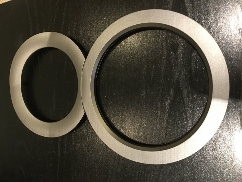

The beauty ring can be taken off the same way as Danny described in his Elac B6 upgrade post. For both of my speakers, the 10:30 position of the woofer portion of the ring is not tightly fitted and this was the position I started tearing it off. Here is the front side.
And here is the back side. Notice the extra pin in the middle comparing to that of the Elac B6.

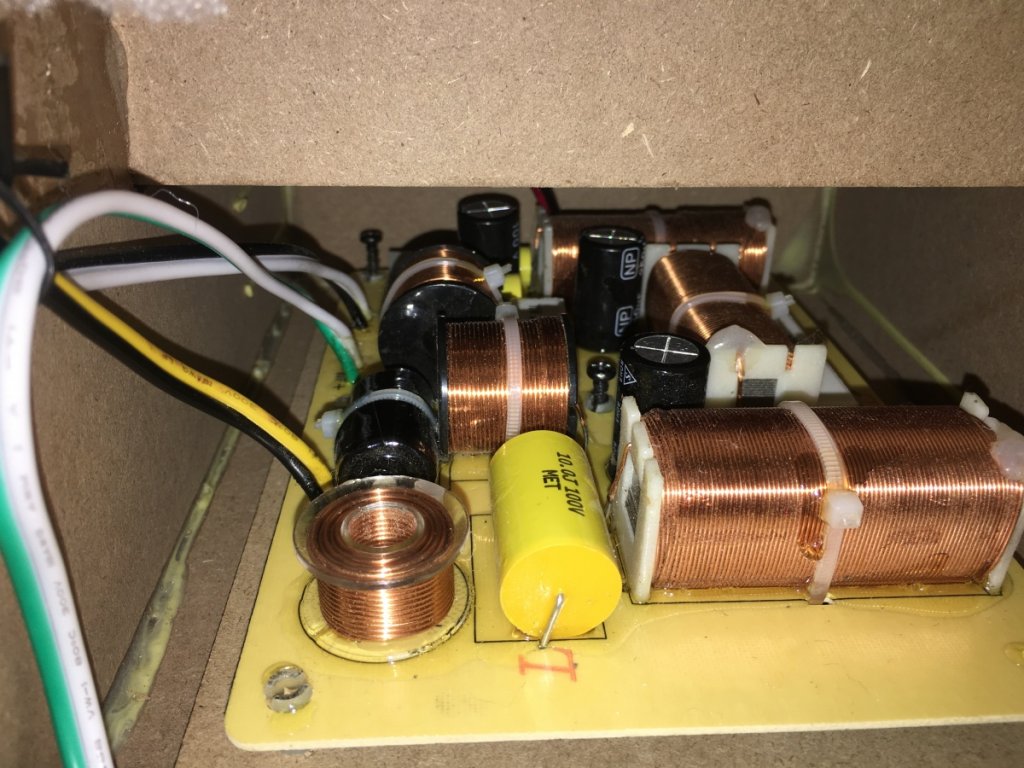

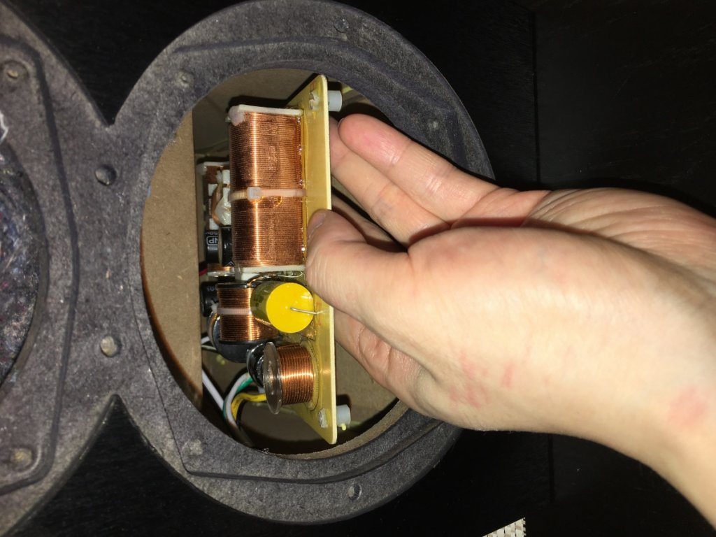

There are 7 screws holding the crossover board, 4 at each corner and 3 across the middle section. These 3 screws are located right underneath the middle structural piece. It's almost impossible to turn the screws using a regular screwdriver. I eventually used a tiny ratchet to take them out. Here is crossover with the middle screw popping up.

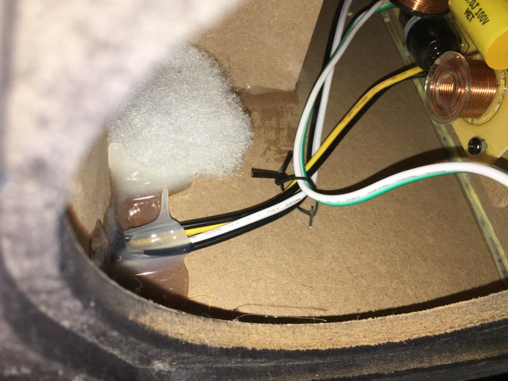

The wires to the tweeter/mid go through a hole filled with hot glue. The alcohol trick did not work well for me when removing the hot glue. I managed to rip it apart enough to slide the wires through.
The crossover board is approximately 1/8" wider than the woofer cutout. I will need to cut a notch to let it pass through.

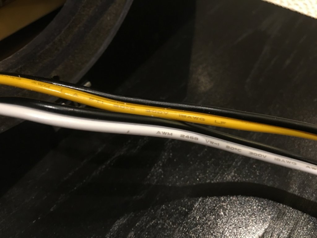

The internal wires are 18AWG and are labeled "AWM 2468 VW-1".

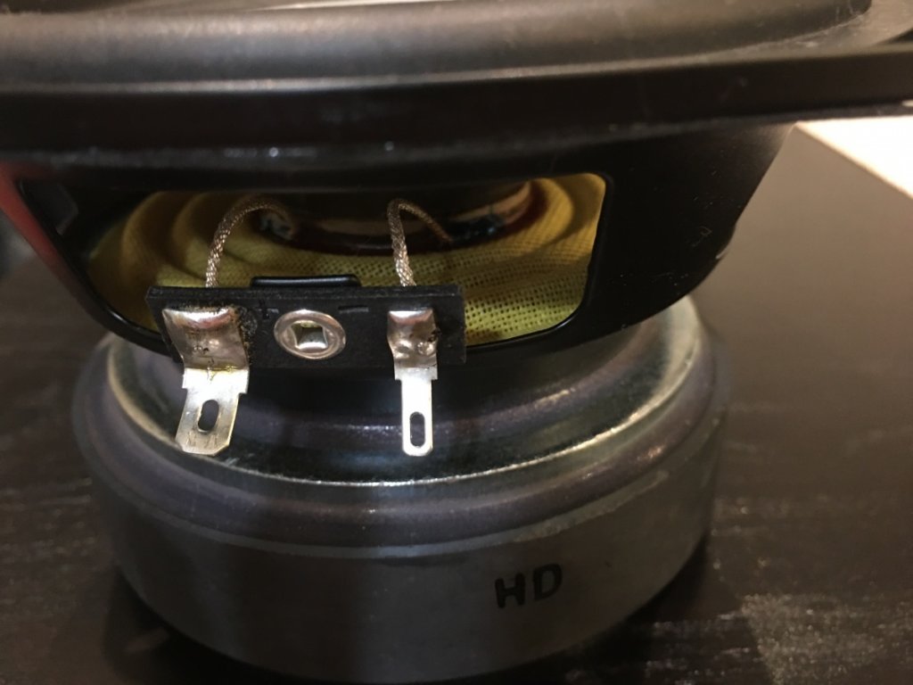

I ain't sure if this is upgradable but the drivers' internal wires are also 18AWG (visually about 1mm in diameter).

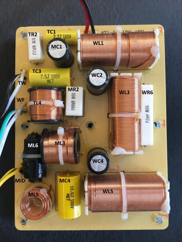

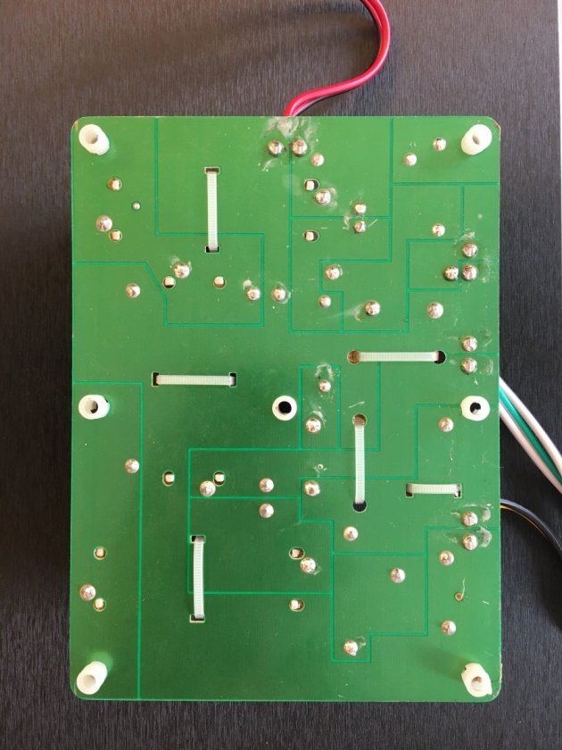

I have managed to take the crossover board out of the cabinet. Every component is glued to the board. I did some measurements using my cheap DMM with the components still attached on the board.
Here is the front side (the labelled values are in blue and the measured values are in black).
Here is the back side.
And the corresponding schematic (courtesy of Digikey for the schematic tool).
I am hoping to send the crossover board to Danny for a more accurate measurement and his upgrade recommendation. Thanks in advance!

You may have to lift one leg of the inductors from the board to get an accurate measurement on them.

The component values in the schematic above have been updated with more accurate measurements.
