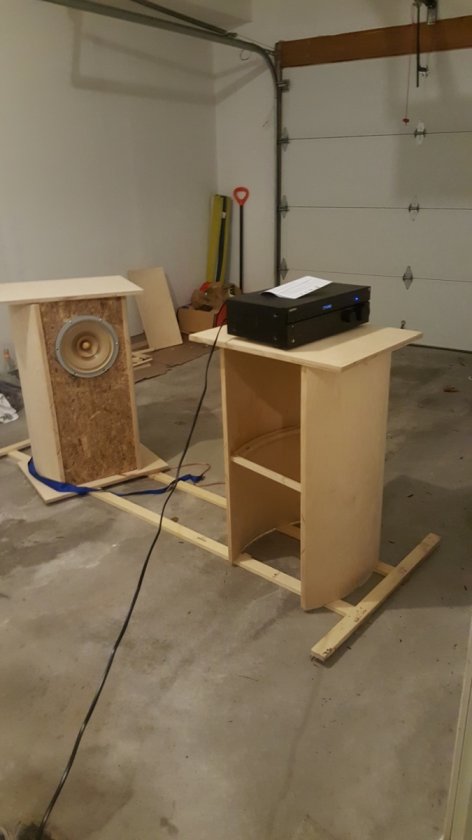

Glad to see folks enjoy their Lii Audio speakers. I bought the Fast 10 about a month ago and am currently building a box with curved sides. Dimensions are 33" tall, 14" wide and 17" in length. These drivers sound amazingly nice.... better than the B&W 800D's. Right now they are lacking a little bit in bass but I believe that's because I have been playing them in incomplete enclosures(breaking them in for now).
Last week I listened to James Brown's duet with Pavarotti, "It's a man's world" and man it made me smile. I also played Hubert Sumlin's "Sometimes I think Im right" and..... well it's just beautiful. Right now Im running them with a cheap receiver that I purchased from best buy. Once I'm done building the box, then comes the DAC, and a tube amp.

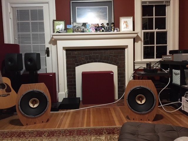

My Caintuck Lii15s are approaching 50 hours so long ways to go.  Actually first 30 hours wasn't sure - anything that wasn't well recorded sounded awful.  Just today they are starting to open up to get instrument and voice separation and a bit more bass.  My hope is that they will come close to my Spatial M3s only more functional in a small room.  Photo attached.

David, this your nice OB provide a soundstage low/near the floor as pictured?

yes - good image from where photo is taken.  Listened to new Leonard Cohen last night and was tall image and in the room - these drivers do bass really well as they open up.
Weird part is I sit at a desk to right of speakers / listening chair fair bit (am right now).  Its like sitting in private balcony seat looking down at stage below me from this seat - so very different image and not something I have experienced before.
The floating image is big part of the success of the Caintucks as apparenty they use the floor in front to help with image.
