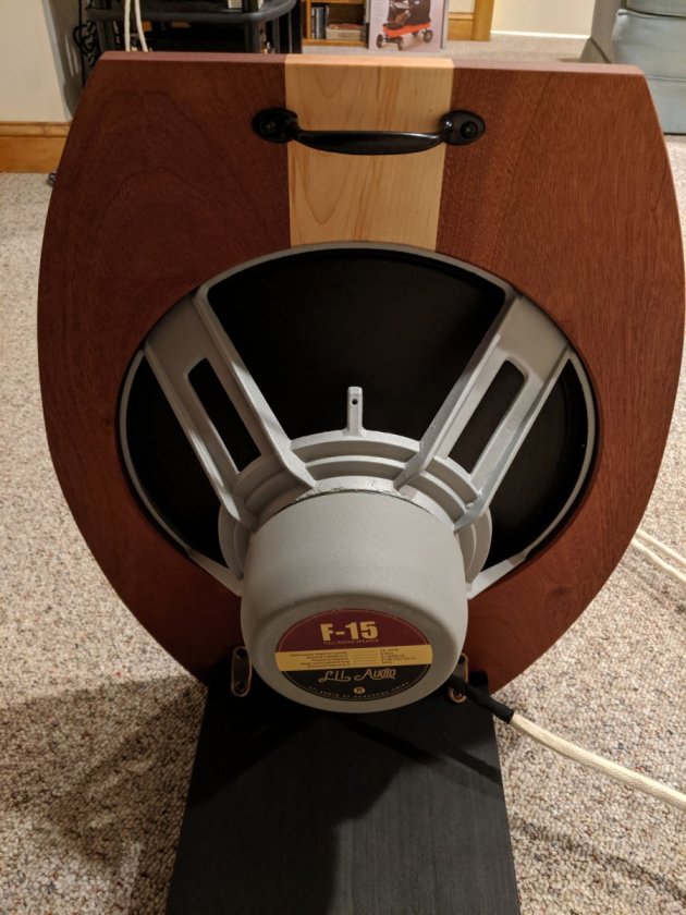

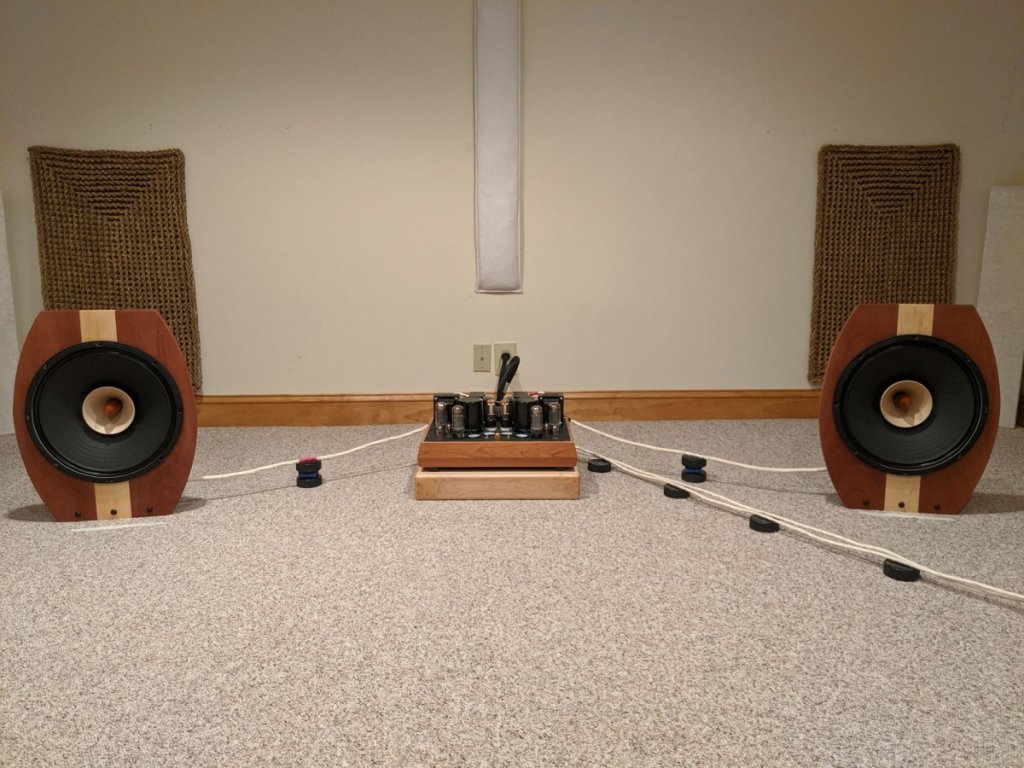

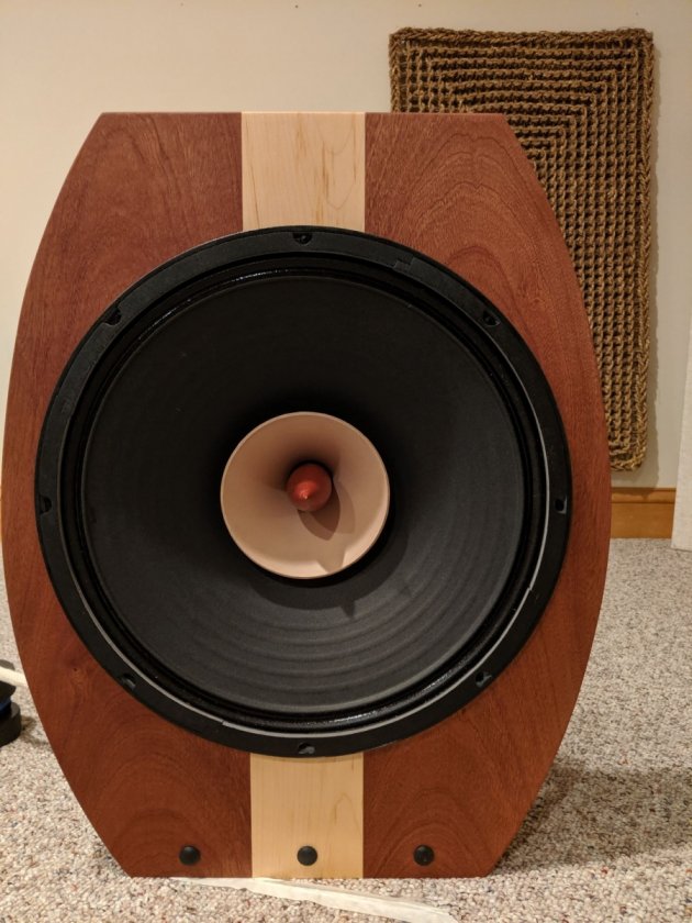

Greetings,
I attended Steve Deckert's annual get together, Decfest in early October. My primary interest was hearing two new driver offerings from Lii Audio, the F-15 and Crystal 10's in open baffle designs.  Steve had two beautiful, large 2" thick hardood baffle offerings and Randy from Caintuck Audio brought a pair of his new Lii 15 OB speakers in a smaller baffle, same size as his infamous Betsy Baffles.
While both the F-15 and Crystal 10 speakers sounded great, I was really drawn to the F-15 driver baffles. After my Decfest listening session I ordered a pair of Randy's Lii F15 baffles in Sapele and Maple hardwoods.  After only 50 hours (out of 250 hours for full burn in) I can only say these are one of the most satisfying stereo equipment purchases I've ever made.
These speakers are simply amazingly musical. The throw a tremendous 3D soundstage with excellent detail and speed.  I am now sold on open baffle designs with the right drivers.  These little open baffles also don't cost an arm and leg. A nice pair of hardwood options are less than $1K delivered.
Here are a few pictures of the speakers:

A big shout out on the acoustic wall treatment.  I would never thought a door matt could be wall mounted.
Alan
nature boy
Re: Caintuck Audio The Lii 15 Speakers
« Reply #4 on: 6 Nov 2019, 06:18 pm »
Alan,
It's a very expensive, acoustically certified door mat. It's made from hemp.😄 It actually breaks up rear firing sound waves very well.

The Crystal 10's we're exceptionally clean sounding drivers. At Decfest Steve Deckert used them in combination with his ZRock 2 bass enhancer, which never got dialed in properly. The 10 sounded better to my ears in the Lii Audio designed cabinet, which was very large.
To my ears the F-15 sounded better in the OB design. Both drivers have gobs of detail and they image like nothing I've ever heard before. The F-15 just conveyed the music with more emotion and sounded more musical to my ears, as well as providing a better bass foundation. With a fast, well integrated sub, the Crystal 10 may win out but I was looking for simplicity.
Ron,
The wood is treated with linseed oil, no additional finish beyond that.
FRM,
I believe the F-15 specs indicate a frequency range of 50-20,000Hz.  Steve Deckert's measurements confirmed they start rolling off at 50Hz with listenable bass down to ~35Hz. However they seem to play lower. I listened to Bela Fleck's Cosmic Hippo and a lot of deep organ music during the last two weeks and the speakers dug very deep. I didn't find bass lacking at all.  Keep in mind that I need another 200 hours until full break in.  The bass continues to get tighter each day.
The speakers have sensitivity of 97dB at 1 meter into 8 ohms, so they can be driven very loud with any amplifier. So they are an exceptional match for low powered SET amps.

My room is similar in size 12.5' x 15.5' x 7.5". The OB's do well in a smaller room, but need some distance from the rest wall to sound best.
