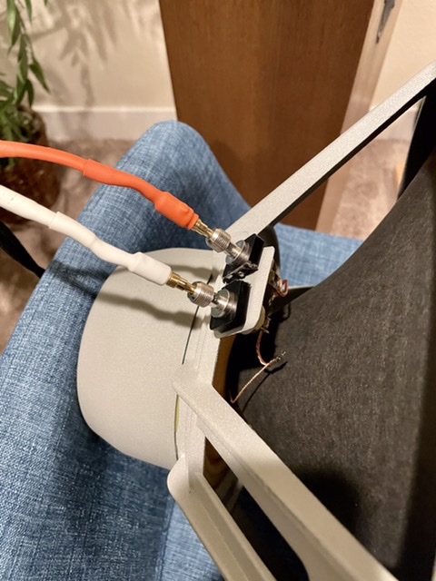

I recently replaced the stock crap binding posts with some Cardas rhodium/gold plated copper posts. Was a PITA to do and I had to extend the voice coil wires but competed a couple hours ago and already sounding much better. Hers a shot without the screw down part (for spades)
