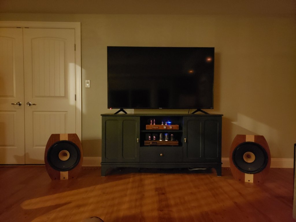

Here is a photo of my setup. Triode Labs SET 2A3 amp with a whooping 3.5watt drives them perfectly!
