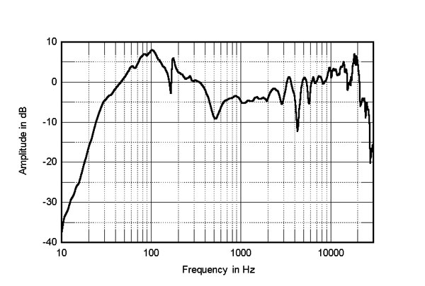

Re: What are the top speakers for low wattage systems?
« Reply #4 on: 18 Sep 2019, 10:32 pm »
Given that when people are talking about low wattage systems they are saying they want to use an SE tube amp.
Here the highish output impedance of the amplifier means a fairly flat impedance curve in the loudspeaker, or a FR and impedance that work to stretch the extention at both ends.
Efficiency itself is not as important as some may think, but flat impedance is important (and a bass alignment that takes the high output impeance into consideration).
So the question becomes: What is your low wattage amplifier?
« Reply #5 on: 18 Sep 2019, 10:39 pm »
Volti Rivals
Ugly impedance curve:
Ugly FR:
But it looks like with a hign output impedance the big bump in the impedance at XO is compensated by a big shallow in the FR (as measured with a low output impednce amp). But it probably won’t fill in the whole dip. No aid in the top, but some extension at the bottom may happen — but only if the speaker is designed for a high output impedance amplifier.
