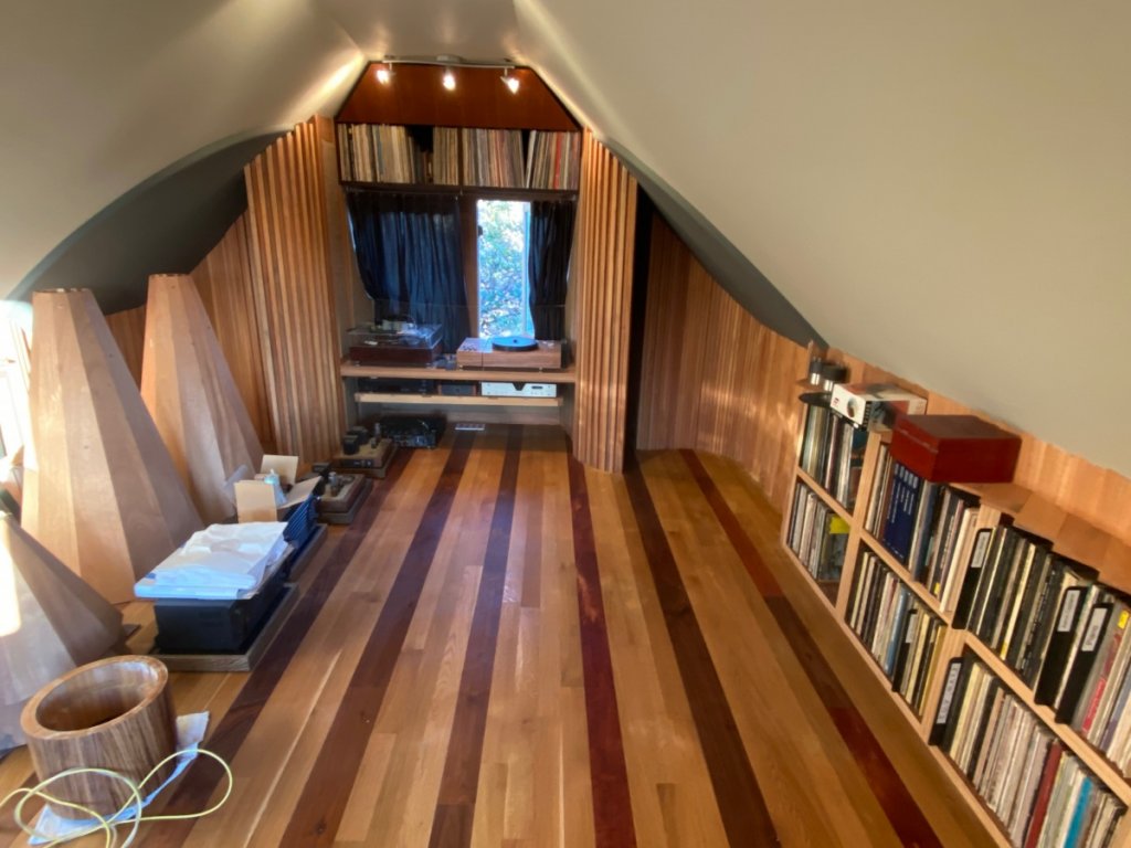

My old Welbourne Laurels produced ~8W stock. Cy Brenneman added a fixed bias and some other little mods and he tells me he cut the distortion in half while raising the output to 11W. I run these with Western Electric 300Bs.
They make plenty of power for my speakers which put out ~110db 1w/1m. The Cogent field coil drivers are pretty much unobtanium now though. The set up is not complete yet: custom mounting racks are in progress and there is some minor tweaking to the network still.
System overview:

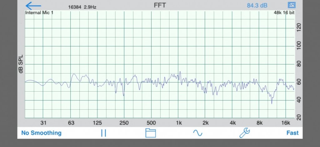

Pink noise at the listening position, no smoothing:

  I take it your room is an Attic space. Yo have me thinking about my attic for a system. What size is your space ? Beautiful work BTW, looks great.

Thanks everybody. A lot of work in that space.
It's actually a loft above my garage. It was an open rafters when we bought the house. I built the floor and then everything else.
The room footprint is ~13'w X 18'l. The pony walls down each side are ~3' high. The voids behind the record cases are stuffed with insulation and act as bass traps. The entire room is the system.
