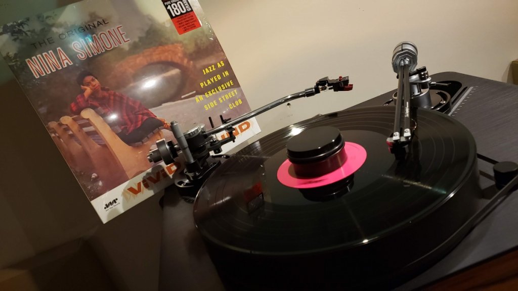

My tonearm does not have a micrometre style for VTA adjustment, but I can adjust it on the fly. My tonearm is the Dynavector DV 507MKII (you can see it in my avatar). I only use it when i am setting up a cartridge for the first time.
