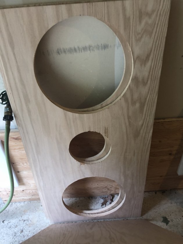

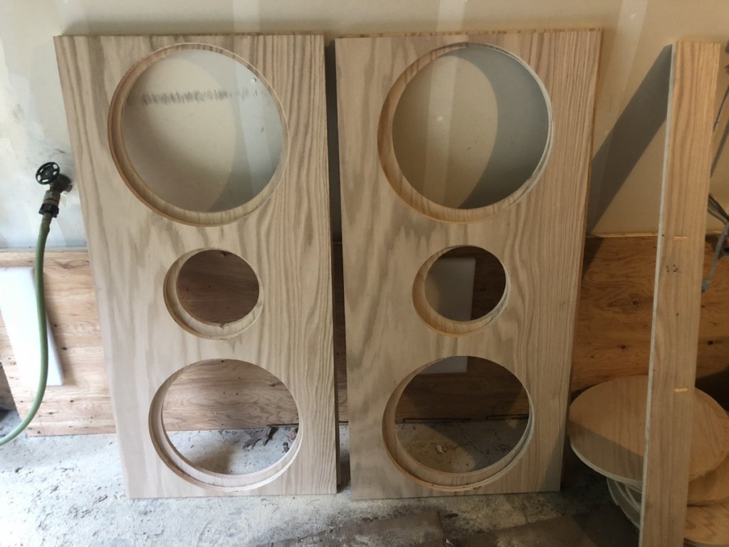

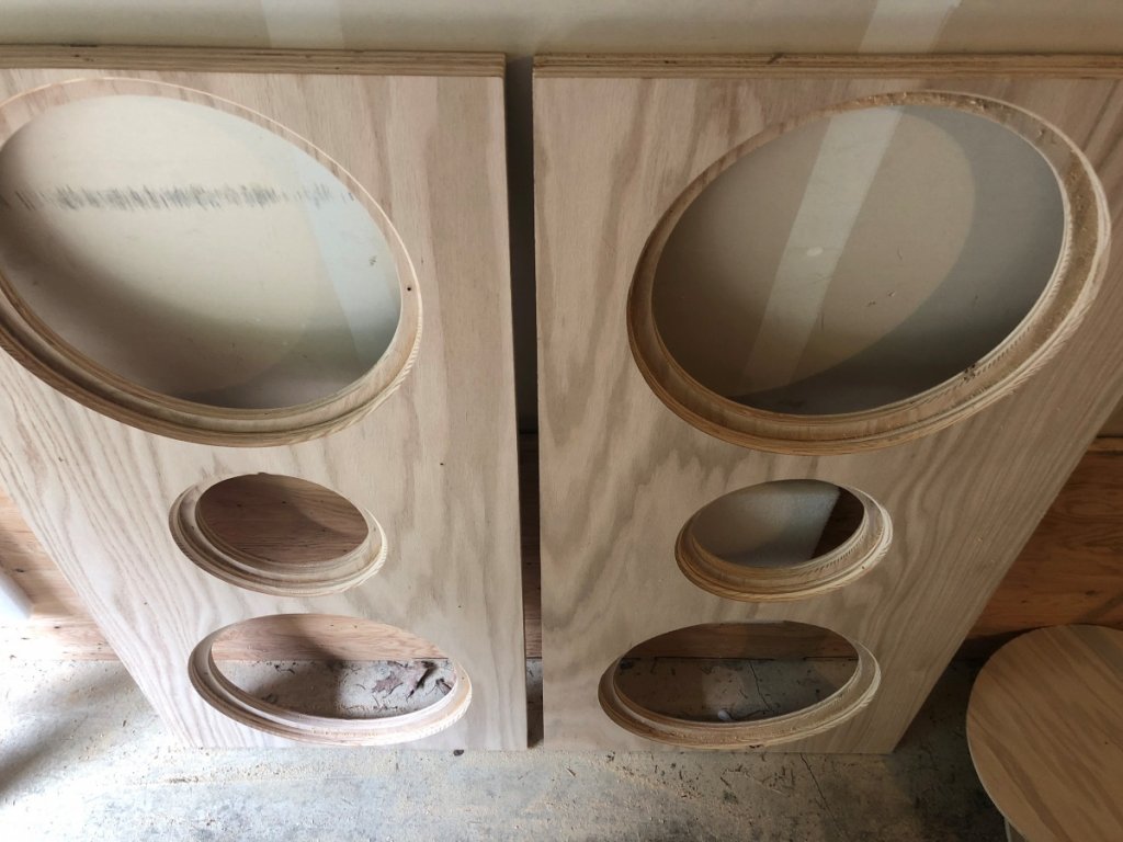

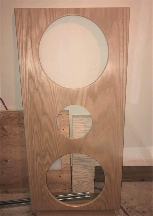

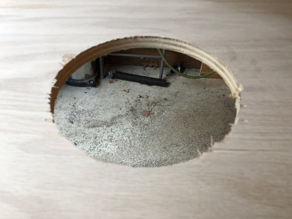

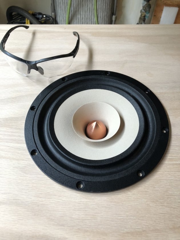

Initial practice with a router to make speaker holes in the baffles.  Borrowed tools, it's been a long time since I did any woodworking so I was moving slowly.  Material is red oak plywood from Home Depot.  Not great in terms of voids or finish ply thickness, but its what I could afford and I like the way it looks.
First routing test:
Have to see if it fits!  With the TB1808

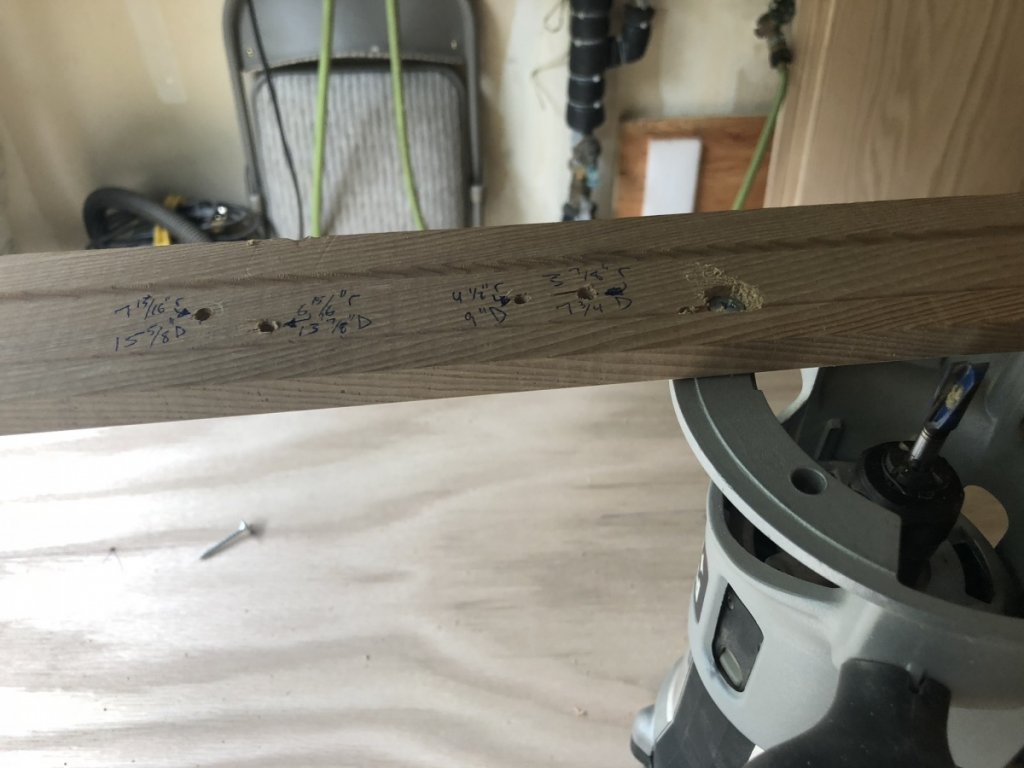

First full baffle view with my super custom router jig:
Here's a closer look at that incredibly cost-efficient router circle cutting setup:
First pair of baffle pieces standing together, not yet laminated:

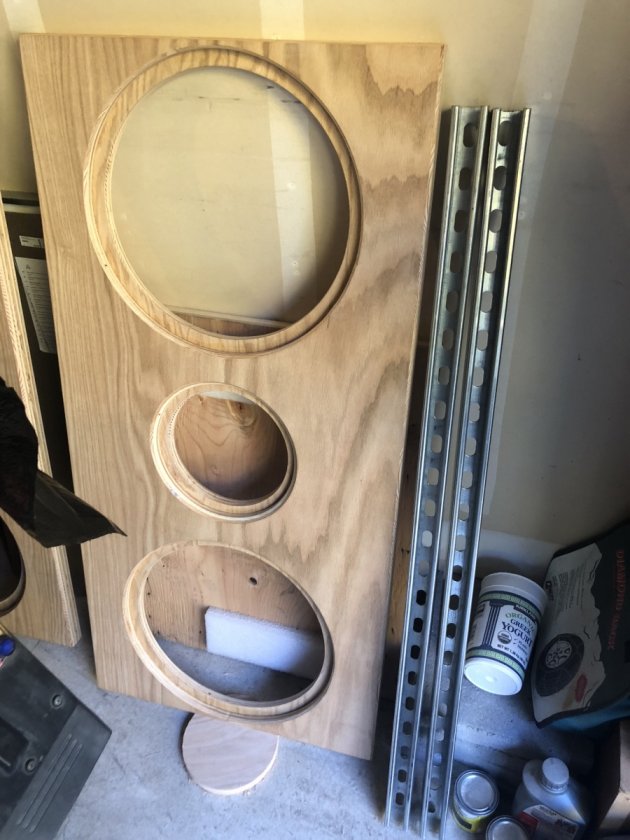

Raw baffle pieces side by side:
All the baffle pieces are cut, standing together.

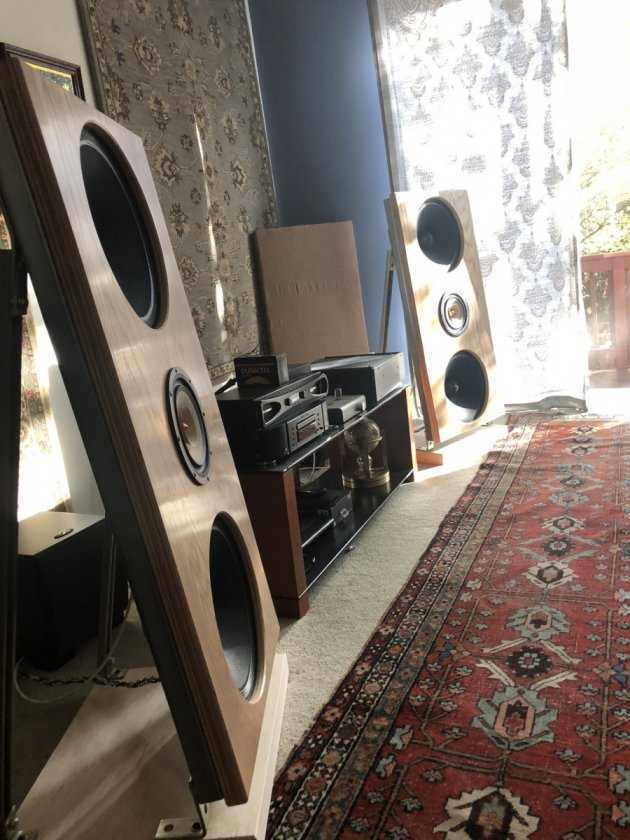

Why toe-in and close to walls?
Do you tested soundstage with no toe-in?
Oh yes.  That's an old pic, set up mostly to get a good view of both speakers at that time.  My current alignment has them about 4' off the back wall facing a completely different direction than the one shown, with a slight toe-in.  That's as far out as I can get them and still use the space effectively for the rest of life.  Frankly, I'd like a bigger room!  My poor living room has undergone multiple layout transformations over many months to test various positions, alignments.  That's part of what we do, right?   :popcorn:

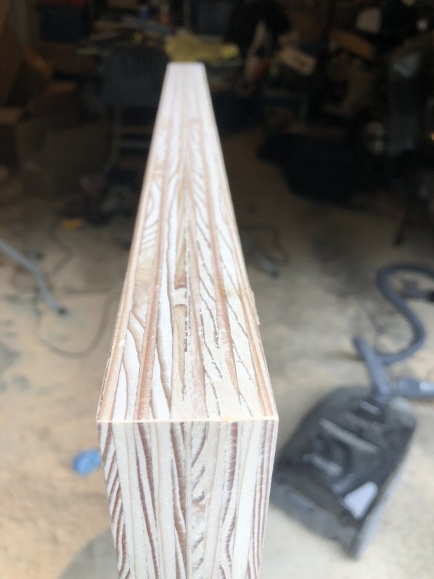

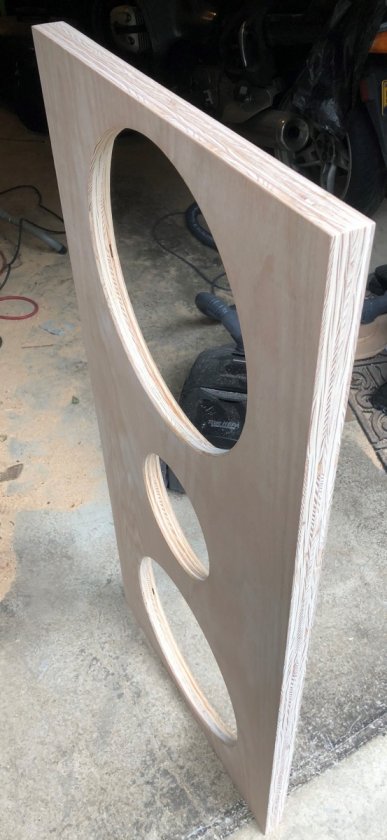

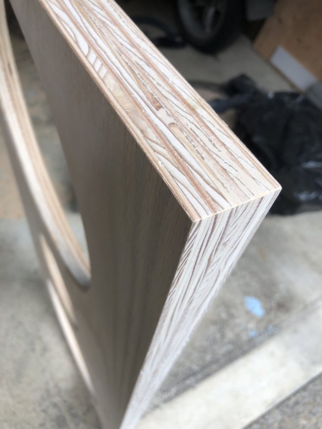

There are definitely a wide variety of plywood types and quality. I'd recommend asking a more accomplished speaker builder than I am about which is "best," but I personally considered density, strength/hardness, appearance, and cost when I chose this sheet of plywood.  Given some pricier alternatives, I would have preferred more plys and fewer voids, and more consistency at each ply.  PAP uses ply-boo among others, which is very nice looking and made from a rapidly renewable resource. I could very well have used some type of fiberboard in 1-1/2" stock, and done some kind of paint job, but finishing was already going to be a laborious process since I was working entirely by brush and hand, and paint is touchy.  Having the wood grain be the finish feature was important for this build, instead of me looking at "mostly perfect" paint in my living room, since there is no chance I would get it perfect first try!
Here's an edge shot of a baffle with both sheets of 3/4" red oak plywood laminated together, and edge filling/sanding underway.  You can see the variations in the interior ply grains.  This was a tedious process, but I really like how it came out after finishing:

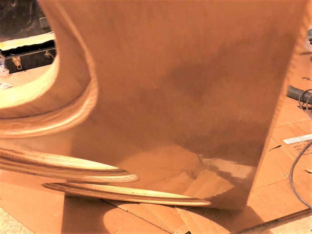

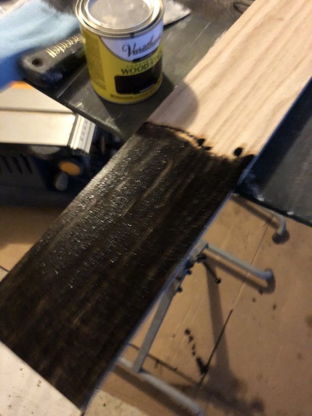

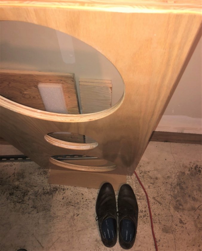

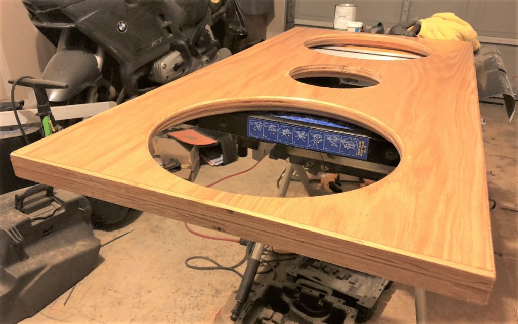

I spent the most time figuring out how to finish the baffles, probably over 50% of the work building these was on finishing.  They're still not perfect, but I learned a lot and if I ever get bored (ha!) I will work on the finish some more, adding layers of clear, then sanding and polishing.
3/4" baffle front/back pieces laminated together:

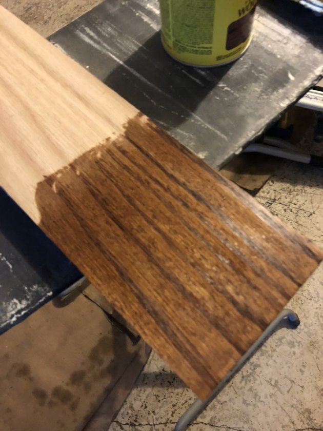

Test stains, and test clear.  I ended up using only clear finish.

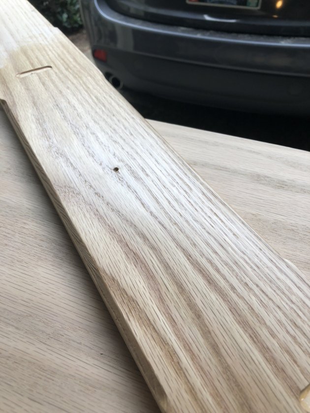

Baffle filling and sanding well underway:
First coat clear:
Three coats clear:
three coats, 45 degree edge routing detail showing need for sanding.  That was an adventure getting it right:
sanded that router detail, looking better:
Learning to sand and polish the clear:
Three coats of sanding & polishing:

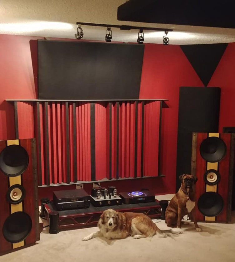

Jon if you could manage to test an upright or vertical baffle position, it certainly can increase the soundstage, you can see this position below>
