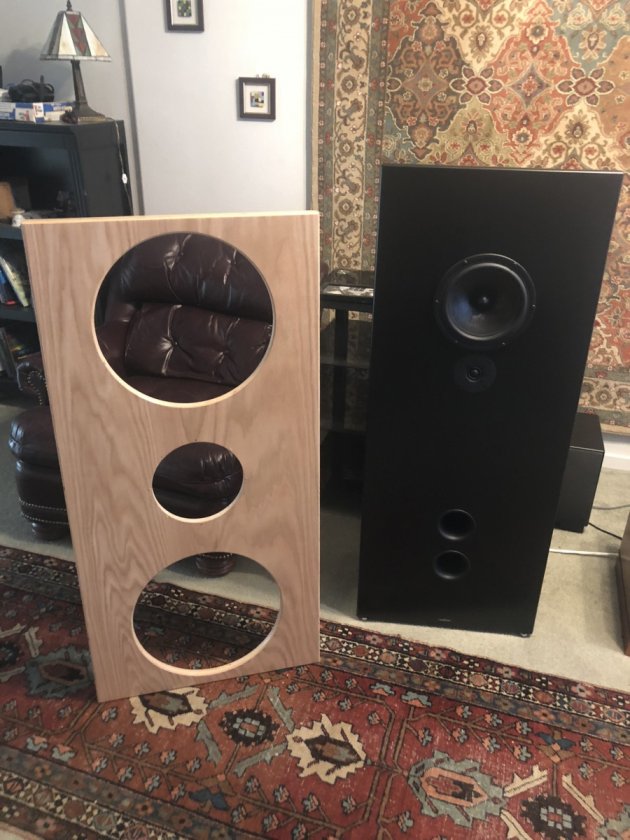

Speaker fit-up.
Baffle with legs only next to Tekton OB Sigma
Closeup of finished corner.  I think I stopped sanding and finishing at this point.
Speaker dry fit during baffle prep
Speakers in finished baffle for the first time
Loaded baffle standing on its own two legs, next to Tekton OB Sigma
Desperate to hear it, throwing some cabling together.  You know how it is...
Coming up soon, I decide I really need a base under these.... :popcorn:
