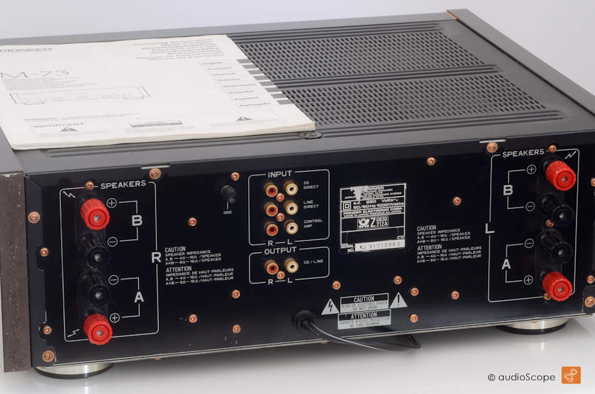

Hey guys, let me ask about again about the Pioneer M-73 solution for multi amplify the radial horns and super tweeters, because I think it was not so clear...I'm taking a closer look at an amp's picture right know, and noticed that the speakers A and B, can be selected both at the same time, so maybe is possible amplify the 2 super tweeters + 2 radial horns, just one of this, instead of 2 isn't?
  • Posts: 21482
A & B will delivery the same musical program since input is just one, you will need a xover after the amp.

Let me put a hypothetical situation about a bi-amp application with a particular amp, in a more organized way, in order to be simple for you guys explain me.
Here's the amp:
Here's the situation:
Considering a pair of 3 way loudspeakers, 12" woofer + radial horn + super horn tweeter, it's possible to amplify the 2 radial horns + 2 super horn tweeters, with just one Pioneer M-73?
I'm asking because the amp have two A Left speakers terminals + two B Right speakers terminals, and on the front, I see that is possible to select the A + B speakers selector at the same time, and also, when you see inside the amp, appears to have 4 separated channels, see the picture:
I will be in fact bi-amping?
Many thanks, best regards.

..... it's possible to amplify the 2 radial horns + 2 super horn tweeters, with just one Pioneer M-73?
I'm asking because the amp have two A Left speakers terminals + two B Right speakers terminals, and on the front, I see that is possible to select the A + B speakers selector at the same time, and also, when you see inside the amp, appears to have 4 separated channels .....
The Pioneer M-73 is a 2-channel stereo amplifier.  Many stereo amplifiers have an A/B speaker selector switch and A and B speaker outputs.
This is to facilitate choosing between two pairs of speakers or both pairs at the same time.  When you choose A+B you are connecting the speakers in parallel, which is why, for example, if the amp is capable of driving 4Ω speakers, it will say the minimum impedance for A+B is 8Ω.
FreedomJazzDance
  • Posts: 62
I think I have found the answer for my question, please let me know if I'm correct:
Consider passive crossover.
So if I choose to use 1 M-73 to amplify 4 speaker's drivers using the 4 speaker's terminals (A left horn + B left tweeter / A right horn + B right tweeter), and select A AND B speakers selectors to work at same time, i will be bi-wiring, that means: each amplifier's channel will be responsible for divide their power for 2 drivers right? this can be done only if the drivers don't go bellow 8ohms, correct?
I realized this is not a 4 channel amp, it's a 2 channel stereo amp, I was thinking it was a 4 channel amp, with 4 separated blocks, with each speaker's terminals connected to each block, just because of the inside look, (appears that are 4 separated amp blocks), but is not, it's just a stereo amp, correct?
Yes to both questions.
