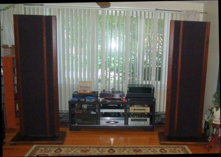

I’ve been running big tubes with my Maggies like you and have been for the last two years.  I got decent bass for certain genres of music but needed to take my system to the next level of enjoyment and pretty much just needed more bass for classic rock which I listen to about a third of the time.    I’ve taken excerpts below from something I posted on another audio form a while back.
I'm running a pair of F15HP Rythmik sealed subs with my MG3.7i's. Prior to the Rythmik's, I enjoyed a single REL Stadium III for 17 years mated with various Maggie's. According to Rythmik, 30% of all their sales are to Magnepan owners.
Moving into a larger listening room (21'x25') I felt that I needed another Stadium or needed to find a replacement. After months of trying to find a second Stadium, I considering an open baffle approach or sealed boxes, I went with the ladder. I contemplated the time and effort to construct and finish the open baffles as well as investment cost. My wood working skills are fairly adequate but what scared me was the finishing process. MDF trust me, is a challenge to get it to look right especially in a nice listening room. I consider Captain Nemo's kits but those would still need finishing.
I think what actually got me to try the finished Rythmik product was when talking to GR Research about their OB baffle product, I mentioned that I has a REL Stadium. GR made the comment to possibly keep it and run it in conjunction with the open baffles. This is something I definitely did not want to consider. I could not imagine having dual OB subs in my listening along with the REL. Just to put things in perspective, I have Rythmik's sitting behind my 3.7's just to have them out of sight. Not that they are bad looking, in fact the finished products has exceptional build quality in my opinion but let's face it, I don't believe any of us would want to look at a sub if we didn't have to.
Owning Magnepan's for better the a dozen or so years, I've always enjoyed what they brought to the party. Great soundstage, strong imaging, and spooky transparency. The one area they always lacked was a nice lower mid-base and bottom end. I've considered a pair of DWMs, tried the linage set-up, tried various speaker cables, different amps and even thought about a pair of 20.7's. I can honestly say that the Rythmik's have been the perfect complement to my MG 3.7i's.
I've found that these subs take about 150 hours to settle in. I'm not saying that don't sound decent right out of the box but they do change until they get so called broken-in. To give you an example on what I'm talking about is there are numerous tiny adjustment clicks similar to the REL for each settings and adjustments on the plate amp. Initially I had the dampening setting between "low" and "mid" for the first month or so but ended up using the "high" setting once the subs were run in. All the setting on the plate amp can be rather daunting and confusing. I will say the living with the REL for over a decade helped me understand all the settings. Once you get a full understanding on what all these controls and setting can do, it can be rather fun in getting things dialed in properly. I haven't even started playing around with the parametric EQ yet and have this process turned off.
Anyone contemplating on to go with twelves or fifteens, if your room can handle the larger boxes, go with the fifteens, they are not much more expensive. You also get a more powerful amp plate. You can always turn down the amp volume. In my room I have the gain at roughly 2'clock or at 65% output. Just my two cents here but I know the paper GR Research cone is only available in 12 inches. From where I have my subs crossed over, the paper cone would never have made a difference. I think for those mating them with a smaller two-way stand mounted speaker, the paper cone driver would make sense.
I listen primarily to jazz and classic rock. Since getting the Rythmik's it's hard to imagine how much low end energy I've been missing all these years. Even in a smaller listening room with my REL Stadium, I never got the low end impact I'm currently enjoying. Maggie's in my opinion played classic rock decently as you were able to play them loud and with music that did not rely on deep bass to sound good. Stuff like Pink Floyd, Supertramp, The Cars, and Coldplay, were not artist you played to impress your friends. They sounded good but not something my Magnepan's did well at. I can confidently say that this is not the case with the right sub. Regarding jazz recordings, the deep notes present on Ray Brown, Art Pepper, Sammy Nestico and the likes are just incredible. Those low notes were always there and discernable but the Maggie's could not reproduce those bass notes as intended by these artist in my opinion.

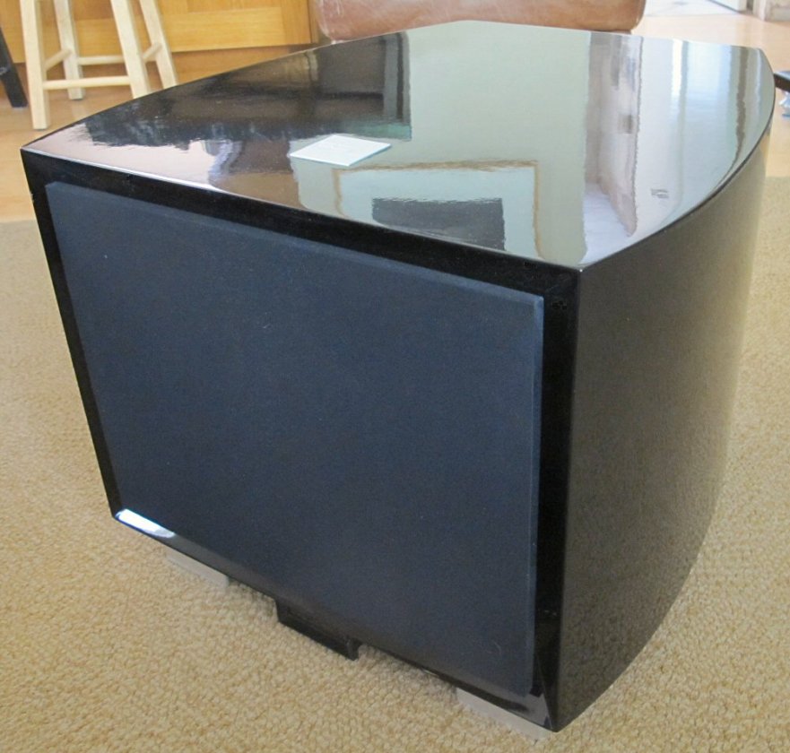

« Reply #18 on: 8 May 2019, 05:03 am »
The open baffle subs are terrific if you have the room but if you don't then the REL sub is another viable choice. I first heard a REL Gibraltar G2 in 2013 and it was paired with Maggie 3.7's, the integration was flawless and I wanted one ever since. The G2 has been discontinued and it took me 6 years to find one but it is just as excellent as I remember. The remote control makes it easy to integrate, my Salk speakers go down to 34 Hz so I have the crossover set between 27 - 30 Hz depending on the recording, the crossover and volume is adjustable in 1 dB increments as shown on the display below the cone. And the bass goes real low, -6 dB at 18 Hz. The G2's 450 watt amp has a fast rise time of 4 milliseconds so it can easily keep up with the Seas drivers and RAAL tweeters. Very highly recommended.
The big brother REL Gibraltar G1 subs are almost always available used, two of them would be killer. The G1 has a 600 watt class AB amp and goes even lower than the G2.
Here is my G2, it is a powerful, nimble beast
