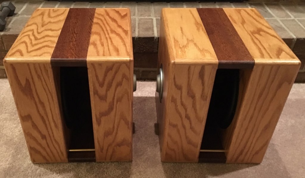

I use a pair of these with my full dipole ESL's.  I'm thinking they would work well with Maggies too.
SteveFord
  • Posts: 6530
Re: Dual Subwoofers with 3.7s
« Reply #33 on: 1 Jan 2022, 11:07 am »
I'm sure they would.
Beautiful work, too.
Forgot to add:
You can't buy Ripole subs anywhere that I know of, but I will provide my drawings and a parts list to anyone who wants them (free of charge).
