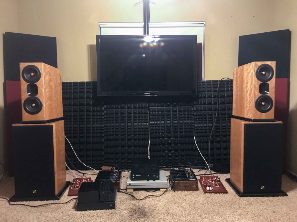

When I download and play the LEDR files, I can clearly hear the sound going up to the ceiling but it doesn't make it all the way up with music. Here is a pic of the current front wall setup:
Adding the PI Audio diffusers did a world of good for the overall sound. There is no longer any echo with the NX-Otica monitors no matter how loud I play the music, at least up to the point I can't stand it any louder.
However, the soundstage is still not fully developed. While the LEDR test files go all the way to the ceiling, with music the vertical sound stage doesn't go up more than a foot above the speakers. When listening to the thunderstorm on Brothers in Arms (SACD in an OPPO 105) the rumble of the thunder sounds like it is behind the top of the speakers with the crackling part is slightly above the speakers. However, none of it makes it to the ceiling.
Would stacking another set of diffusers on top of the ones I have make a difference? Any other ideas?
Mike

You might try moving the two diffusors panels behind the TV to on top the ones behind the top baffles as a test of your idea.
Just a thought.

mlundy- Did you ever try this? I know Early B. responded that he did not like the results when he tried it, but not sure if you gave it a shot.
Try a simple test.  Put a comforter over the TV and see if there is a difference.  That should help with front wall reflection.
I think that you might be losing a bit with the TV where it is since it goes below the height of your speakers/drivers.

Just tried the LP version of Brothers in Arms. While the thunder was placed a little higher in the soundstage than the SACD version, it was not rolling across the ceiling high. BTW, I have an 8' high flat ceiling, neither raised nor cathedral. This suggests to me it is not mainly a digital front end issue.
My analog front end is a JWM Acoustics Karen 6 TT (started life as a Rega RP6 with external speed box power supply to which Joshua did a number of upgrades, a custom plinth, and matching speed box cover), Ortophon 2M Black MM cart, and a Lounge Audio LCR MKIII phono pre.
mlundy- Did you ever try this? I know Early B. responded that he did not like the results when he tried it, but not sure if you gave it a shot.I think that you might be losing a bit with the TV where it is since it goes below the height of your speakers/drivers.
Yes, didn't help.
Mike
