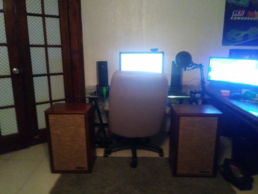

so i plugged in the teacs, and i found that one of the l-pads are broken. so im wondering if i can just get rid of it all together so i wont have to worry about it, since i have no idea how i would fix it.

Take a volt/ohm meter and measure the resistance of the working one as you turn the knob.  Replace the variable resistor with a resistor value near the middle of the readings- and with at least a 5 watt rating.  I bet that it controls the volume of the tweeter.  Want more treble? Use a smaller value. Want less, use a larger one. That should get you a usable crossover.
But it's hard to see exactly from the photo, so who knows, these changes could cause it to spontaneously ignite.
That's comforting, would you like more pictures? Also do you think it would be a good idea to completely remake the crossover with all new parts? Since this fix requires spending money I would like to make it nicer instead of just "alright"

I fail to see any in this dark images.
You fail to see what? And if you read the comments you would see that I'm going to get better pictures.
I understand all perfectly, I read english since the 1970s.
Not need take new photos, there is better images on the web.
Current audiophiles like to fix what is not broken.
Your comments dont inform electrical values, remove the pot not need any xover change, its not recommended as it will lost all the vintage value of this speaker and will remove part from the original mid-fi raw sound.
