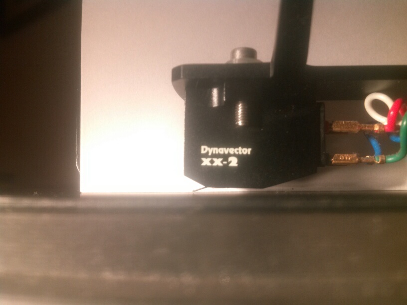

When I lower it onto the record surface the cartridge body is very close to the LP......only a tiny crack of daylight.....maybe a mm or two of clearance.  Is this normal?   Is the suspension collapsed?
(Tonearm is level to LP and VTF is 2.0g)
TIA for the help.

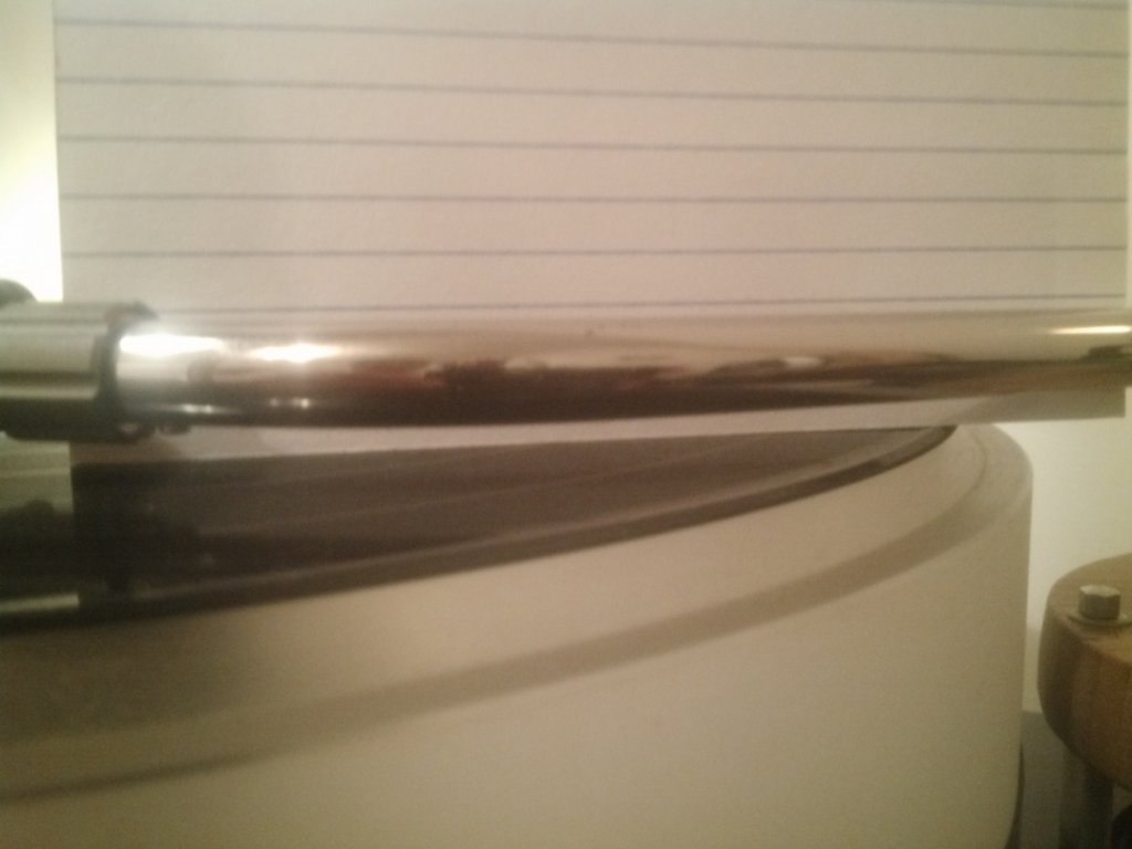

VTA:  Jelco 750E arm is parallel to record surface.
I just took cart off the arm and measured it with my calipers.  Best I can tell, diamond is about 2mm below cartridge body.   Once tracking force is applied, that distance is less.  So yeah.....definitely less than 2mm clearance when record is playing.

Best I can do.  Aimed bright light at it and placed a white index card behind to help the visual.
Couple more in my Gallery:
https://www.audiocircle.com/index.php?action=gallery;area=browse;album=28086

It is definitely riding lower than mine.  What VTF are you using?  How old is the cartridge.

From that picture it looks like the arm is set too low (rear of cartridge too low), but it could just be the angle and parallax.
Using a lined index card, arm tube is basically parallel to platter.
Looks that way to me too when I get down low to view it, despite the lined index card showing arm parallel to platter.
Just raised rear of arm a bit. Arm tube still looks parallel on the index card,  and clearance under cart now looks a bit better. At least the gap is even, front vs rear of cart body.
As a plus, it sounds better too.   Much better!   Thanks Bill.     And thanks to everyone else for taking the time to give good input.   :thumb:

VTA looks a bit off, should maybe be higher at the tonearm base, but its not terrible.
How old is the cartridge, and what environment has it been in? UV light, and airborne contaminants (sulphurs from smog, contaminants from local industry, being close to the sea, etc) will all attack the synthetic or natural rubbers that hold the cantilever in place (some cartridges also have some form of support besides the rubber). 20 years out of the case it came in could be enough, and if you're in LA, a decade might be enough.
As I understand it, replacing the suspension is less expensive than a retip. Not everyone offers it. For such a good cartridge, I think sending it out for repair or retip is certainly cost-effective and justifiable.
I have seen poorly mounted cartridges (bad VTA angle) rub the body on the LP, so yours is not the worst I've seen, but I would at least have it checked out if you can afford it (or when you can afford it) if it were me, and if you can give it a better VTAngle, do so. It should sound better as a bonus.

It should sound better after you raised it up, looking at your first picture I would say the SRA is way off. Your SRA should be about 92 degrees. Having the arm parallel to the record surface does not always give you the correct SRA depending on how the cantilever was mounted in the cartridge body.
